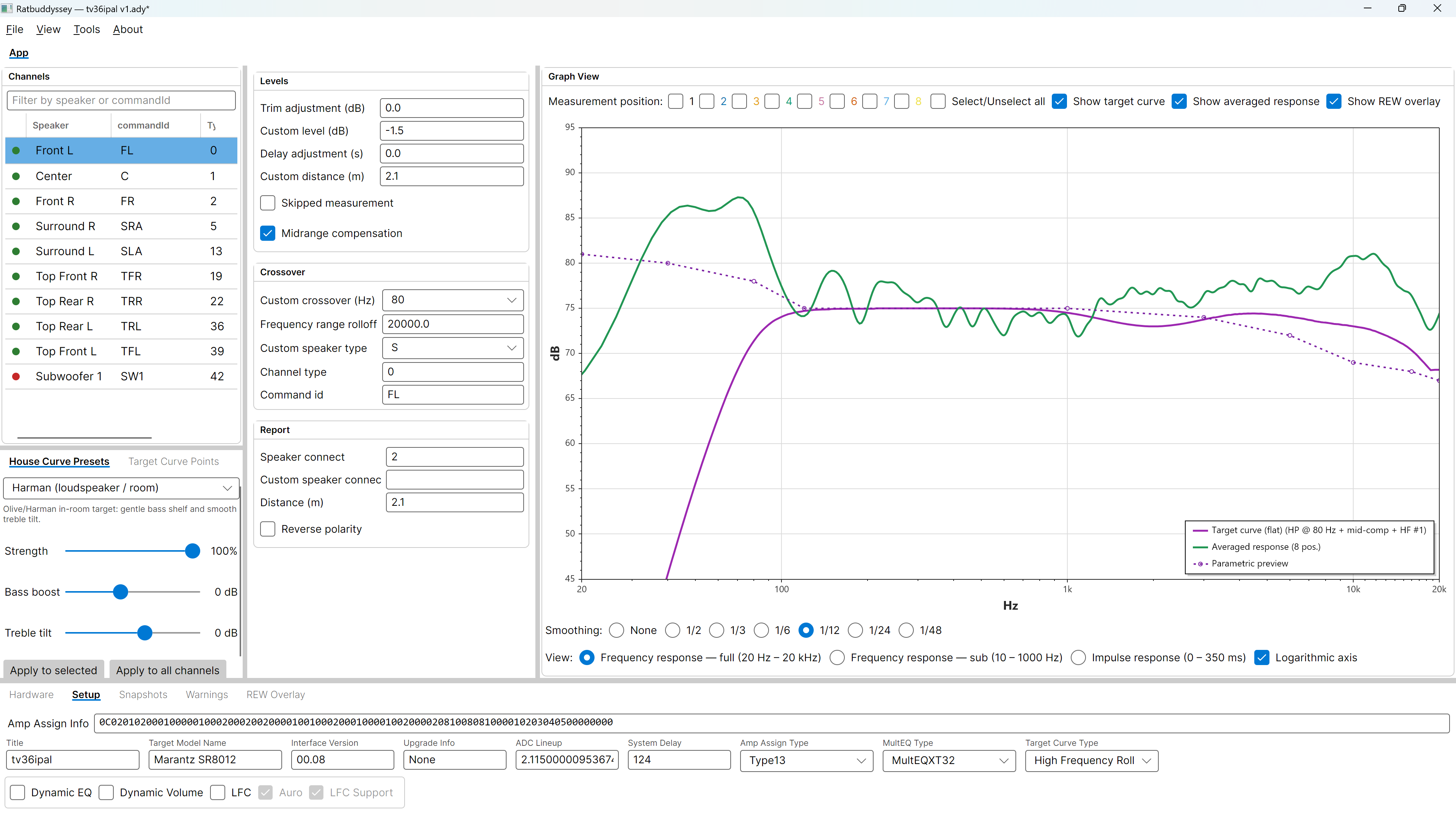

Is there anyway I can take an audyssey save file from the app that was made on a marantz sr8012 and apply it to a sr8015?
panteragstk
panteragstk
The saves are for the specific model you are using. You can try to apply the save to a different model, but it will probably give you an error.
It's best to run it again from the app anyway just to make sure everything has been measured properly.
It'd probably take more time to figure out how to get the config to the new AVR than it would to just run audyssey again.

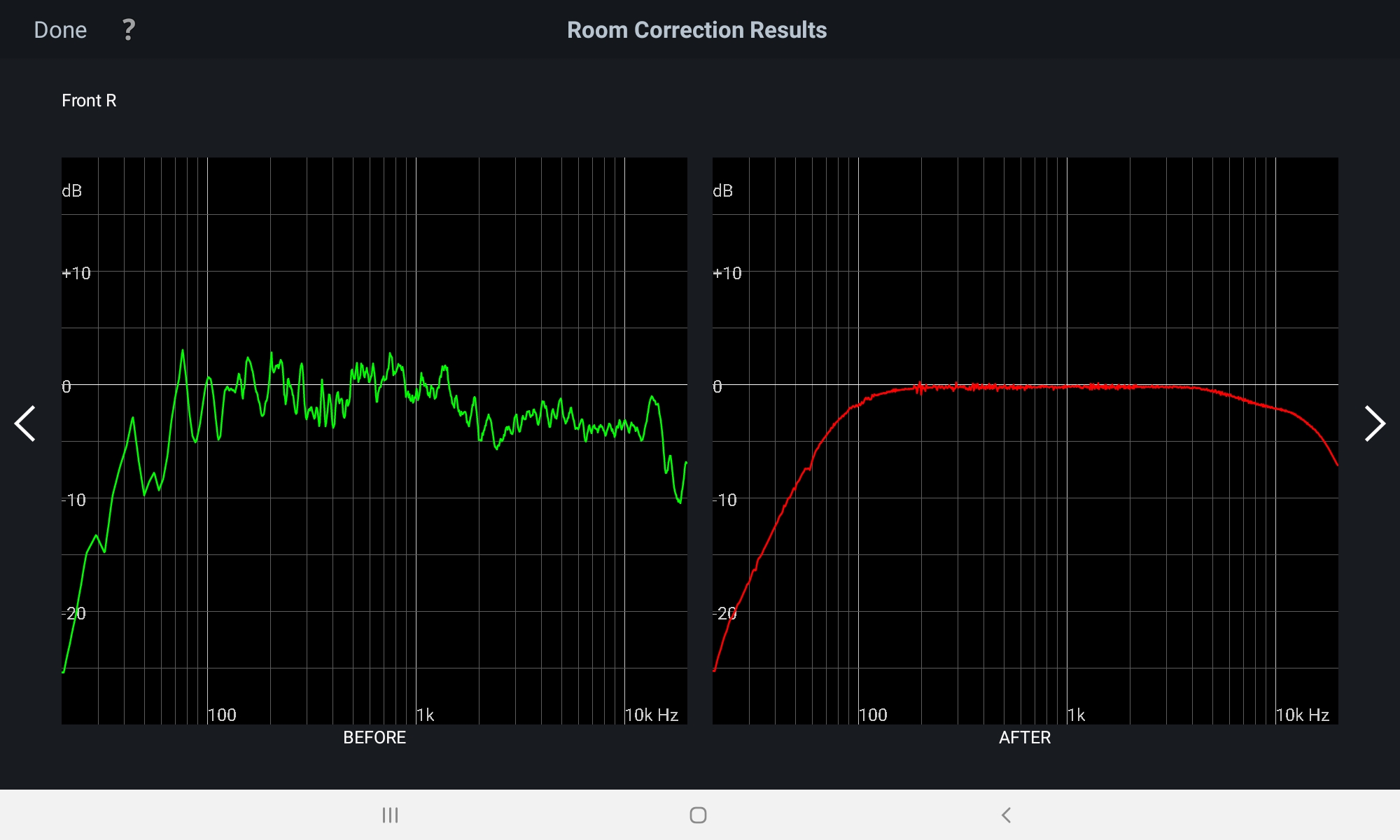

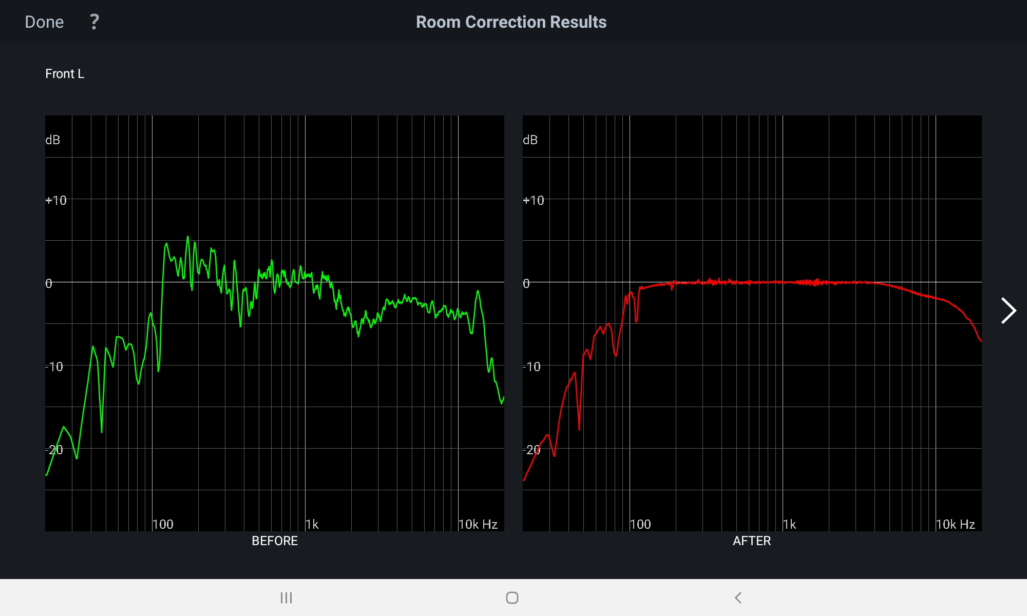

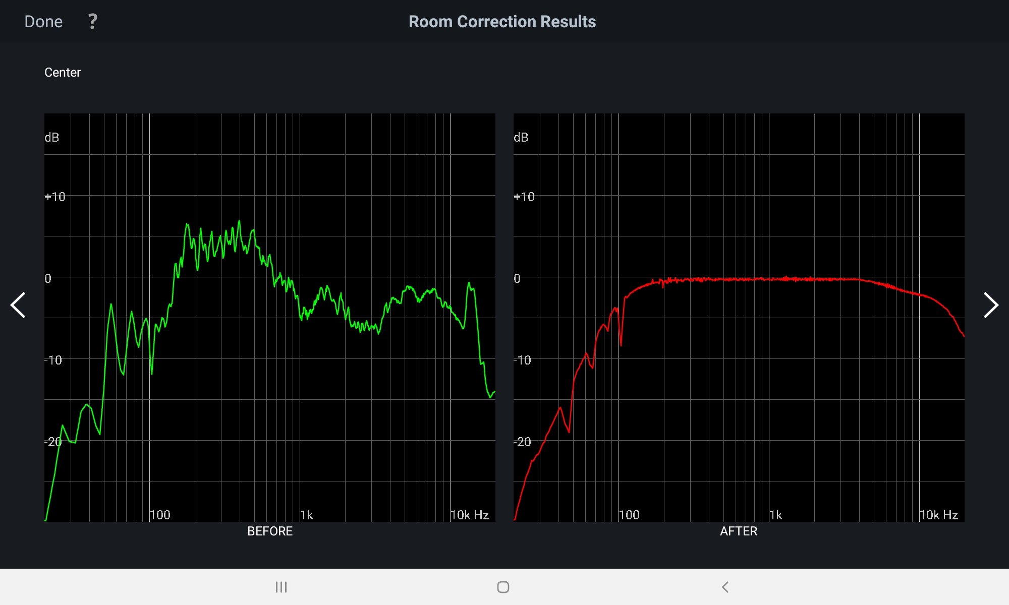

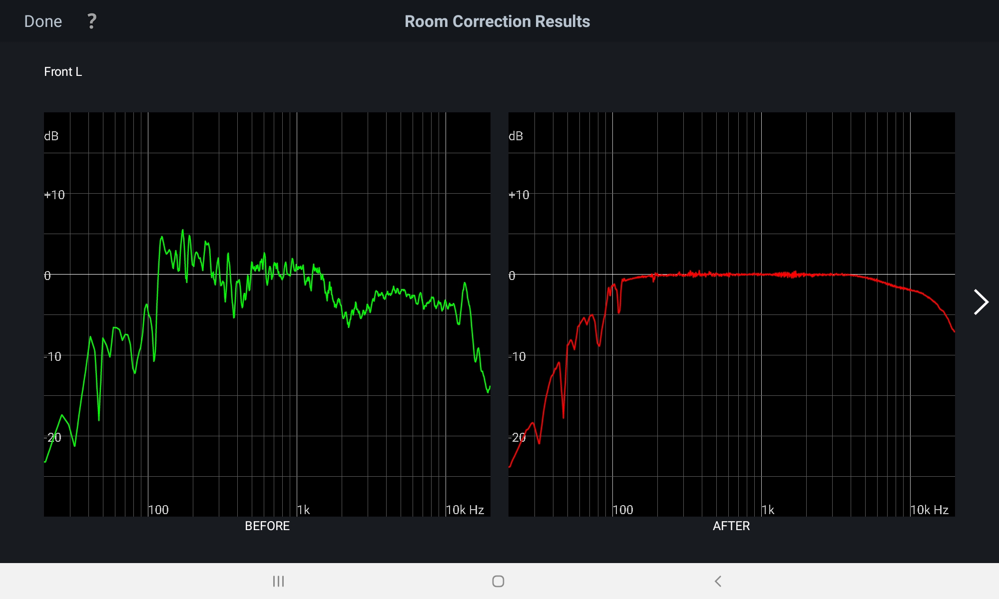

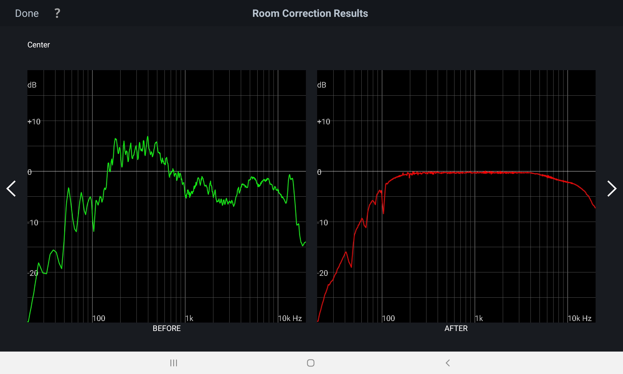

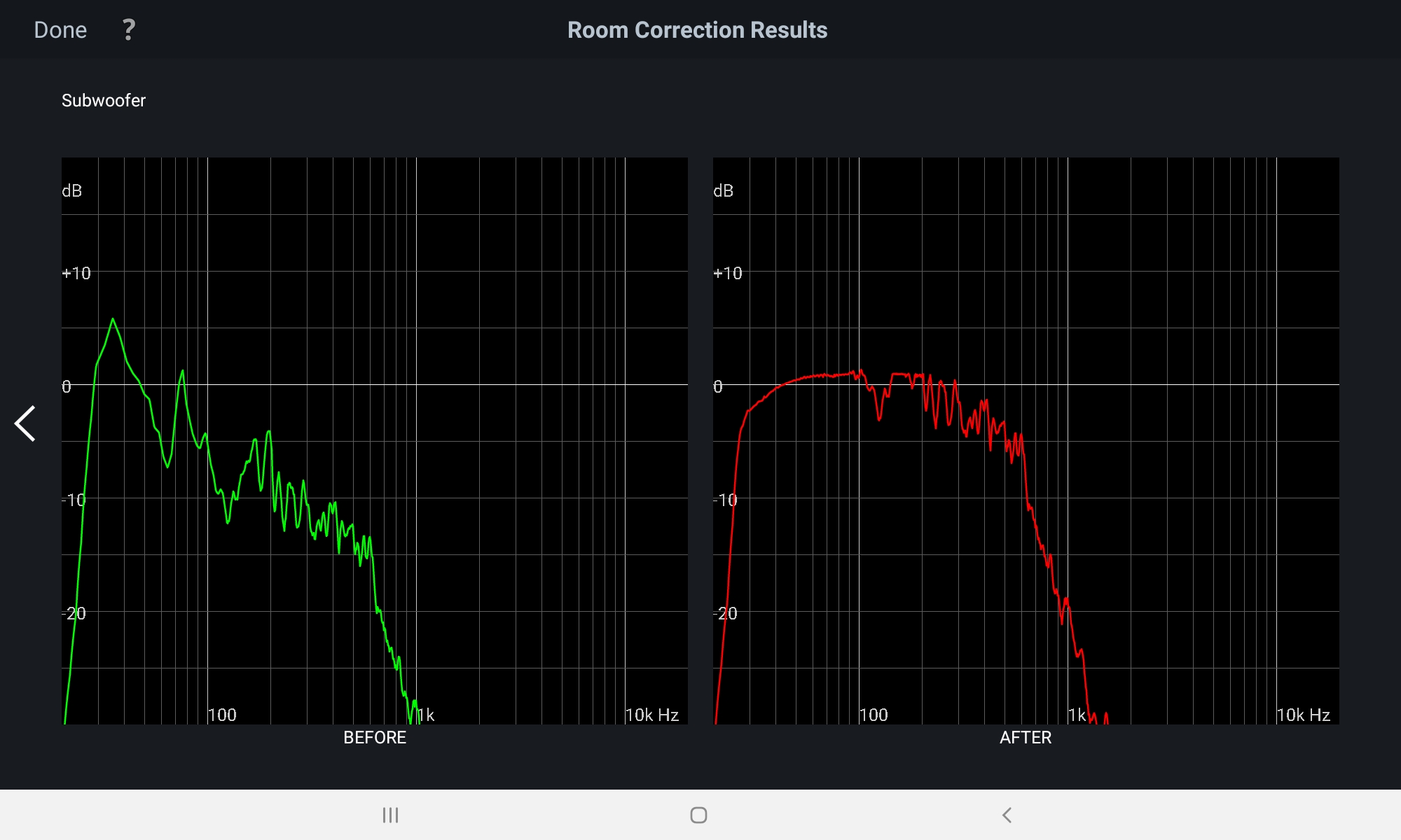

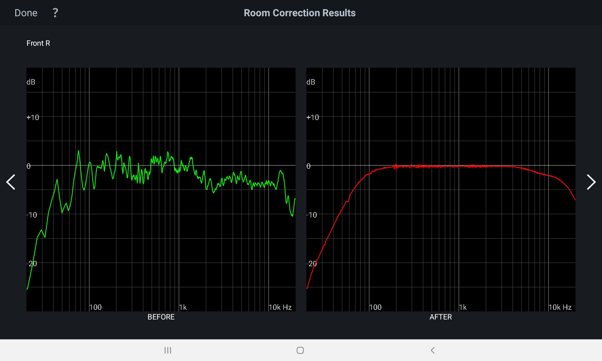

Hello all, I run into a weird issue with the MultEQ app (Android phone). I run Audussey measurements several times and every time the results were that my subwoofer level was set to -12. This happened even if I lowered the level way down and it was also shown in the app's subwoofer level indicator before the measurements are started. As a last resort, I run the measurements using the AVR (X3600H) and then the subwoofer level was set as expected. Have any of you noticed this behavior from your MultEQ app? Is this a known issue? Thank you for any info!
