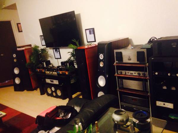

anyone want to comment on this? this pic is the sound system of a guy i bought(he practically gave it to me) and amp from. im looking at sonus faber amati homage speakers 20k / pair. i dont know what the other speakers are but they look expensive. this pic easily contains over 50k worth of audio gear, and the expensive center speaker is sitting on the floor. so in this case, wouldnt it have been better for this guy to use a phantom center?
He has a 2 channel set up and a surround setup. The surround setup looks like Joseph Audio speakers - the center channel on the floor - because of its size it was convenient to place it there. No it wouldn't be better to use a phantom for multi-channel sources, what would have been better was a small stand to get his center about 6 inches off the floor. However many people are about looks - and the fit - would look better on the floor than on a stand in front of his other gear.
thanks for posting. i was wondering what those other speakers were.
my center channel i now have on the floor, ironically enough lol
found out the surround. hales transcendence t8 fronts , t1 surrounds, and cinema center. nice
