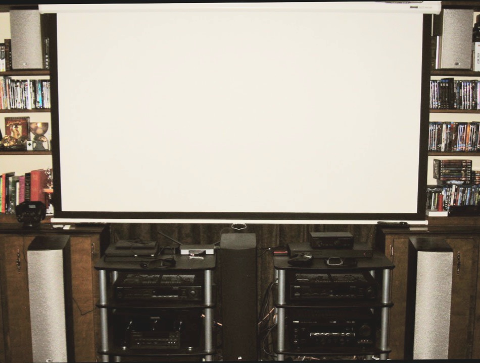

The horizontal centre is simply out of practicality. Even with the TV wall mounted, most people place their components below the TV in a single cabinet, shelf unit or rack unit. With a vertical centre, there are some options, like a single shelf unit to one side of the centre and maybe the sub on the other side, or two single column component racks on either side of the centre, but you rarely see that. Most people want the extra storage or display space that a wider console offers, or have the TV on the console. If I was to build my own console, I would give consideration to making space in the centre for a third matching bookshelf speaker, but that would not only look odd to most people, but the centre would not be free standing like the mains, which could cause issues. I think that's why 3 vertical mains is more the realm of dedicated theatre rooms where the components reside away from the screen.
VonMagnum
VonMagnum
Obviously, some rooms will not be able to use a bookshelf or tower for the center, but I imagine the number of rooms that won't support it without modification is far lower than the number of rooms using a center simply "because they sell a center so you must use that" mentality.
The idea a bookshelf speaker would look "odd" while a honking horizontal center speaker would not sounds very odd to me. As long as the front baffle is even with or extends slightly beyond the console frame, it should perform fine.
As for no room for a center with two consoles or racks....
VonMagnum
VonMagnum
Sorry about the image duplicates, but my account has been screwed up for literally years and there's apparently no maintainers here. It kept saying "Oops, there's an error, try again."
Now it won't let me delete them and it just errors and errors and errors. Not my connection, browser or anything like that. Nothing I can do. I've emailed, pm'd on a different site even. They deny they've screwed my account up on purpose, but the mere fact they ignore all requests to delete it then so I can try a new one tells me otherwise.
Edit: I think I finally managed to delete the duplicate images after 30 minutes of trying...
I think those speakers are too close together. That is a common error, and leads to comb filtering and also a narrow sound stage. I think you would be far better moving the mains much further apart.
I prefer the center above the screen in my room. Heads are nearer the top of the screen generally, than the bottom.
Also I had the ability to design a speaker specific to center use, but also match the mains. This was the most difficult to design and took significant research and experiment. I came up with a coaxial TL based through wall design, sloped to the listening area.
The top driver is the "fill" driver.
It is bi-amped active, and has continuously variable BSC that is optimal for position and room.
This all contributes to a believable 3D soundstage that is seamless.
I think center speakers need significant thought and are difficult to design. The have different design parameters than the other speakers. To produce realistic natural speech is perhaps the greatest of all challenges to the speaker designer. If you get that right, then everything else is more likely to fall into place. The center can not be massive, but it still has as much, if not more heavy lifting to do than the rest. It has to stay clean when singers are center stage, and reproduce the piano perfectly in the most tempestuous of concertos and in multiple scenarios. At the same time it must blend seamlessly with all the other speakers.
They're 6 feet apart in a 12.5' wide room (24 degrees from MLP sitting up, 22 degrees reclined), well within Dolby specs. They need to be there to handle panned dialog in some movies and aligning sound effects to the matching event on the screen (e.g. Harry Potter flying car in the 2nd movie lands right on the left side of the screen and so does the sound effect for it). A narrow soundstage is not an issue due to the front wide mode (see below), but even without that turned on, out of phase effects extend outward beyond the speakers and Sonic Holography (which I have as an option for stereo sources) expands it to about 100-110 degrees (360 in multichannel stereo mode). You can't get any less narrow than that!
If you're worried about mostly inaudible combing effects, you'd really hate the fact I use the front heights for a L/C/R soundstage and dialog lift effect by mixing them into the height channels (I got the idea from my old Yamaha AVR that had it as a DSP option; it was amazing so I recreated it externally).
Oh, but it doesn't stop there. Front Wides (nearly against the walls and about 11' apart at their grills) are currently passive summed/mixed so in stereo mode, they act as a wide stereo mode (Monoprice has a similar option on their HTP-1 AVP) when left engaged (OMG! More combing potential!). The soundstage is enormous (opposite of narrow) and again, even more so with Carver's Sonic Holography engaged (image extends and wraps around to about 110 degrees with no surrounds in use including sounds imaging a few inches in front of my face at times). That took extreme precision to achieve with multiple speakers active. It does the entire room in multichannel stereo mode, making many stereo albums sound like 5.1 or even 7.1 surround recordings. Some even somehow manage height effects (possibly due to the dialog lift height speakers being active and interacting with crosstalk cancelation).
Nope. See above.
That would be a big no-no with Atmos/Auro/X since front height effects go there (and the optional center height speaker in Auro-3D and DTS:X layouts). I use dialog lift to place the dialog to sound like it's coming from the screen itself, not above or below it). That sounds the most natural to my ears.
That sounds like some real creative fun, but it's so much simpler to just use matching speakers, IMO.
Nope. See above.
What I found was that matching speakers are not the ideal solution. The screen can not be lower, and if the center were below the screen it would be an acoustic disaster.
There is plenty of height above the main driver which is right above the screen. In addition there is also a lot of height left to the ceiling and Atmos works very well.

Having the center at the same height as the mains is an acoustic disaster? Sorry, I don't follow...at all. It seems to me having the center soundstage well above the left and right soundstage creates a vertical anomaly in the center. I want a coherent front soundstage, particularly for music. I mean if you don't watch many movies, why would you want to hamstring your audio even slightly?
Besides, as I said, I use a dialog lift feature to raise the L/C/R soundstage to phantom image as if coming from the screen while not being blocked by any screen. The front heights have the same drivers as the mains (they simply lack the 2nd woofer for extended bass to 30Hz and cut-off at 50Hz, well below the 80Hz boundary). As for ultra-wide stereo positioning, Trinnov doesn't recommend separation between any given pair of speakers go beyond 50 degrees, when possible. Wendy Carlos Surround site suggests going beyond 60 degrees is where phantom imaging begins to fall apart. With home theater, one has the center speaker to ensure that wide placed L/R speakers can be very far apart indeed, but that doesn't apply to stereo material played back through the system without the center. With the traditional recommendation of 30 degrees from the MLP, the mains are already 60 degrees apart from each other (mine are at the optimal 50 degrees with front wides able to widen the soundstage to 100 degrees apart if desired.
