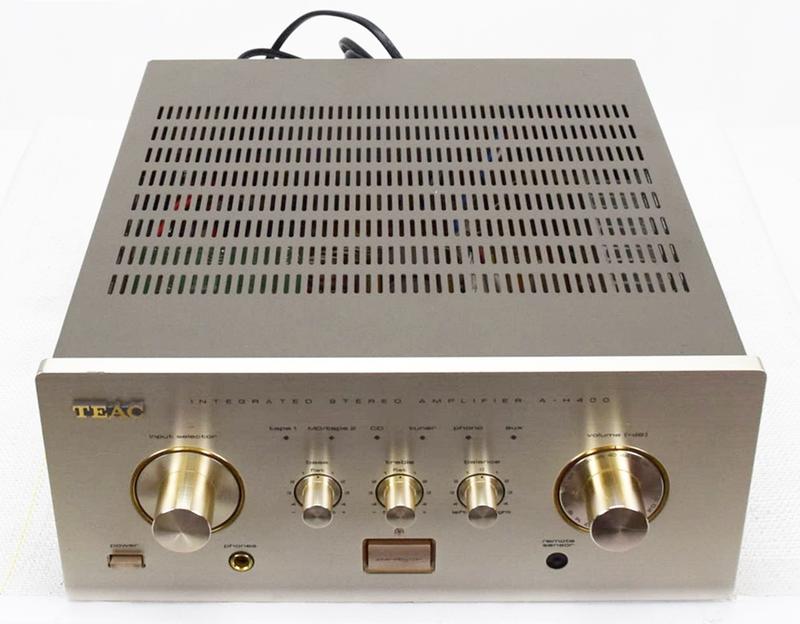

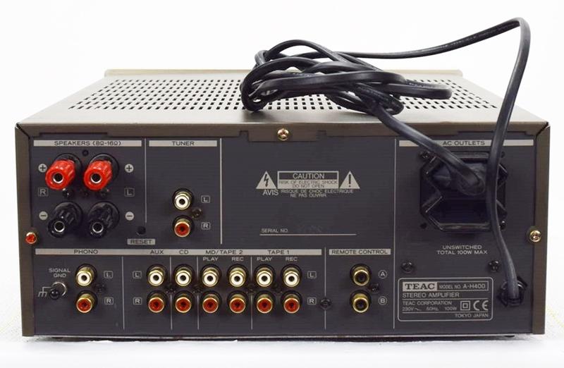

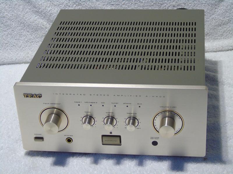

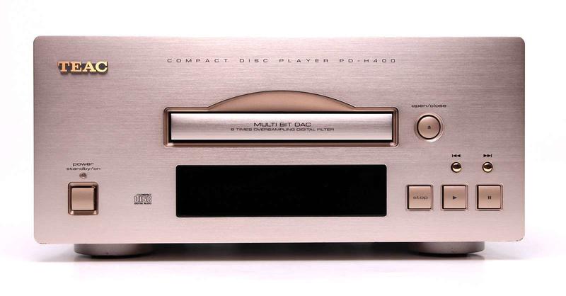

As far as I know, from the TEAC 400 Reference Series are there only two components, the A-H400 Integrated Amplifier and the CD-Player PD-H400. The PD-H400 looks like the PD-H500.
TEAC A-H400:
my Amp:

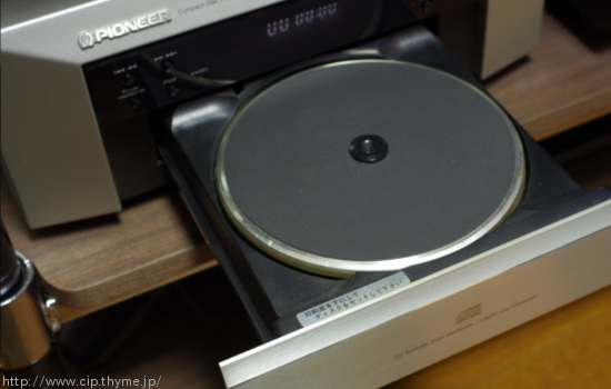

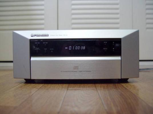

TEAC PD-H400:
PIONEER PD-C5:
Here are some A-H400 specs to compare with the other components:

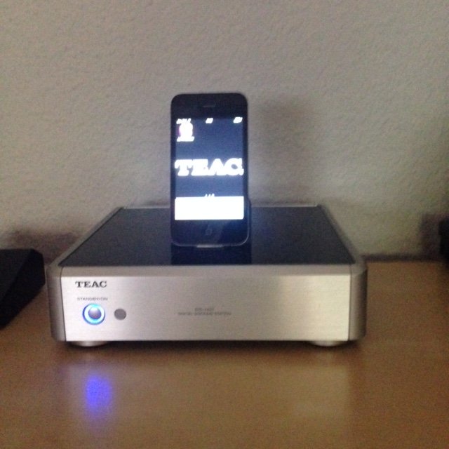

I feel very fortunate to have found this site full of Teac-Addicts.
This is my little collection.
{snip ...}

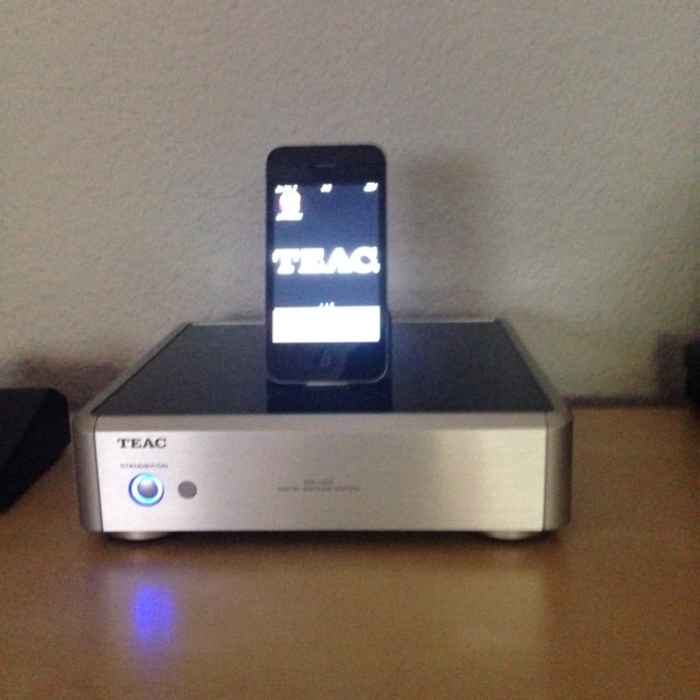

I see you have a TEAC UD-H01. I love mine.
I remember when these types of products first came out in the late 1970's. They were a hard sell then, and it hasn't changed much. Technics had some very nice stuff then, but about the only thing that anyone today might recognize is the compact automatic linear tracking turntables with P-mount cartridges that were part of the line.
