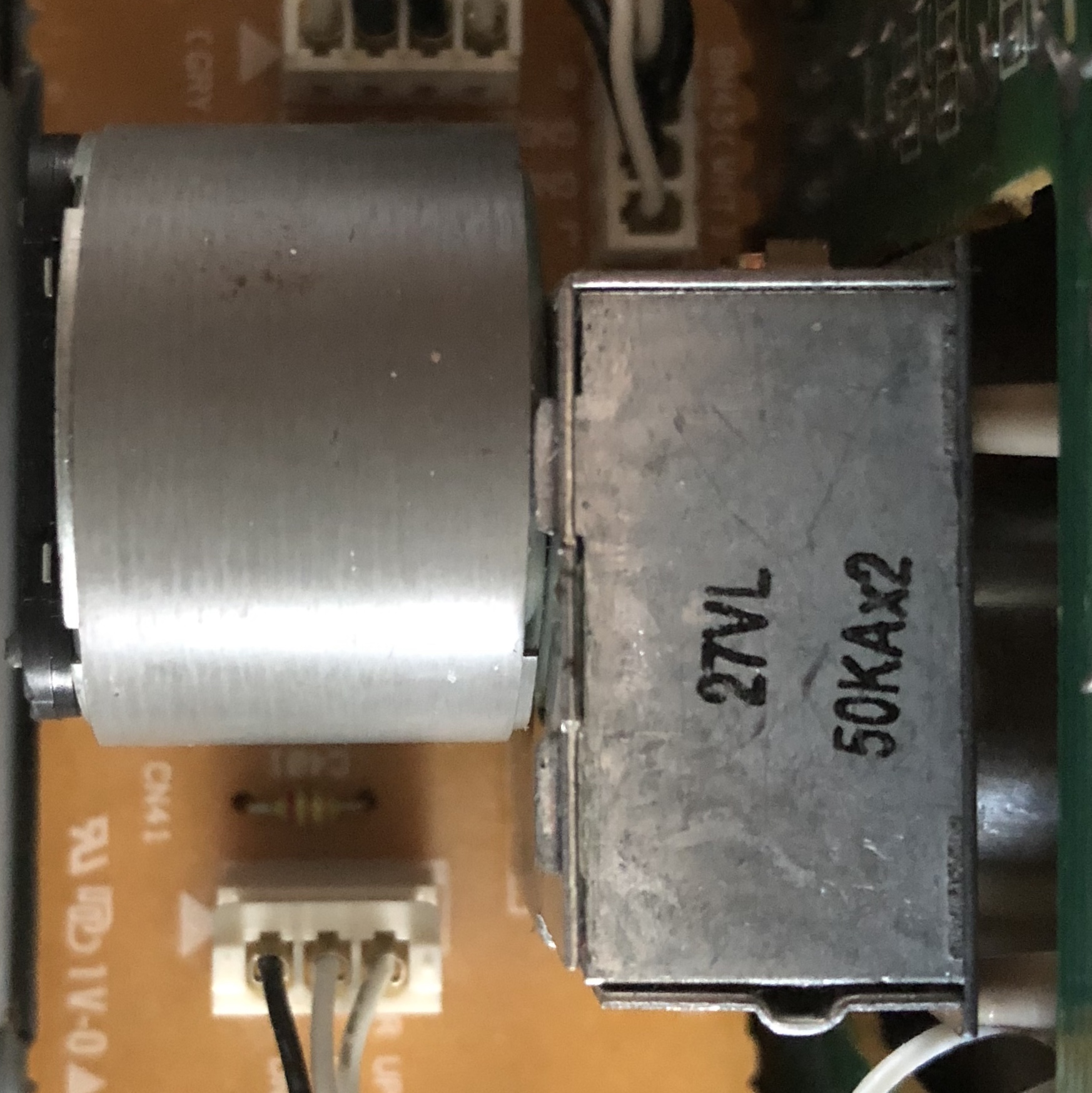

I have a ah-500i but it has two issues that prevents me from using it.
1. A slight channeled imbalance
2. Volume increases to fast, i.e. it goes from 0 almost immediately. During the evening (using headphone) I can’t even use on “1”.
I have had the volume pot replaced by Teac authorised personal in Sweden (Gothenburg) but there is no change, neither to the imbalance or how th volume increases.
I have heard of a similar case where a new quality pot (ALP) helped although that wasn’t on a Teac. He had first tried some cheap pot and it didn’t help.
Could this help me?
Could the pot they installed been bad?
Has anyone else experienced these issues?
I’m grateful for any help as I really would like to start enjoying the amp.
/Nico

Does the volume behave the same way on all inputs and outputs? Does it behave like a volume control at all, or more like an on/off switch?
Well, something in between. It goes from 0 to "loud" quickly but then it keeps increasing the volume. For me it's already to loud at "1" at night time when I want background music. It's like there is no fine tuning at low volume
Yes it behaves the same on all inputs.
This is pot used after service, i.e. it’s the pot service installed.

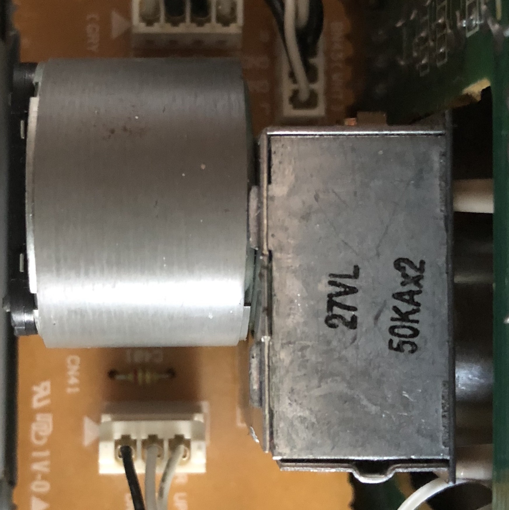

This is pot the inserted.
Hi Nico
Nice picture! This looks right so far. The whole assembly looks a bit cheap and primitive, but mine was the same when I opened it up and had look. The replacement pot from AliExpress looks similar, but it seems to give good results - although I've never tried the motor control part since I don't have a remote for it! Anyone out there got a spare remote they will sell me? ;)
50KAx2 is correct per the schematics - 50kOhms end to end resistance on the pot, A for the type of audio taper (volume controls are non linear) and x2 for stereo, ie two channels.
Going a bit deeper... The round part at the top left is the motor - with a magnetic shield slipped over it. The rectangular part with the lettering is a gearbox and slipping clutch. To the right of this is the bit we care about most - the potentiometer. Interestingly your picture looks different from mine, and the AliExpress part in the picture I posted previously! If you refer to the Ali picture you'll see there's a small round silver part with 50KAx2 in blurry writing. Do you have one like this? Could be something, could be nothing...

...hmm maybe its not visible cos its buried in the front panel.
N
niccav
Hm!
I would almost have to remove the front panel. Is it easily done?
I think so but I will connect some speakers and confirm. Until tomorrow when I have some more answers.
