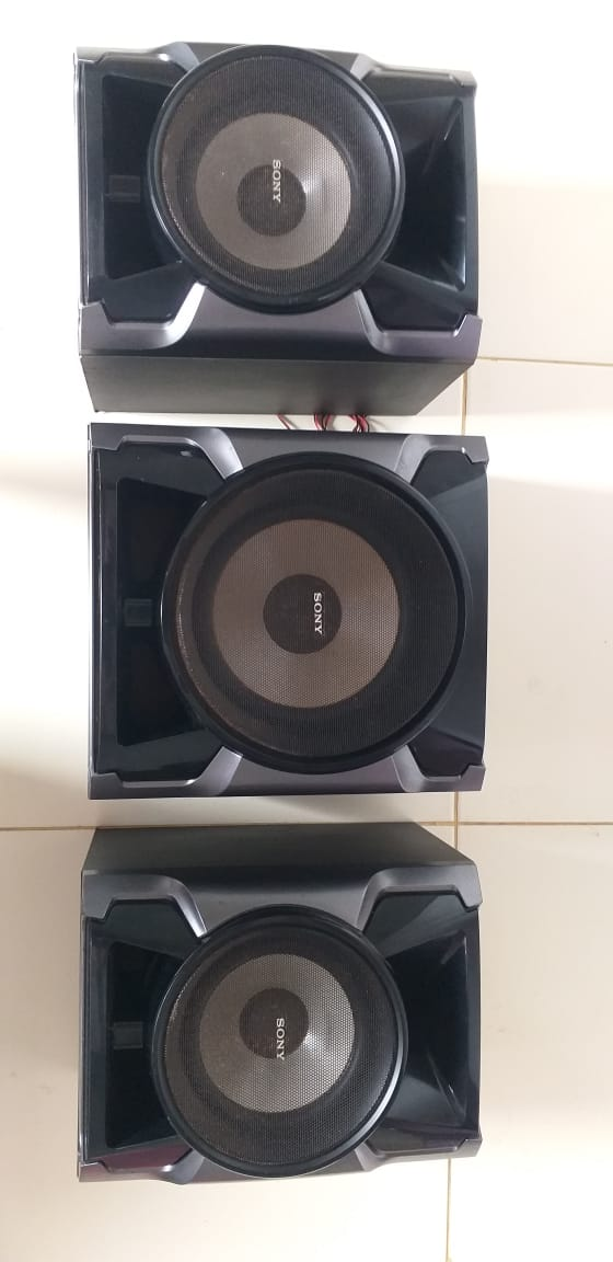

and then going back to these, these are 5 ohms speakers, i just don't know if they would even work in this application, or if they are worth the 30 bucks the seller is asking
the wire looks fairly standard, butit got that fancy termination, so i'm not sure if i cut thatout, it would be just regular speaker wire
and then going back to these, these are 5 ohms speakers, i just don't know if they would even work in this application, or if they are worth the 30 bucks the seller is asking View attachment 47081
I'm not huge on speaker aesthetics but these exceed my tolerance....they are butt-ugly! Looks like a goofy design but who knows might work okay for surrounds.....
for now, i don't care for the asthetics, not while i'm in such a low budget, i just wanna know if theyw ould work, lmao

i'd probly have gone for them by now, if not for the weird terminations

Phew. We have a saying that goes "you can't get steak on a hamburger budget". This case is more like trying to get hamburger on a dried beans and rice budget... I'm not picking on you. Wish you had better choices.
What are the strange connections, rca type or a particular proprietary type? Probably just snip the connector off...or put different terminals on.
Then again I might fix the remote/zone 2 issue before worrying further for that matter....
