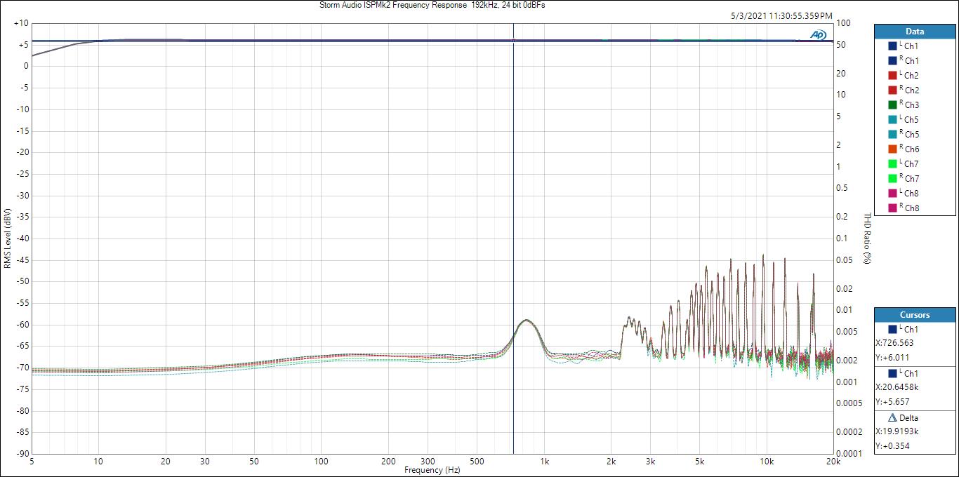

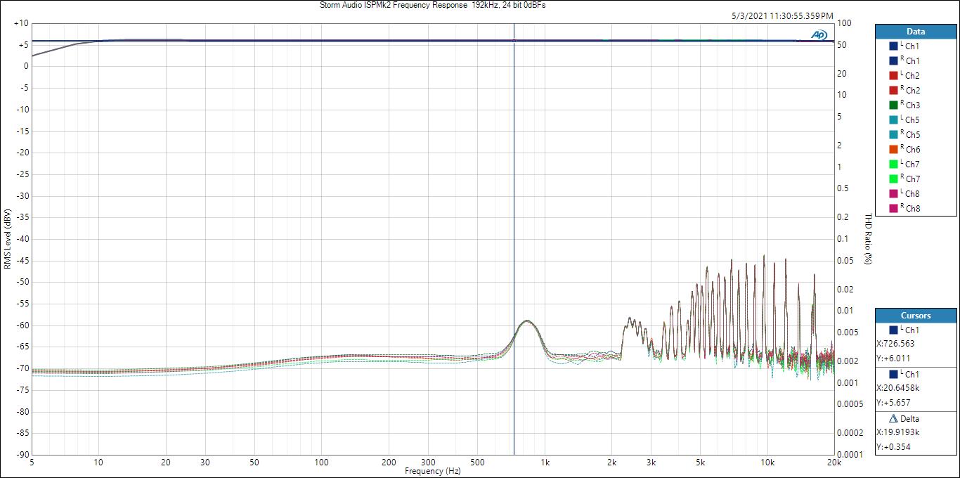

Thank you for your review. What was the voltage level of the measurement below? I couldn’t figure that out. The was another measurement that was at 8V and wasn’t sure if this one was 8V?

Hi @gene,
I have the Stormaudio MKII as well enjoy it very much. Thanks again.
So if you look at the RMS level on the vertical scale for this measurement, it's around 5.6dbV.
To convert dBv to Volts(rms) you do alog(dbV/20) which in this case would be alog (5.6/20) or 1.9Vrms.
