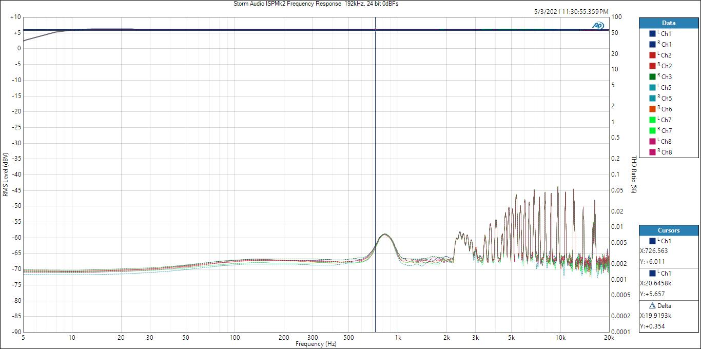

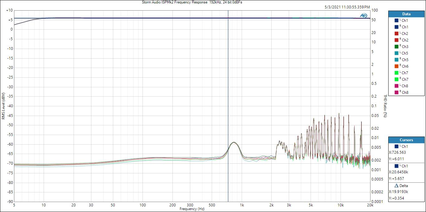

Hello Gene,
Isn't the Y-axis THD+N, not THD?
You're right and that measurement looks worse than it really is. Someone send me a link to Amir's commentary about this and I looked over my other measurements I didn't publish.
What this graph is actually showing is a combination of the down-sampling behaviour, anti-aliasing filters and the fact that my measurement is wide bandwidth. Sadly I didn't save the limited BW measurement and I don't want to rip the unit out of my rack to remeasure until StormAudio does the DAC upgrade.
I updated the text under that measurement as follows:
Update 12/13/21: A thread at ASR was brought to my attention discussing the above measurement with Amir and based on the comments there, I revisted and updated the text below.
The above sweep shows frequency response vs distortion which is exceedingly low at 0.002% THD+N (or 94dB SINAD). The distortion spikes above 5kHz are mostly due to a measurement anomaly caused by a combination of the down-sampling behavour, anti-aliasing filters and the fact that my measurement is wide bandwidth. It is likely so pronounced due to the high input sampling rate and the StormAudio ISP MK2 downsampling to 48Khz and not having usable output above 22kHz. I didn't see this many spikes when sampling at 48kHz but sadly I didn't save that measurement to replace the one above. It’s also still at 0.05% THD+N at 20kHz so still relatively low. I’d like to see better results here but an improvement may likely NOT be audible in most scenarios for even those audiophiles with the best of hearing. StormAudio has informed me a DAC upgrade is in the works slated for sometime in the near future with a possible higher sampling rate offered too. I will be revisiting these measurements once I get the upgrade module installed.
Thank you for updating the text to ease concerns some readers may have, when they see those 5 kHz and up distortion/noise spikes and the fact that you mentioned "DAC upgrade". 192 kHz sampling is indeed a very wide bandwidth, a whopping 96 kHz! So everything above 20 kHz up to 96 kHz, whether they are distortion, noise or both, all would have been captured, and the AP would have total things up and report them as THD+N.
The 0.05% THD, or THD+N at 20 kHz or even at 5 kHz would likely be made up of distortions and/or noise (looks more like noise) outside the audio band anyway. The second harmonic of 20 kHz is 40 kHz, is well into the ultrasonic band, nothing to worry about even without the DAC upgrade that they are supposedly planning on doing.
Yea it's fine, though still not SOTA but not bad. I don't use the DAC for the front LCR's since I have the separate Marani DSP running for the active speaker setup.
Actually I almost forgot how much this thing costs. With that in mind, I actually do think they need to upgrade the DAC section if that is what they need to get SOTA measurements.:D
Absolutely. I always test at 192khz and get better results on product that doesn't Downsample to 48khz. They can do better.
Thanks for updating the review. Without it, it seems there is an issue in the over 5k range, when it is something that will only show up in wideband measurements. While Trinnov seems to get quite a bit of the buzz in the high end processor market, I too opted for it over the Trinnov.
