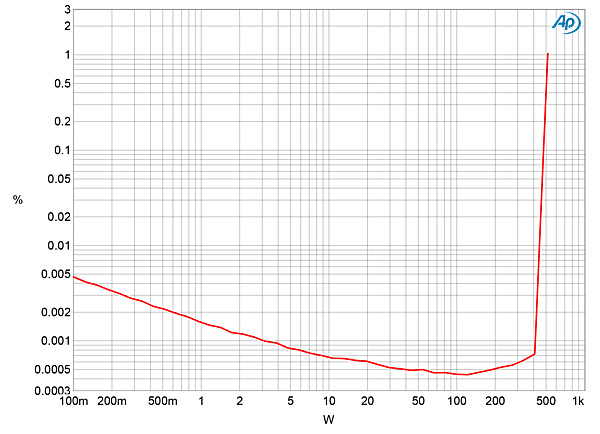

Mind you, only reason they’re making these changes is because the cat’s out of the bag. If I still had my Mac amps, I would’ve sent them to Amir or driven them to Gene to test them. I bet their measurements wouldn’t have been any better than some of the well regarded, less expensive amps we all mention here. Still, it’s great to have these gents keeping these manufacturers honest.
I would bet the McIntosh amps, even the lower end ones such as the MC312, will measure as good as those in the green or even blue zone of the ASR chart.
MC312:
Power Output: 300 Watts into 2, 4 or 8 Ohm speakers Total Harmonic Distortion: 0.005% maximum from 20Hz to 20kHz Signal to Noise Ratio: 120dB Balanced 118dB Unbalanced
That's 86 dB SINAD, only as good as D+M AVRs but it is for 20 to 20,000 kHz. With 1 kHz test signal it will be much better.
Even at 0.005%, it is still a lot better than ATI's signature series 0.03%, though ATI's damp factor spec is much better.
Just Google and found that for 1 kHz, it was about 103 dB SINAD for the MC462. The only amps measured on ASR by Amir that could beat or equal the Mc would be the Benchmark AHB2, and a couple Purifi and Hypex Class D amps, though that's on THD+N/SINAD only.
@AcuDefTechGuy , the crazy one who wants 3 zeros behind the decimal point please trade your Signature amp for the Mc.:D

Agreed. But part of the point is that just like these processors, their price difference should command specs that are “much” better than the rest. The Mac amp may measure “slightly” better, be inaudible, and costs at least twice as much as the ATIs for example.
