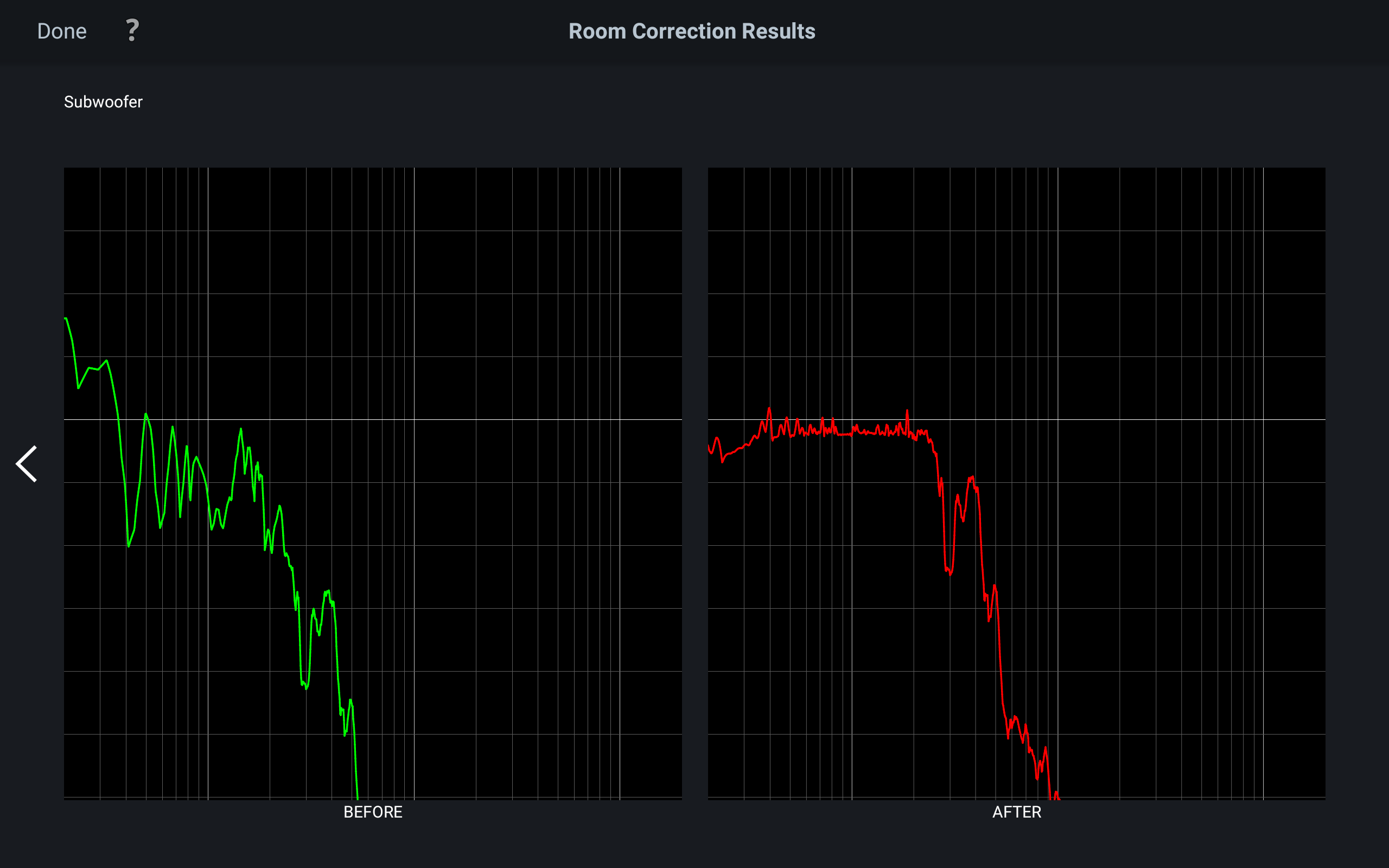

Right on. A couple things tho, Audyssey will almost always set a good speaker to large. It did it with my bookshelf speakers too. I go in and manually set them to small and switch the crossover to 80hz. I run my subs no matter what content I'm playing. Even with full range towers. I guess I need to come to terms with the fact that I'm a bassaholic too...
I bought a Umik mic and dl'd REW. That's how I did before and after measurements. The editor app will show you before and after graphs too.
This one is before and after with my subs.

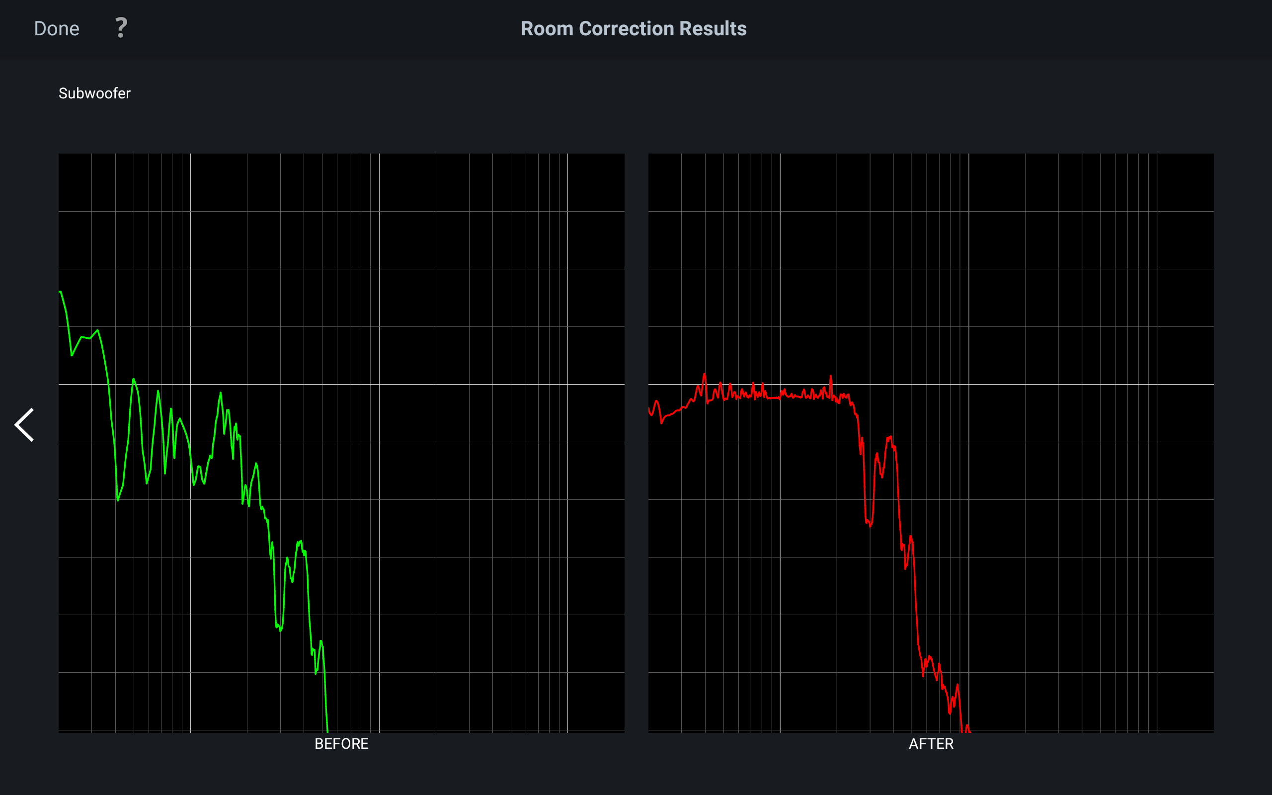

Audyssey...yeah I ran the B&Ws 2.0 for a long time, but now that I have the subs, I like the stronger bottom end...I will manually tweak that as well because I have a lot of music on JRiver and Itunes, being able to set a playlist and let it ride for an hour or two song after song that you really like is attractive.

I forgot to mention that a lot of us give the subs a 3 dB bump after calibration. I do.

I decided to move the sub behind the main seating to the TV to balance that out and as I expected it got rid of my localization issue. It wasn't a big problem, but it was just something that was on my mind. Ran Audyssey again and of course it picked up on the moved sub and adjusted the distance and dB.
I bumped both of them up about 3dB as you suggested...with the B&Ws I prefer crossing over at 60 I said I was going to try it 50, but I haven't done it yet.
