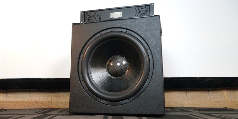

RTJ Audio 18Sub Subwoofer Review
shadyJ
Speaker of the House
Staff member
RTJ Audio blew us away when they paid a visit to the Audioholics Smarthome with a pair of their 410 modular towers. It had a monster dynamic range but not at the expense of fidelity, and it was a speaker that could tackle any high-end private cinema with ease no matter how large. Sadly, we only had time to play with the 410s for one weekend, but that might have been for the best since it made loud sound so good that we might have ended up with hearing damage if we had them for a longer period. We found many of the design details intriguing, and so we leaped at the chance to review one of the subwoofer modules that RTJ calls the 18Sub. While the subwoofer modules can be had as a part of the complete 410 tower system, they can also be had separately, and there are a lot of interesting aspects of their design that warrant the 18Subs for serious consideration as an individual subwoofer system. Read our full review to learn about the RTJ 18Sub...
READ: RTJ Audio 18Sub Subwoofer Review
Danzilla31
Wow shady great review. What a gorgeous beast of a subwoofer
