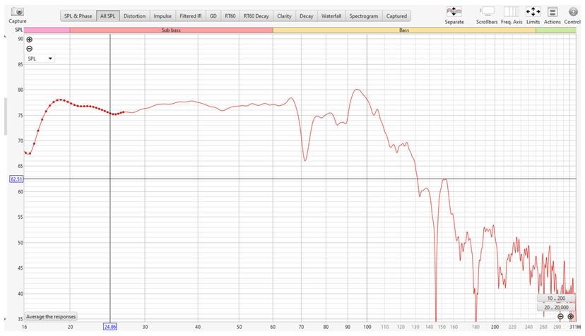

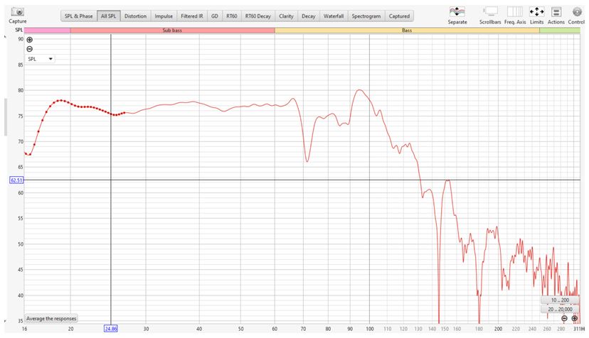

To be honest, I dont think so. But I am not expert. It is run out of a Marantz 6015. Both Audyssey MultiEQ and REW/Umik-1 give me the same profile. With or without Audyssey Off. Reference/Flat, does no matter. Perhaps the Marantz is applying a filter?
If so, will appreciate guidance on how to setup my AVR correctly to extend the SUB response beyond 100hz.Thx
Did you measure it in room or out in the open for an anechoic response like Shady is doing
I guarantee you that once you put that DN15 into your room that room is going to mangle that beautiful response curve Shady is showing in his measurements and it won't be extending out as far as you see it doing here in his tests
In my bedroom I have had quality subs that extend well beyond 100hz but in my room, in the best spot for placement, measuring with REW the response drops pretty sharply after 90hz no matter what.
The room is going to affect your subs measured response in a huge way which is why as I'm sure you well know room eq is so critical in the bass region
That may be the case. And I thought of that. However, I would think the same would happen to any other speaker on the room. Yet my old Polk rTI A7 do extend down to 30hz, with quite good response from 90 to 250hz (in my room). The range I would like to see covered by my two DN12,; bc I would need my Sub to cover for my Surrounds, which roll off between 120 and 150hz. No issue with my LCR, but my surrounds would benefit from a Sub that covers below their range.
He might have left some kind of low-pass filter on when he measured that. Also, like what Danzilla said, the room acoustics will boost the lower stuff but not the upper bass stuff, and can make an in-room response look low-pass filtered too.
Thank, appreciate any guidance on how to measure correctly / dissable any low pass filters (I am driving it using Marantz 6015)
Make sure that 'Low Pass' on the sub is set to LPF. Make sure that there is no bass management engaged on the Marantz when you run those sweeps, or set the low-pass filter as high as it will go. I would bypass the Marantz altogether when taking a sweep if possible.
OK, so this may be constraining sounds above 120Hz. Will try a higher setting. Thx.
PS, the DN12 LP goes from 40 to 150 and LFE. Its currently on LFE. Will play with these too
