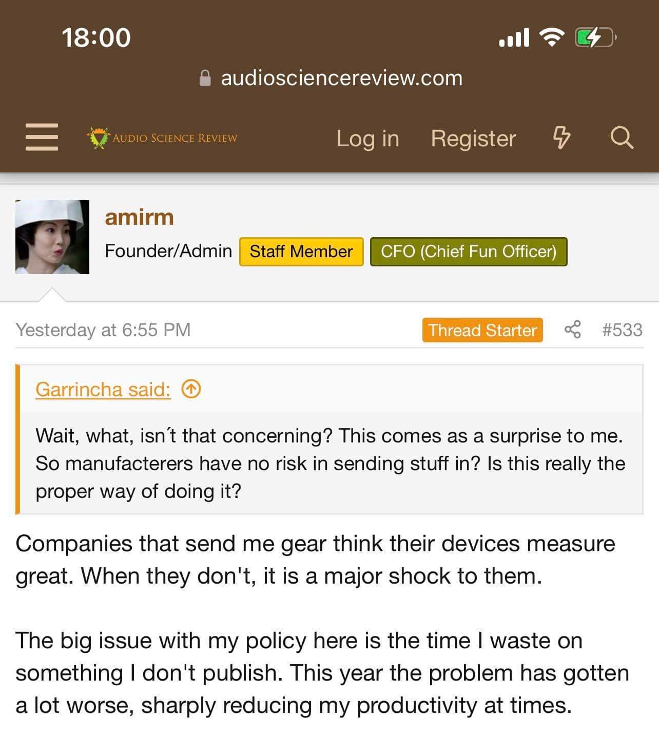

I really don't care what keyboard commandos do on their forum. It's their playhouse. Starke messed up for sure. I'm glad they fixed the situation. But some will continue beating them down. I suppose it feels good. It's not my thing. Had Starke produced another lemon, I would have cut them off. The fact that we've reviewed a few good products from them so far and they've issued returns to unsatisfied customers keeps them relevant to cover with our readership.
BTW, it seems AMIR doesn't always publish if a product doesn't perform well. We give manufacturers a 2nd chance to submit new samples or we publish as is once they confirm our test sample works as expected.

He also publishes far more testing than you do. If he has his own reasons for holding some back, they're his. If you always review/publish what you put on the bench that's nice, but....
The point is he and his fans accused us of the very same thing he apparently does too.
