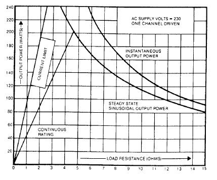

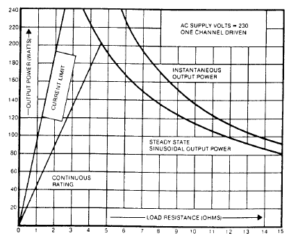

I have not seen the owner's manual of the Quad 606, below is one I found in the service manual. I am not 100% sure how to read this graph's two straight lines on the left. If that 2nd straight line is for "continuous rating", then you could say at 2 ohms it would be about 90 W. That is excellent, I doubt AVRs can do 90 W into 2 ohms average for much longer than a few seconds even for a pure resistor load.
