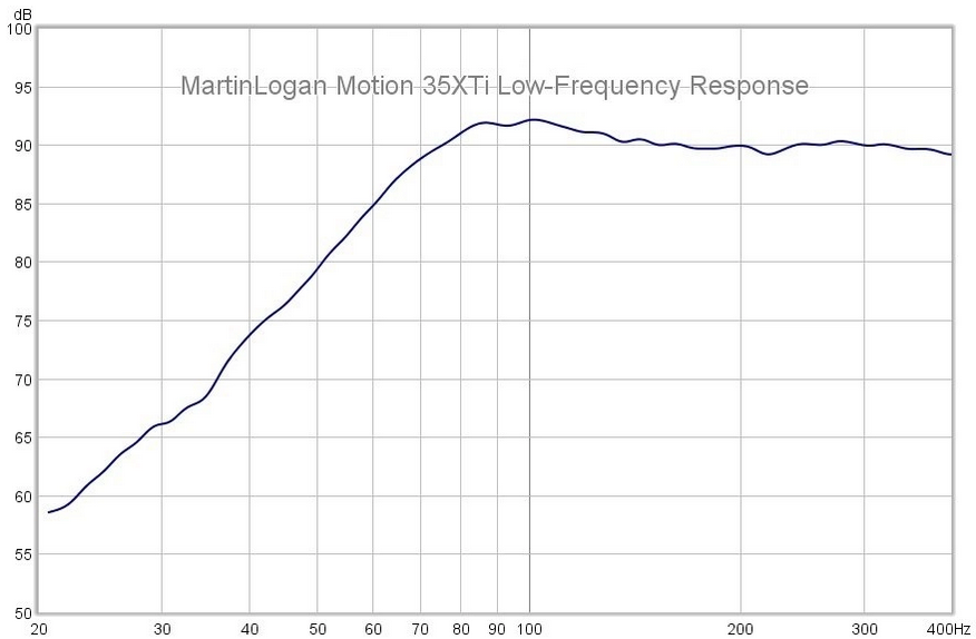

Here are the specs for the speakers, if they haven't been posted. They appear to be little fussy around 100hz, which probably is fine at normal listening levels, YMMV of course
Sorry, those are for the xt not xti, here is James review
They don't look hard to drive but I would probably XO them at 110 Hz. May be 100 Hz is better, would have to try.

Hi, I posted the specs of 35XTI , in my first post of the thread. Having read through James review, I'm happy I made the right decision with the speakers. They sound fantastic. Only issue is the lack of good sub-out from the Sonos Amps, which prompted my quest for finding a suitable alternative .
However, does it change (esp prominent midrange response) any of the Integrated amp recommendations?
@PENG , Looking at the frequency response of the speakers from Audioholics review, , seems we still good o/p between 80-90 Hz.
Would like to know the reasoning behind your suggestion of XO at 110-100hz .

I tend to go at least an octave above the f3. Depending on your gear and available bass management, it will dictate a lot. Your speakers roll off at 24db per octave so if it were me, I'd start higher than 80.
From SVS merlin, seems the recommended Speaker/Sub XO is at 80hz for AVR and recommended LPF is at 60Hz for Stereo Pre-Amp (for 2 channel applications) with 12 dB/Octave , for ML Motion 35XT( they dont have 35XTI yet in their tool).
Most recommends 80 Hz because that's a safe bet, given that you don't really know the frequency response of your speakers as placed in your room. If you do, and if you see the in room response extended down really low, then there is a good chance that the low frequency output from the main left/right speakers may interact negatively with your subwoofers. Example, you may have some major dips in the 20 to 150 Hz range due to cancellations. Setting XO higher than 80 Hz will help lessening such negative effects. It is a case of more means less.., so less actually means more...
Right 80 Hz is the generic recommendation, seems SVS merlin suggests lowering all the way to 60Hz for 2 channel application for this particular speaker model with their subs. Reason for me bringing this up, is that I actually liked low frequency o/p from the mains in this range, than the Sub. Sounded more integrated! It may have very well to do with the poor Sub-out from the Sonos Amp and not reflective of the Sub. This is actually what triggered my quest to find an alternative to the Sonos amp.

It depends on your room, placement, DRC, and your preference. I go by the measured data, and I aim for the best possible accuracy/neutrality.
