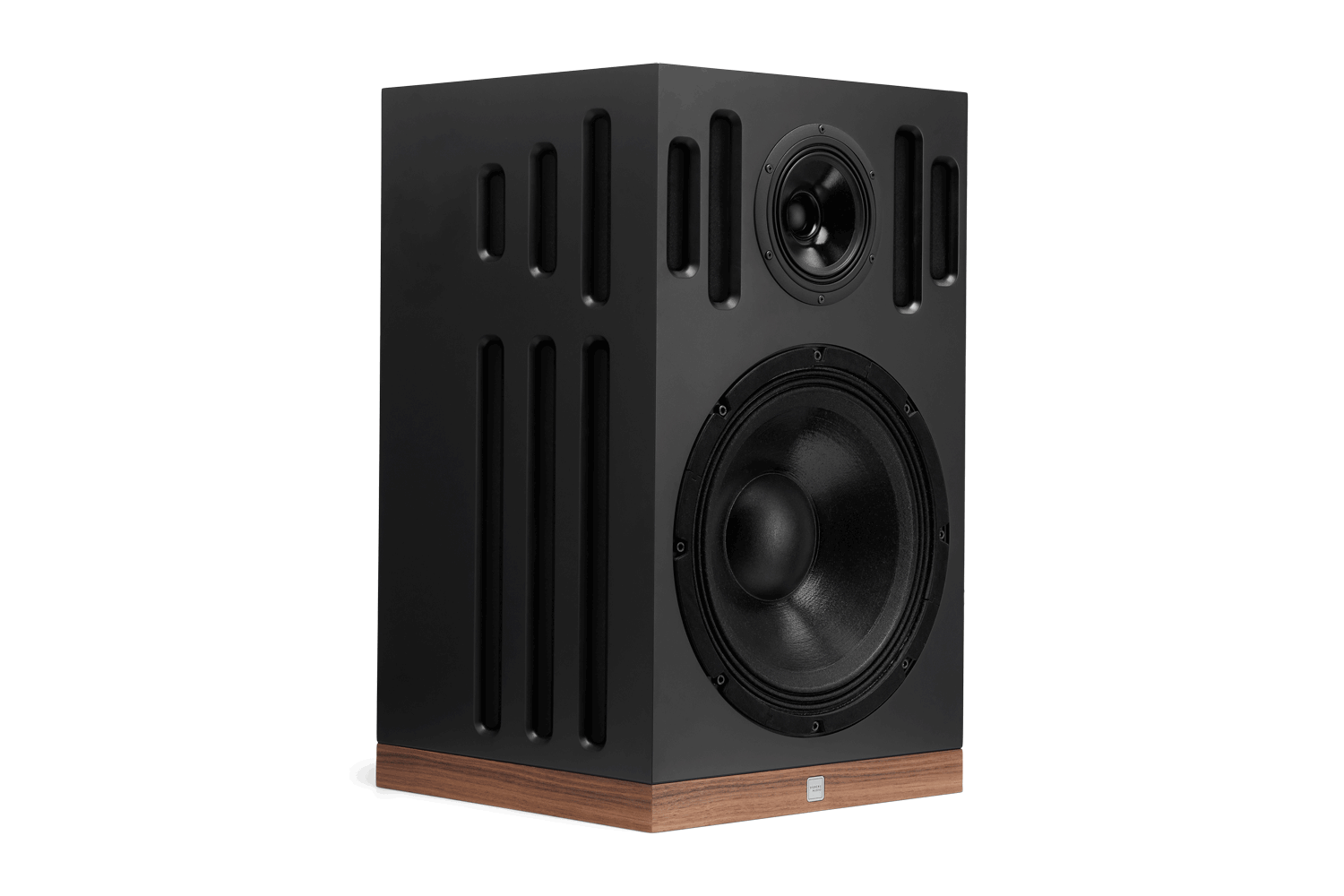

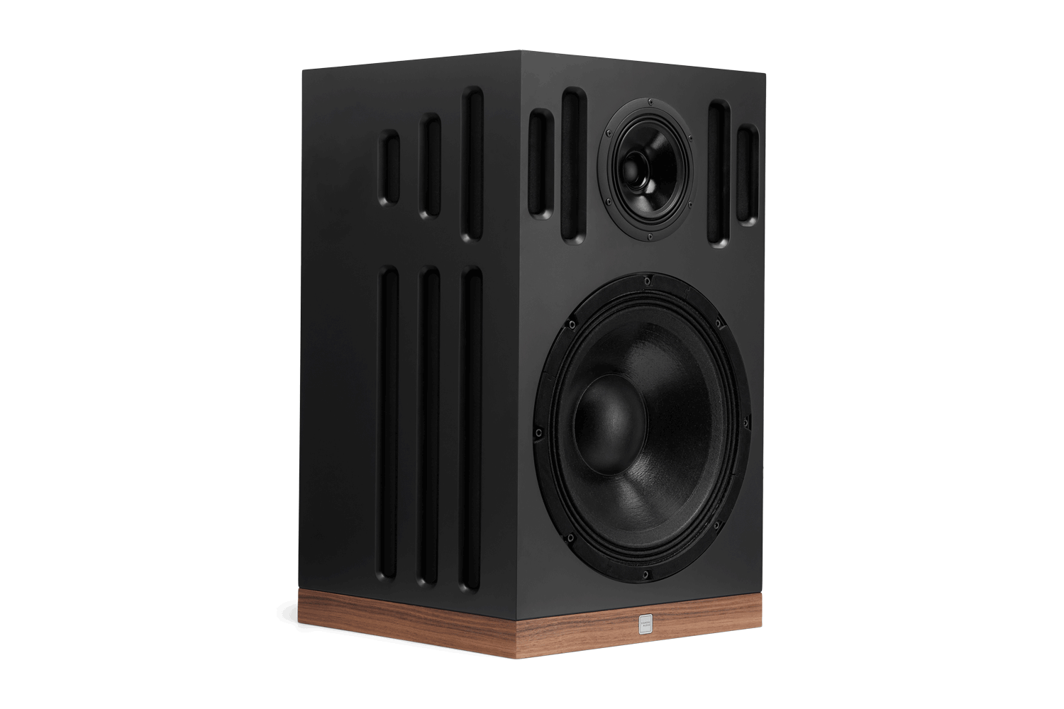

One step closer to opening the presales, product photos are now up on the website! :)
See the rest here: https://www.sigbergaudio.no/no/products/sigberg-audio-manta-1-active-speakers

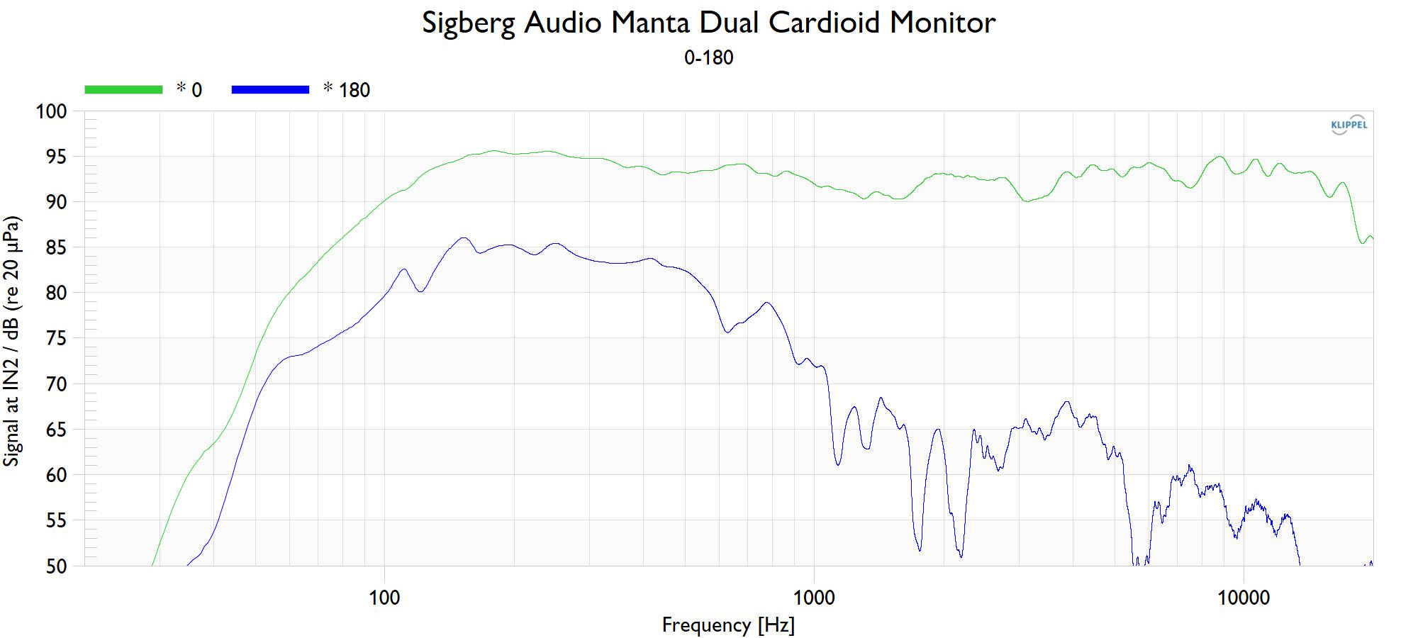

Aaaaaaaaaanyway, the conclusion from the Klippel session is that the Caridioid systems are definitely operational. :) After studying 90-120-150-180 degrees we can define a .."dispersion characteristics specification" as follows:

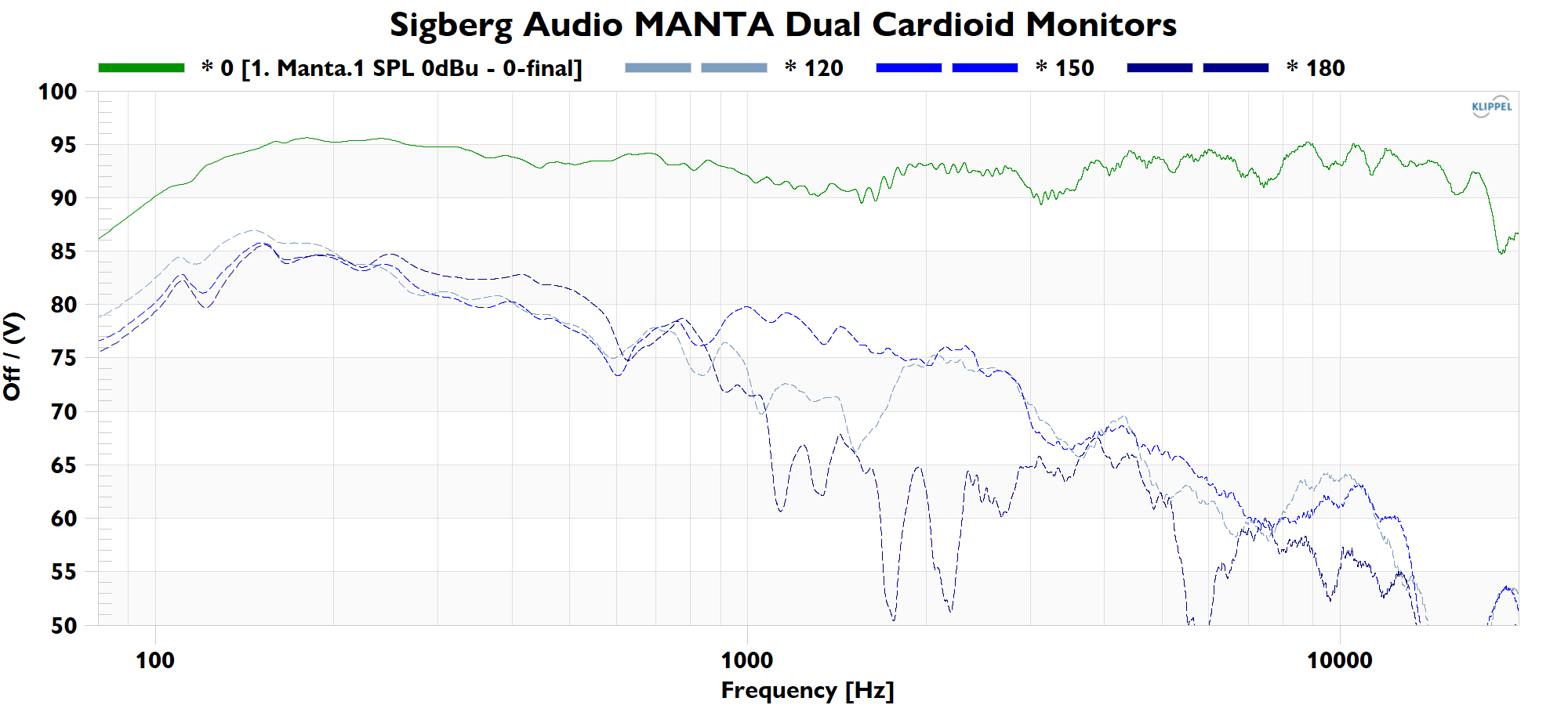

Cardioid dispersion characteristics (120-180°):
~100-500hz: 10-12dB attentuation
~500hz-1khz: 16-20dB attentuation
~1-5khz: 25dB attentuation
This is a more wide-band cardioid effect than I'm aware of in any other speaker.

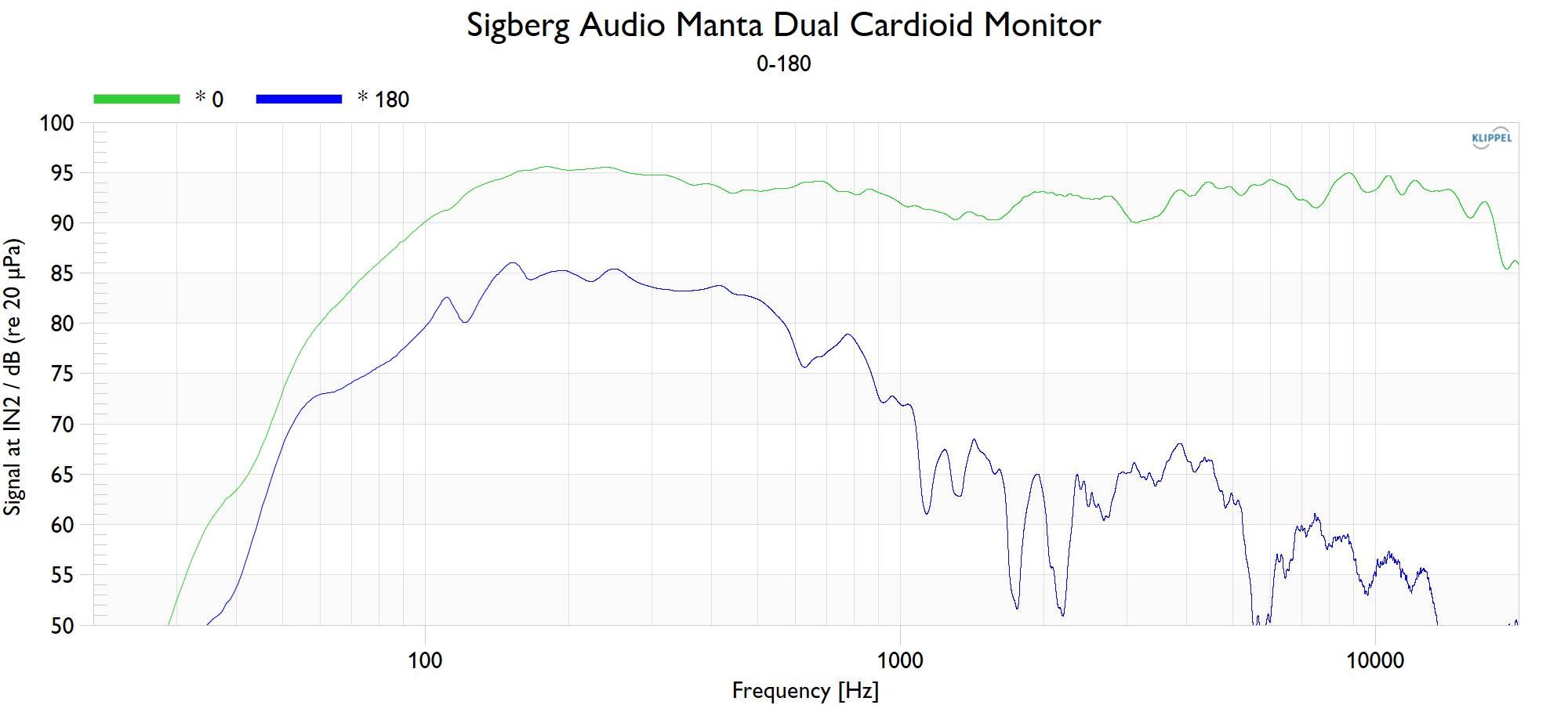

Here's on-axis vs 180 degrees. The 180 degrees curve is now more even in the 100-500hz area than earlier, and the effect is good in the entire band. With the "entire band" I'm referring to ~50-5,000hz. Above that the dispersion is very narrow even in regular speakers.

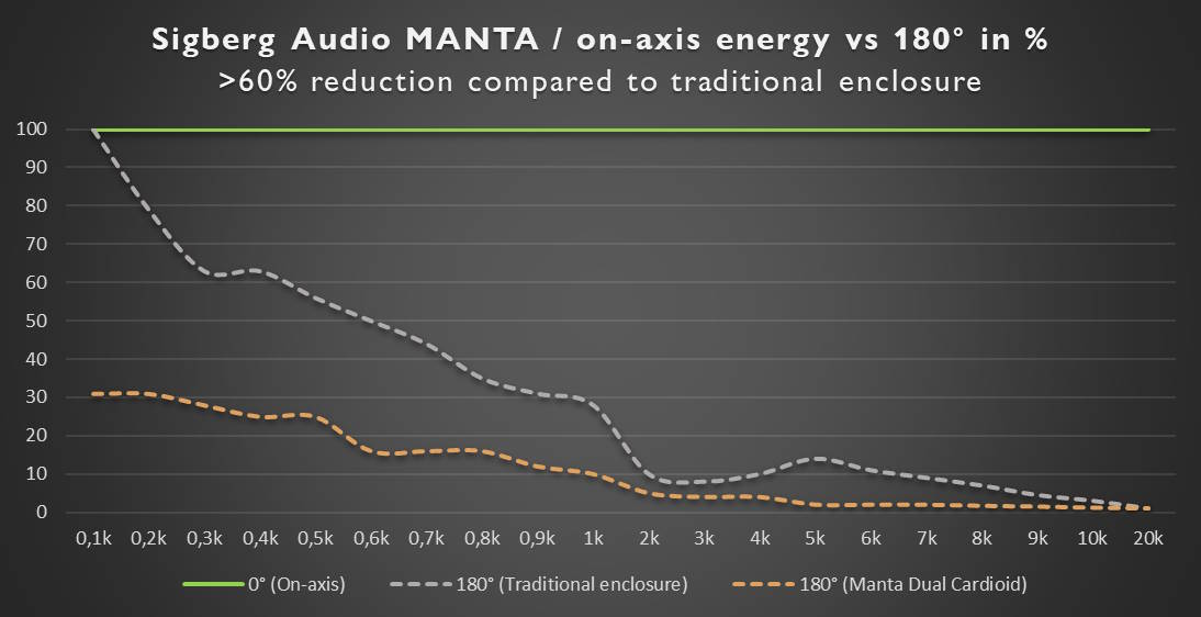

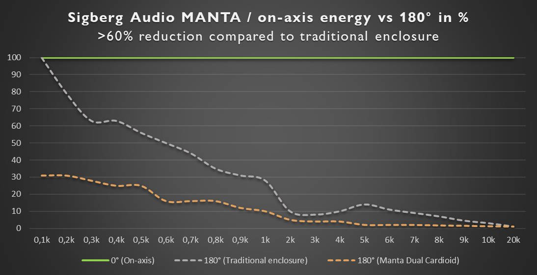

What does this mean in terms of energy into the room? In the previous iteration I claimed a 30% reduction in energy at 90 degrees, and 50% at 180 degrees compared to a traditional speaker. This is now increased to >40% at 90 degrees and >60%(!) at 180 degrees. The comparison speaker is the average dispersion of three different speakers with similar baffle size.

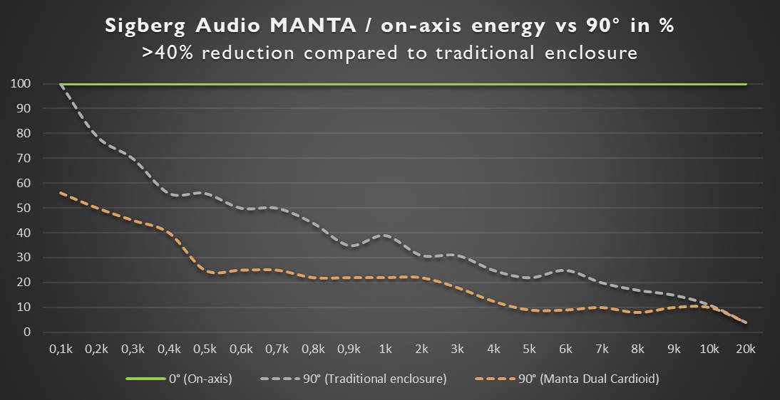

In summary: 40-60% of the reflected energy in the 90-180 degrees area on both sides of the speakers are removed at the root. :D

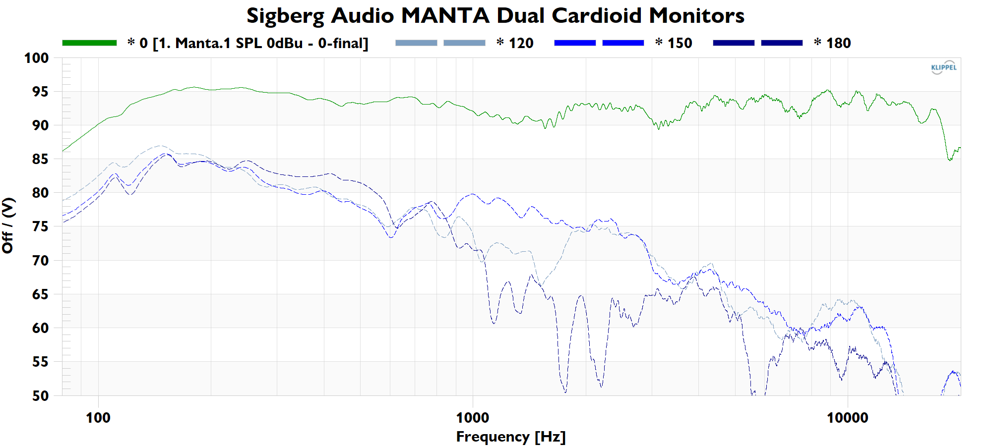

Here's 0-120-150-180 - As you can see even behind the speakers it's mostly quite even, but there are some disturbances above 1khz especially at 180 degrees. But at 25-30dB attentuation, I can assure you this is not a real world problem.
That is n interesting and informative graph. Interesting that you claim that steep reduction way off axis increases image depth. That certainly would chime with my experience of speakers with rear and upward firing drivers. To me they have always sounded an absolute mess. I note that some lunatic has bought the Mirage name from Klipsch. So I expect to see a resurrection of a line with speakers firing from strange locations.
