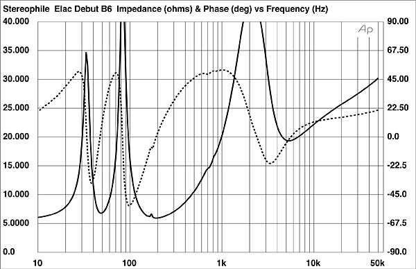

By the way, Stereophole measured the B6, you B6.2 should be similar. Below is the impedance/phase angle vs freq graph. Your AVR will definitely be happier if you set them to "small" and XO at 100 or even 110 Hz. Ask
@AcuDefTechGuy about why he set his speakers (bigger than yours I assume..
) to small.
https://www.stereophile.com/content/elac-debut-b6-loudspeaker-measurements
