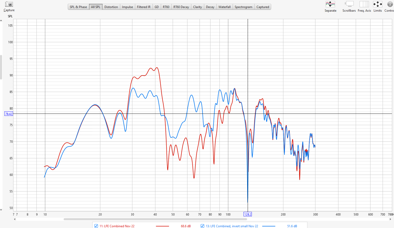

The measured response is largely the room. The sub probably measures OK. The dip in the response at is probably the distance difference from the port to the woofer, or maybe the port is over-represented. If you want to be sure, do a near-field measurement of the port (like 1 or 2 inches) and then a near-field of the woofer. That should at least tell you if one of them is misbehaving.
Did you measure that sub? Gotta link?

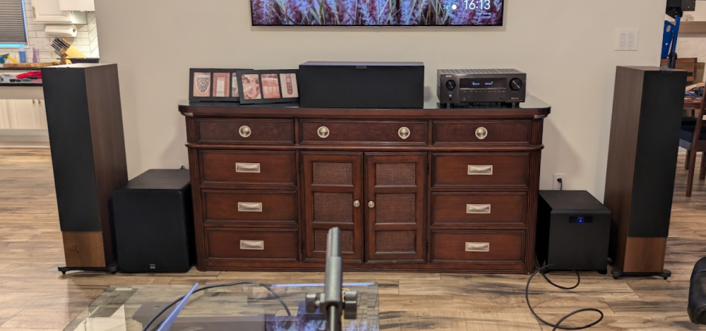

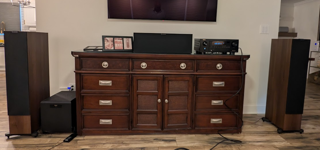

So you moved the better speakers to the front of the cabinet to avoid reflections?
The new speakers' fronts are slightly in front of the cabinet, and at the outer edge of the wall. They are 10.5" off the back wall, KEF says something like 9" minimum, and recommended I stuff the port with their provided paper muffle (which I did). The new sub is about the same width as the old so should fit i the same spot, but unlike the old which is downfacing will face outward, so won't be in a cave of sorts from the furniture.
The center is right at the front edge of the glass top.
I may try putting the sub outside the towers, which would look better, but the seating in the area is at or somewhat outside where they towers are now, so that would make the sound at the outside seats worse, I think, if they are put in closer. As it is, they are a bit of a road hazard of someone going around those corners.

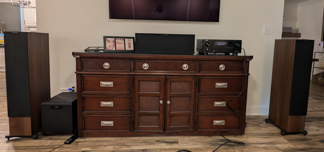

In this shot the console is probably 4" further forward than I hope to get it, I've got some balled up sub cable (it's like 30' and really heavy) that I need to fix by buying a new coax cable, which this is a good reminder of, thanks.
Advice welcomed.
Advice welcomed.
I think you need to ditch the remote sub idea with the all in one unit and when the new sub arrives and after best placement is determined get a separate RF unit if necessary. Low frequencies and rooms are the nightmare that ruins good sound and I wholeheartedly commend you for the effort you have made, not many would have dove head first into this hobby at the beginning of their journey.

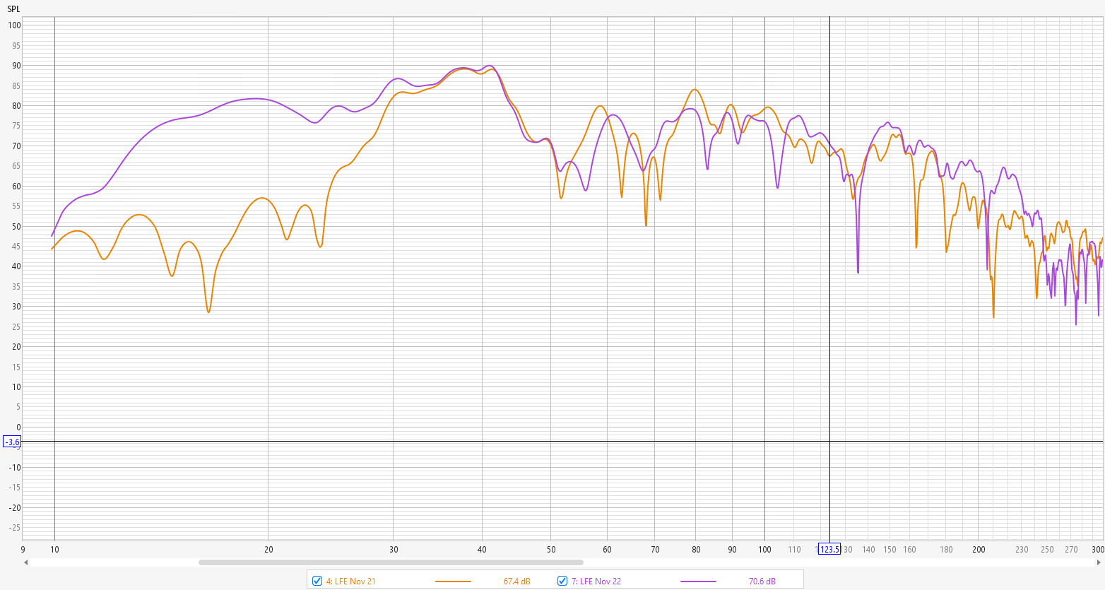

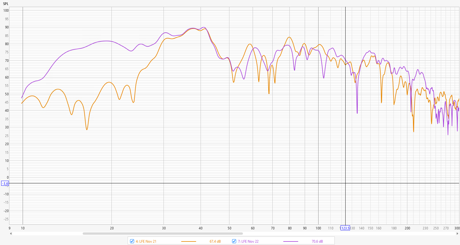

So for those waiting with bated breath, this is the SVS in the same spot, everything defaulted, pure direct , no attempt at tuning anything.
The very low was clearly inability of the old speaker (orange) to reach low. The dips beyond that would appear to be the room?
I'll spend some time working with it, but the similarity makes me think the old one was "not that bad" (other than below 30hz), and should I actually just keep it and use both? (The 3800 can drive four independently with separate eq for each, as I understand it).

Pure direct with 2ch generally doesn't use the sub, can you elaborate on the setup?
Your avr can set level/delay for up to four subs, but they are eq'd simultaneously if using Audyssey.
Generally I'd at least want the subs to be fairly similar in performance, but prefer identical.

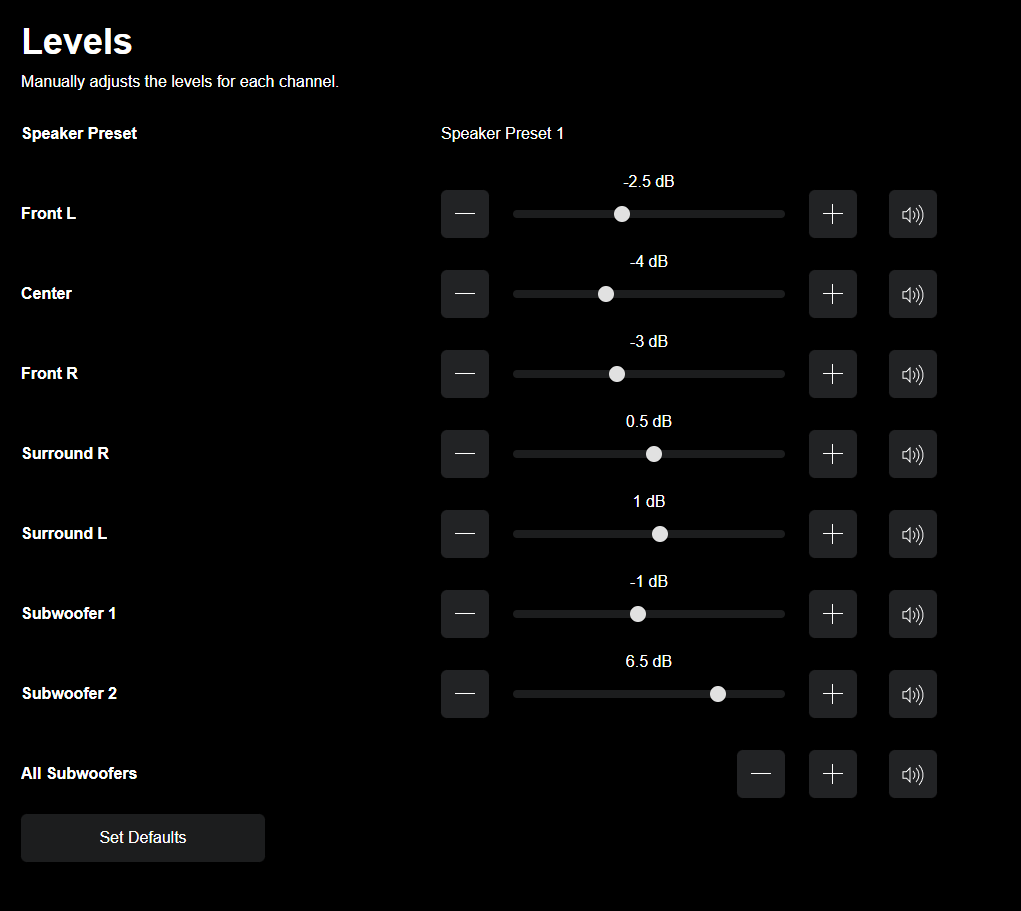

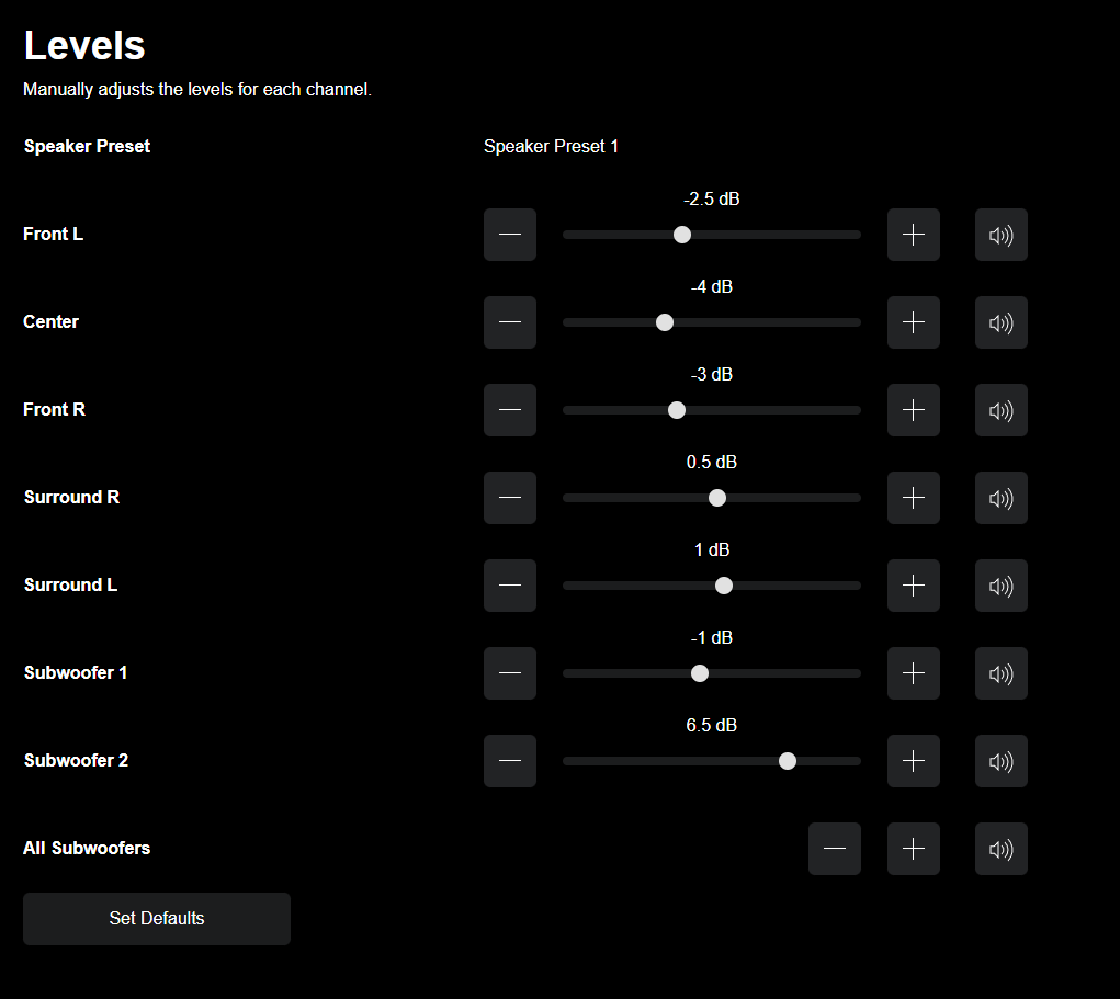

But there's a manual speaker level adjustment that I thought was on top of Audyssey. This one. You can't do an frequency specific change, but I could balance the relative power of the two subs, and this doesn't turn off Audyssey's curves, right? Below I've balanced them to the ear with whatever noise it plays (i.e. not sure at what frequency that concentrates).

That's just a level adjustment, and you can alter both level and delay (distance) on top of Audyssey. Using an Audyssey setup with different speakers/subs/room/placement are going to require you to re-run it. I'd simply start with Audyssey, and recommend the $20 MultEQ Editor App for a bit more control/flexibility of eq you don't get in the avr alone before spending bigger bucks on MultEQ-X or Dirac.

With both subs showing the same dips 50 & 70 Hz regions I'd say that confirms what several suspected earlier - that it is the room and/or placement within in.
In your case, with the older sub not really useful below 30Hz and the SVS doing strong output below 30 Hz (way more than I would have expected really), I would probably look into trying to solve the 50 & 70 Hz issues with the old sub. The only real option for dealing with that behavior is moving it elsewhere in the room. So take the old sub and start putting it in different places around the room and re-measuring it (you can probably unhook the SVS while you do this). Once you find a spot where the behavior in those two regions is more smooth and even, leave it there. Then reconnect your SVS and run the sweep with both again. You may fine that they start cancelling each other out at certain frequencies now, so this where you start to use the phase adjustment on one (probably the old one if the SVS with the mains is likely to be closer in phase with them already). What you're looking for is a phase setting where the two subs behave more additively rather than cancelling (so output goes up at the various frequencies, not down).
Don't get too worried about excessive output at certain frequencies. You can deal with those fairly effectively with room EQ. You're trying to eliminate the drastic dips below the reference/average level of the rest of the sweep. Room EQ can help with dips, but only a little bit. It is much more effective at removing excessive peaks. So you can use that to play to the strength of the tool(s).
Essentially what you're going to do is use the old sub to fill in that 50 & 70 Hz range the SVS is having trouble with where it is. And then let the SVS handle the deep bass as it seems to be doing very well with. Once you run Dirac or Audessey, they should hopefully blend well enough.
Alternatively, you could just ditch the old sub and do the placement crawl with the SVS by itself. You can probably do better in those regions but you'll likely find that it gets worse at others. This is why multiple subs are often recommended as it makes it easier to get even coverage across the whole spectrum.

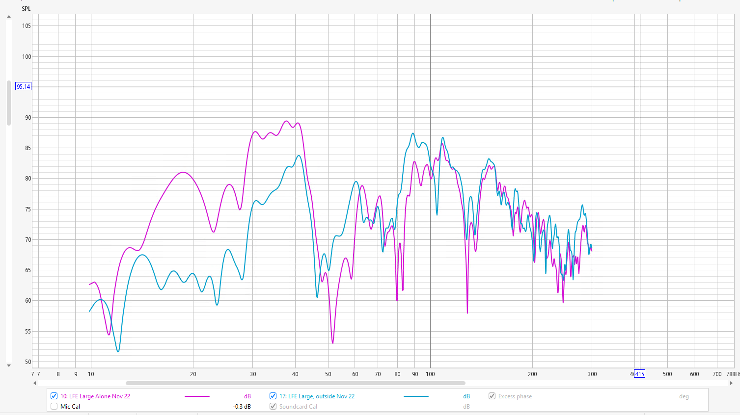

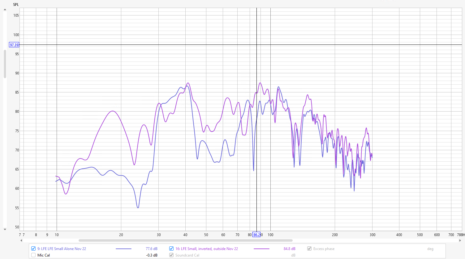

I don't know if anyone is interested in these things or not, so let me know if I should stop, but here is the small sub in between the tower and the cabinet (blue) and outside (purple). Quite a difference. Not great, but an improvement I think. The big sharp dip about 84 is just gone.
And here's the new SVS sub outside (purple) and inside (teal). I am surprised it made that big of a difference what was beside it, since it's forward facing and ported on the front. I guess this is better though. Wonder if I've made my towers worse.
One snapshot only tells so much. Knowing more about setup before measurement, and how many measurement points you're doing might be more interesting. Just measuring in one mic location only says so much.
Yeah, though trying combinations of speaker settings AND combinations of positions is difficult, so I was measuring at the sweet spot seat.

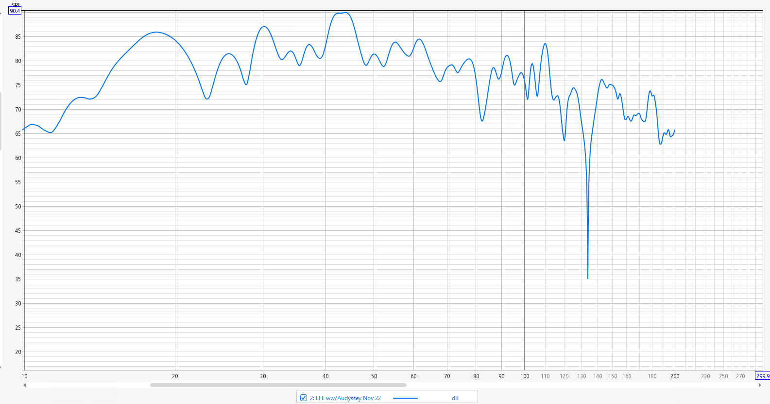

From that position this is the combined subs sweep going through Audyssey (I was surprised, it tested each sub individually when it ran, this is the in-AVR versinon). Much flatter than I started. Not flat, but better.

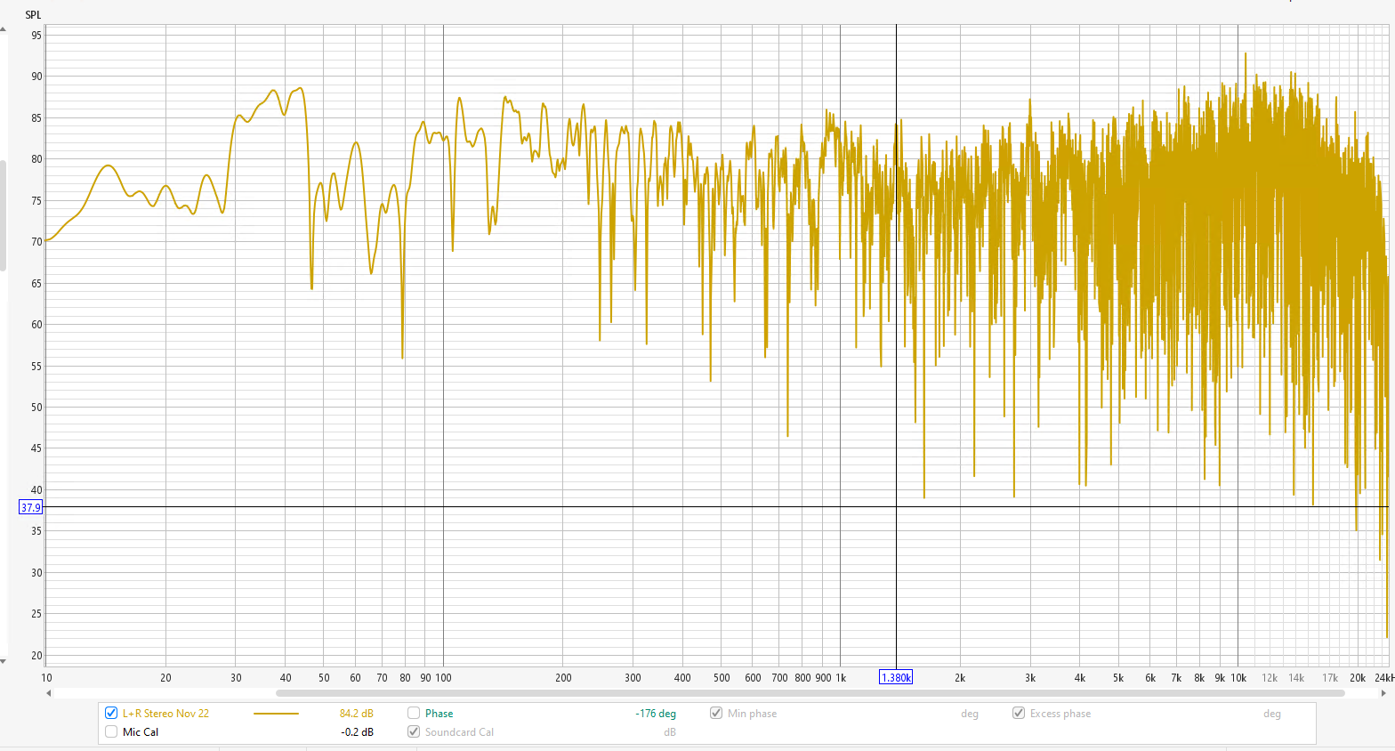

I'm not sure if this is a valid test or not, but it's a stereo only output sent to it thru L+R with multi-channel on (which I think does a lot of processing to split it up and send it to various speakers). Not sure if it's good or bad, but it's also kind of sort of flat-ish for all 7 speakers combined.

One difference between the two graphs is that your REW graph has very low smoothing (1/48) which is almost none. The Audessey one is notably higher smoothing, either 1/12 or 1/6. That will account for some of the visual difference.
Neither has any smoothing turned on. Someone complained when I posted a graph with smoothing.
