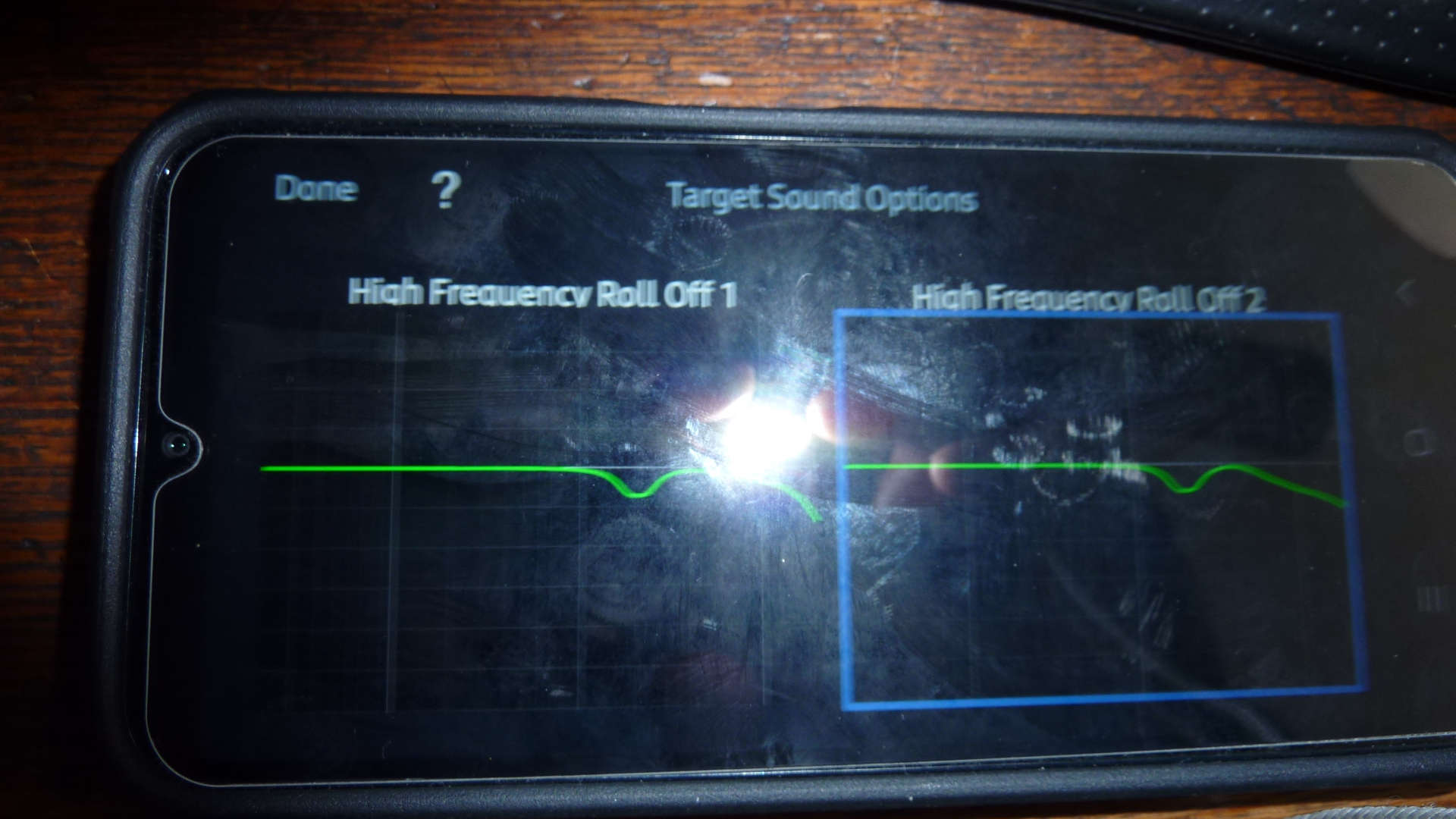

2. I don't understand the High Frequency Roll Off pics in the attached "High Freq Roll Off2" pics. I don't see any scale, so where does this Roll Off sit ? Is this for ALL the speakers ? Why are there Two High Frequency Roll Offs? Should I try to compensate for this, and if so, how?
I am not sure if they apply to all channels or just the front channels, it is best to ask Audyssey that question directly. You can try both roll off curve and determine which one sounds better to you. You an also choose flat with the app if you don't like the roll off at all.

Also, OP. The two different roll offs are, one is steeper and one is shallower with a gradual roll off. Steep can help with bright speakers if you find them too harsh.
