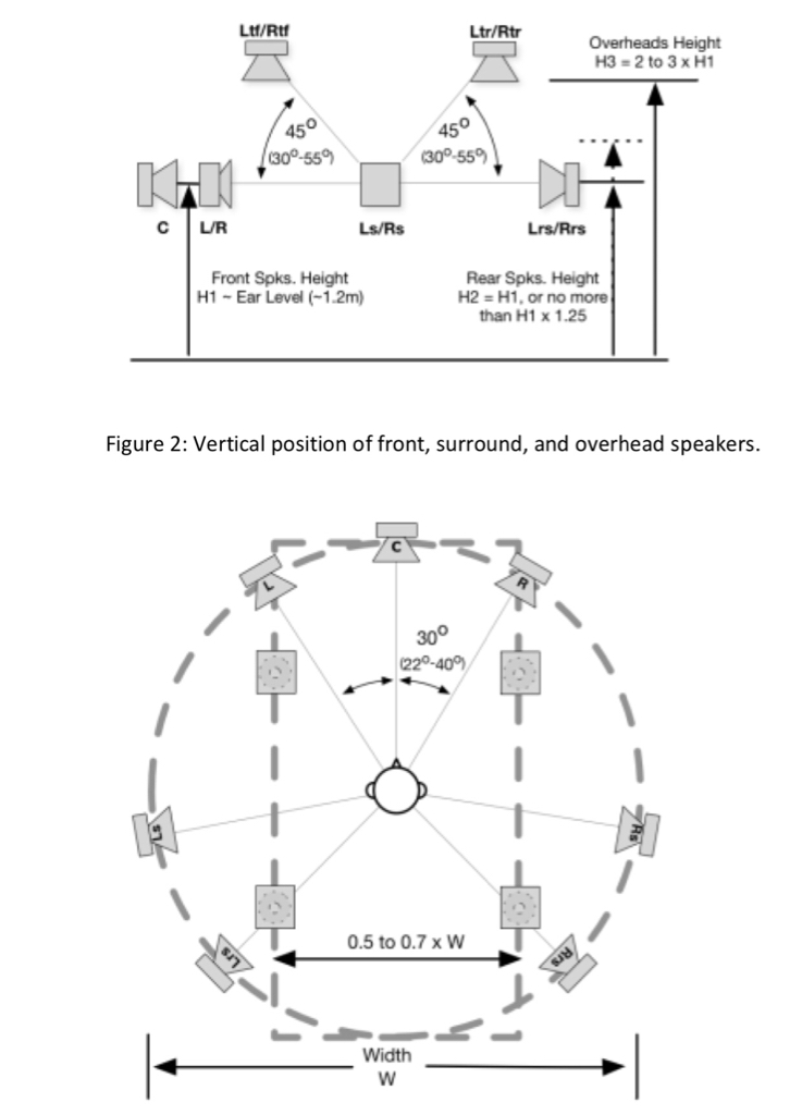

I’m about to do ceiling Atmos as well w/front wide. FYI: I had reflective atmos speakers and I didn’t care for them. I have heard ceiling Atmos and it was worth it I feel, especially if I can replicate that experience. Good luck. A schematic of the room would be helpful for feed back though.
One of the problems is that your surrounds are too high to work correctly with atmos. The surrounds should only be 1.25 times the height of the mains, and also at least 3’ of difference in height between the surrounds and atmos speakers. If you can get the surrounds down around ear height(40-50”) it will be much more successful.(if not, then I might not bother. I agree with the advisor that 5.1.2 will be better than 7.1, but keep in mind nobody can guarantee anything in the way of your satisfaction. I disagree that you’ll only have to add the 2 atmos speakers since one of the reasons it works is the differential in height. Unfortunately you’ll have to be the judge of that. Also, as far as 7ch anything, atmos or otherwise, you’ll need room behind the LP for that to work. Can’t tell for sure, but it looks like you have some options. Curious how you like the polks for mains? I have a pair in one of my rooms.

Step 1 - Add rear surrounds to make it a 7.1 system.
Step 2 - Add the left and right top front overhead Atmos speakers to make it a 7.1.2. I recognize 7.1.2 and 7.1.4 speaker placement recommendations are not the same, but I would place them according to the recommended 7.1.4 layout knowing it will eventually be a 7.1.4 system.
Step 3 - Add the left and right top rear overhead Atmos speakers to make it a 7.1.4
I would probably use in-ceiling speakers for the rear surrounds (Step 1) and the rear overhead Atmos (Step 3) I would install both sets in the soffit that you see directly behind the couch (see pic in original post).
What I am seeing/reading from blogs and Youtube videos is, although we all want our speakers to be in the Dolby-recommended positions, there is SOME forgiveness.
Maybe with my basement layout not being ideal, especially the area behind the couch, I should just consider a 9.2 system (i.e. 5.1.2 atmos)?
I'd be interested in hearing anyone's thoughts on this.
enhance
Not sure if that image is from this guide but it’s worth reading.
https://www.dolby.com/us/en/technol...tmos-home-theater-installation-guidelines.pdf
If you can match the layout as seen from above, that’s half the battle. You are right, there is some forgiveness in placement, but the problem is atmos isn’t just sounds over your head. The 3d sound comes from the interplay between the speakers above, and at ear level. It’s the same way you get a phantom Center image with stereo. If they’re all on the same horizontal plane, you won’t get atmos, you’ll just get a bunch of sound overhead.
The top image here shows the guidelines to calculate from. Here is where there’s room to play with horizontally , but definitely not vertically. Don’t get me wrong, I’m not trying to pee in your Cheerios. I’d just hate to see you spend a bunch of money for little to no improvement, and IMO it’s a disservice for anyone to tell you putting all speakers at ceiling height will work for atmos. If you really don’t want to bring your surrounds down, I would consider 2 atmos in front or a pair of prime elevation speakers in front and upgrade mains.

I've given it allot of thought to what you said combined with some other conversations I've had with friends and I made the decision to pull the reigns back. As I stated in my initial post, what I have now sounds really good to me and others that have experienced it. Today I ordered the Denon AVR-X2300W from Crutchfield. For the price point of $450, I think it has allot of great features and gets very good reviews.

Pulling back can be extremely difficult. Especially when you’ve sold yourself on the idea. Been there, done that... And who knows what the future will bring? Maybe a new place, or room orientation will be a possibility in the future and you could do atmos then. Having a system that you currently enjoy helps for sure. Good luck!
