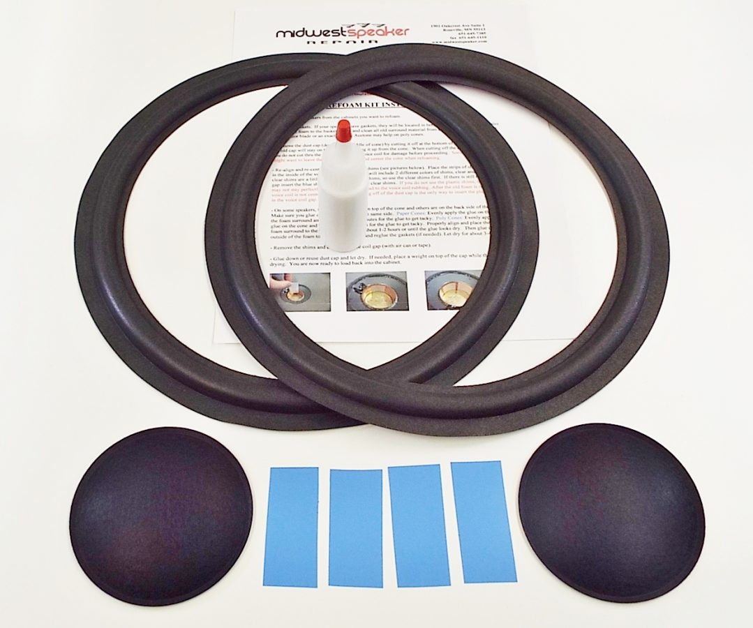

You can repair the woofer cheap with a refoam kit. As long as the other components still work fine, I would not spend the time to "upgrade" them.
A refoam kit would need to contain surrounds with the same compliance as the originals. I strongly doubt that some are still available. If the replacement foam is different, then the performance of the woofer will be affected because of its changed Thiele/Small parameters.
IMO monies should rather be used for new speakers.
I've used Midwest foams to repair vintage speakers. It's likely impossible to find a modern driver that will drop in and work correctly so your best bet is to repair the existing woofer's.
If all the drivers are functional you should look foremost into crossover capacitors... then restoring the cabinet. Post pictures of what you already have.
