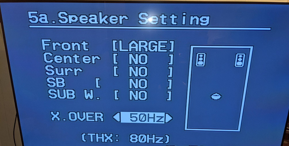

For an expensive speaker set - the document was sparse (to be super kind). I sent the attached diagram to RBH, and the good folks there told me that I had to have a set of jumper cables from the bottom cabinet to the top (nowhere in the documentation) to set it up. Now that its all up and running while the sound is sweet, the bass is nowhere near where it should be for 4x10" drivers. My old JBLs with a single powered subwoofer provided chest thumping bass (while not being flabby) and I am wondering if I set it up correctly and that leads to my question.
The Question
At the receiver I have set the L/R speakers to large, subwoofer to None, and crossover frequency to 50Hz the lowest setting available on the receiver. Yet the speakers output just OK as far as both sound and bass is concerned. What else should I be trying? Thanks for your time.

Maybe I missed something. What do you have a crossover at 50hz for? You should be running those speakers as large full range. No crossover.

Thank you for your reply (I am no audiophile - atleast yet! so please be gentle).
Let me check the receiver settings again, maybe I have a way to eliminate the 50 Hz crossover settings. I will reply back after checking it out thoroughly. Thanks again!

Maybe it is age of my receiver you can set the speakers to LARGE but you cannot remove the crossover requirement and it goes in a loop with 50 Hz being the lowest setting and no real way to remove it or set to zero.
Please see below:
Please see below: View attachment 44346
It seems the Pioneer AVR is not letting you play Full-range. Is there a Direct or Pure Direct mode on the AVR? That might force full-range mode.
Otherwise, it might be time to get a better AVR from Marantz, Denon, or Yamaha.

I would try and completely reset the unit to factory defaults. Then go back and make sure "NO" is selected in the subwoofer section in the speaker setup menu. Having 'NO" in the subwoofer speaker menu should defeat the crossover. Play with the unit in "Stream Direct". See if that helps. That unit has a lot of different setting possibilities and something is not passing the full-range signal to your mains. It's not the speakers...
