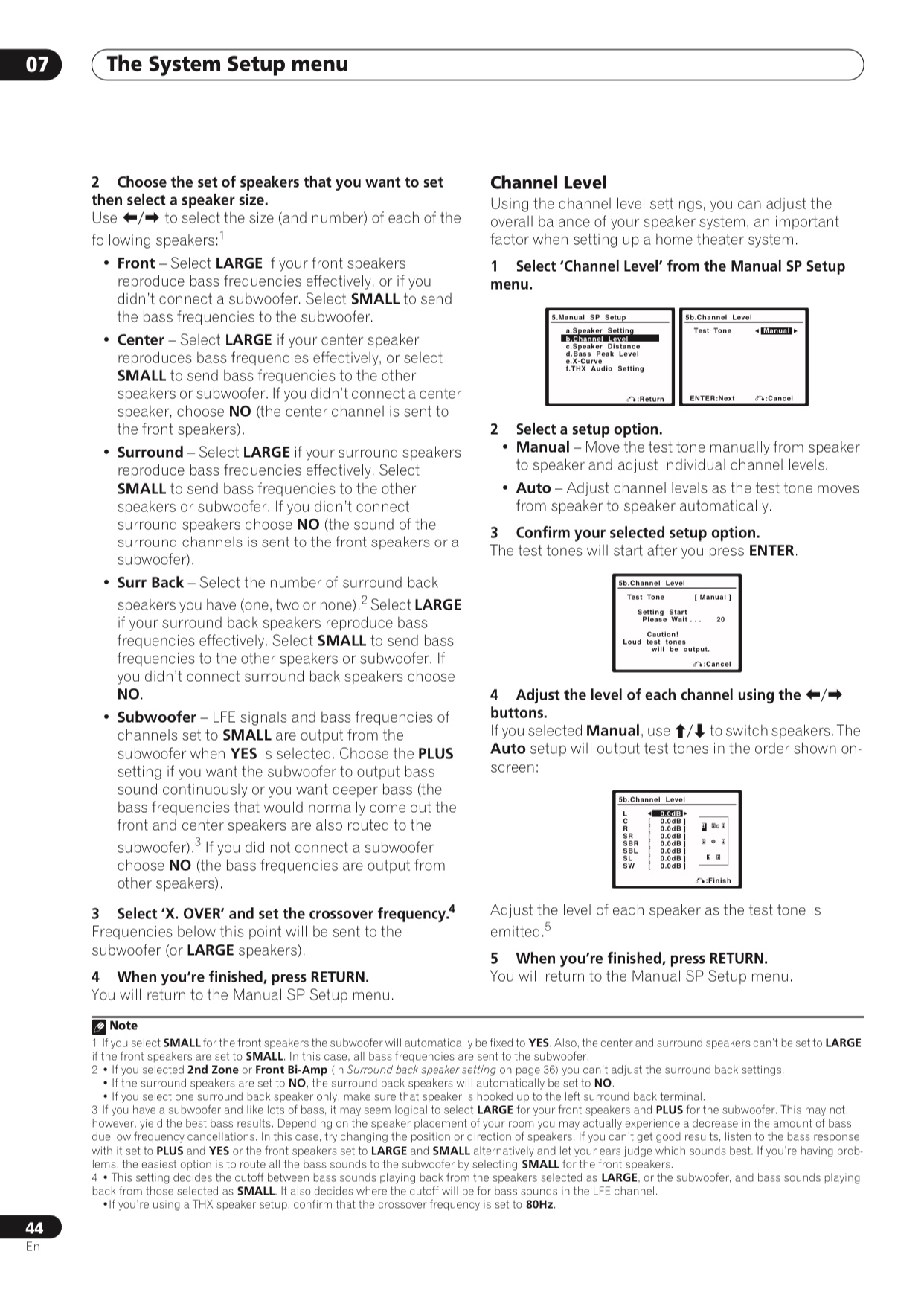

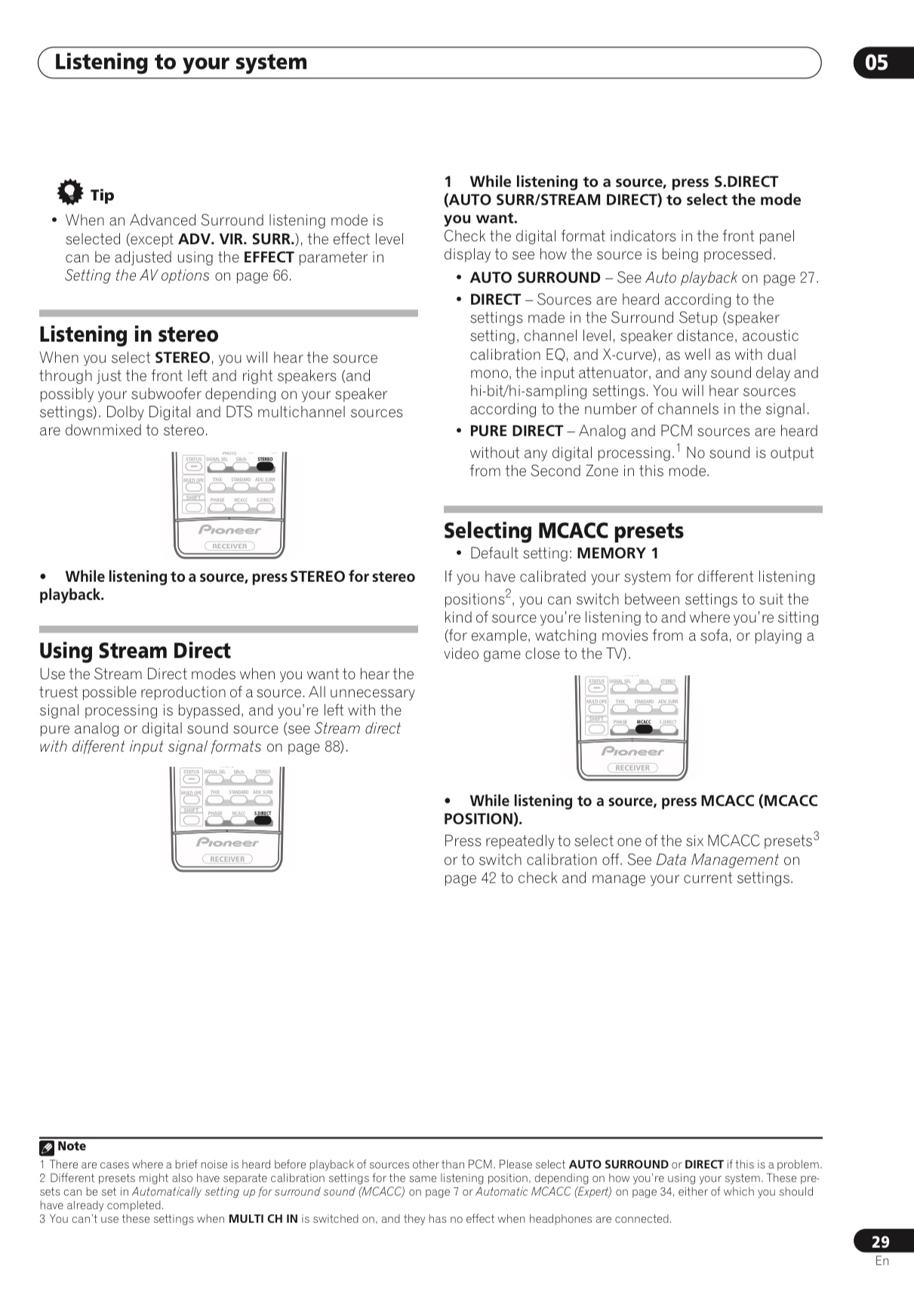

The Pioneer is sending a full range signal to the front speakers. The crossover is present and would apply to any speakers set to small. The signal below the crossover point would be sent to the front speakers. The front speakers are not being limited by the crossover setting, though the way it is displayed doesn’t convey that very well. You can select “Stream Direct” to bypass processing of the signal. If you still can’t get the sound to your satisfaction, maybe a 2080 will suddenly appear out of Acu’s rumpus room.;)
View attachment 44370View attachment 44371
Thank you for this awesome research the sound is really good in stereo in Pure Direct mode. Once I go to the multi-speaker mode (did I mention I also got a pair of RBH SV-61R for the surround sound - only my center channel remains as JBL) the bass does steeply fall off.

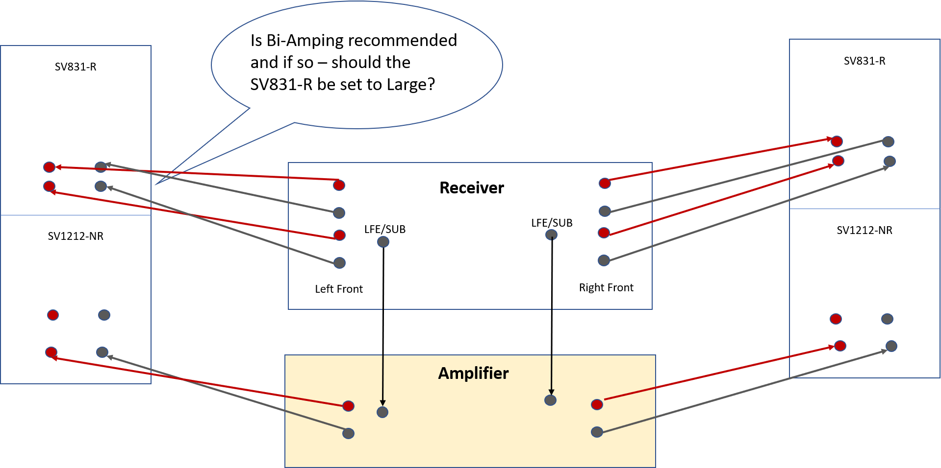

I found this video from Gene on Youtube, he has tried to help but seems to speak well over the heads of mere mortals. I tried to decode this video and created this diagram from my understanding of how to set up RBH SVTRs which starts around 6:50 in the video. Could one of you folks please take a look at the video (starting 6:50) and my diagram and let me know if I am understanding it correctly. Thanks in advance.

The speaker outputs from the receiver should go ONLY to the 831. You need to unplug the jumper from the 831 to the 1212 if you have a separate amplifier feeding the 1212 via the LFE/SUB output. If you’re going to run it as a full range then you would leave the jumpers in and just go from the receiver pre outs to the amplifier and then from the amplifier to the 1212 which will send the 831s signal via the jumpers.

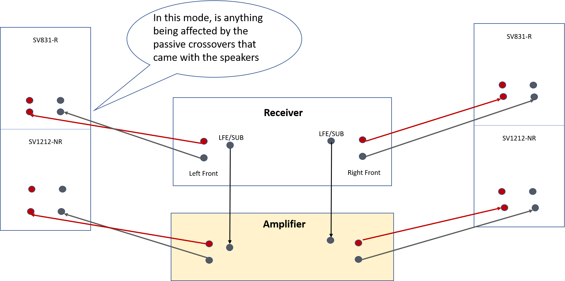

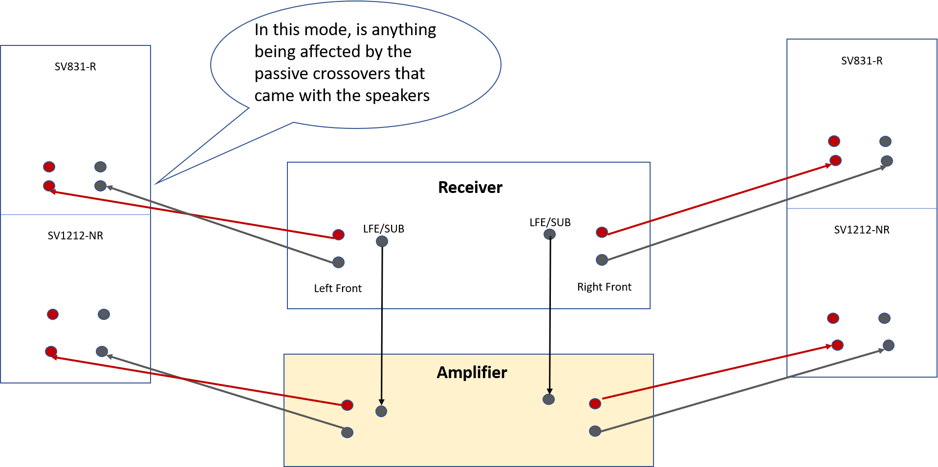

Thank you ParleyW and AcuDefTechGuy. I am visual so I drew up what I think the two of you are saying, please do take a look - I came up with watching the video below and feedback from flyboylr45
Configuration 1
Here we go Rcvr LFE to AMP (and I am guessing any amp will suffice) and AMP to SV1212-NR and from Rcvr speakers to the SV831-Rs. Question is since I got the passive crossover will this be an incorrect way to do things. Should the SV831-Rs be set to "Large" or "Small" and the crossover frequency at 80Hz
Configuration 2
Just a variation of 1 above with potential bi-amping of the SV831-Rs. Again the same question with respect to passive crossover, size of speaker and crossover frequency
Configuration 1

I would go with Configuration 1. It’s okay even if the SV1212NR has the internal XO.
I set my SV831 to Small and XO to 120Hz, but I think 80Hz or 100Hz will work fine.
I don’t see any benefits to bi-amping the SV831, but it does look cooler especially if you have cool cables. :cool: :D
