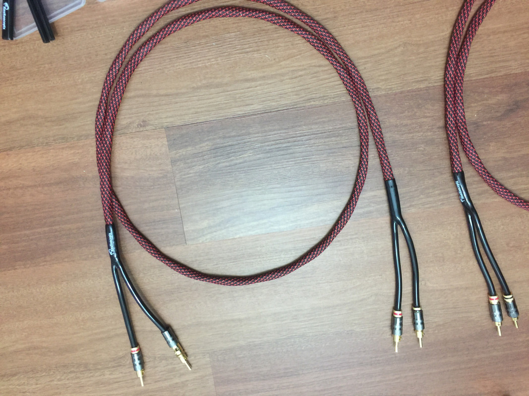

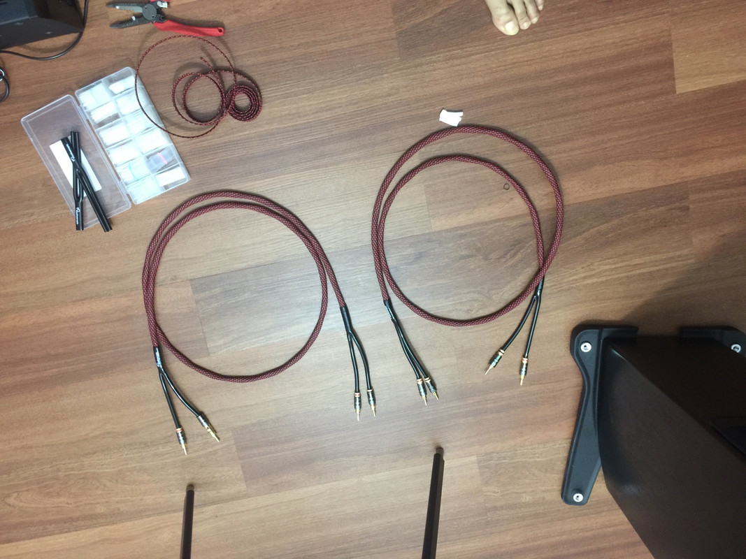

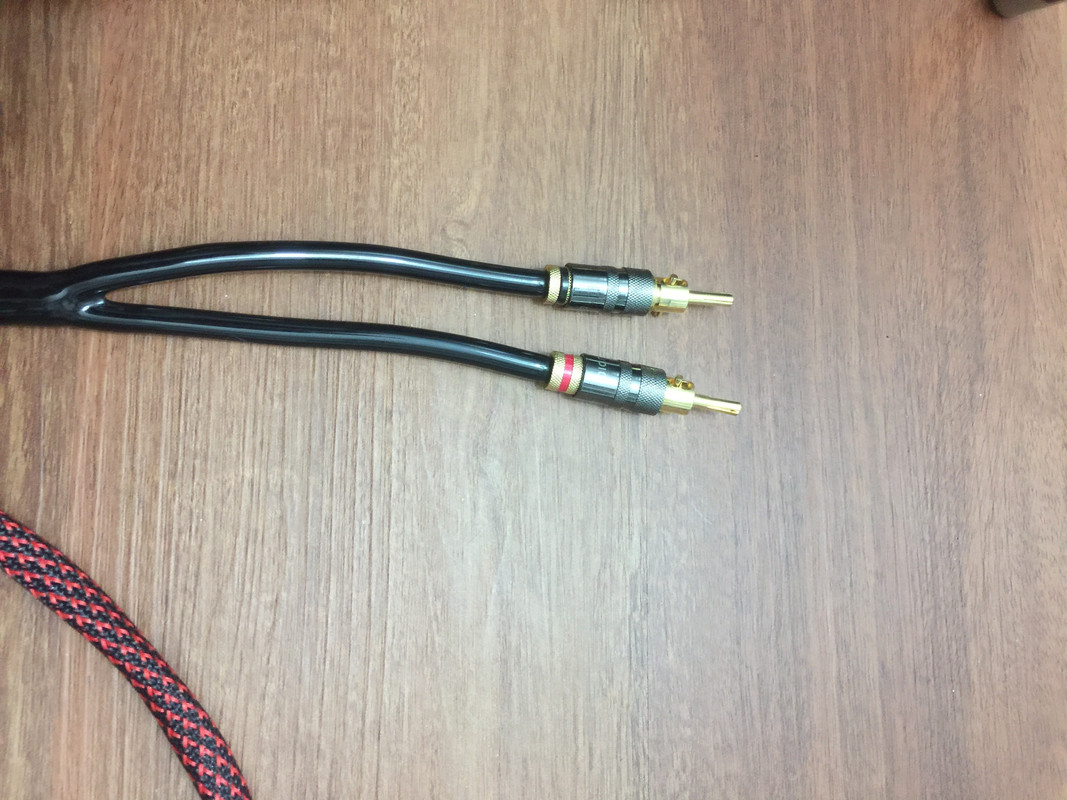

Well finished up the 10 gauge last night. Used Blue Jeans 10 gauge, Amazon sourced GLS locking banana plugs, KnuKonceptz pants, some shrink tubing and Flexo PET black/red. Total cost not including the shrink tubing was $67. Looks pretty good to me.

@Snakebitten They look very, very nice! Wouldn't mind these at all. I have bookshelves so I plan to get angled bananas to give the cable a free fall without tension on the banana.
Your binding posts are low so these make sense. Don't forget to elevate them!!:D:D:D

Thanks Killdozzer. Yeah I will elevate them with some wood stanchions, thanks. I was thinking of soldering them as these banana plug wire channels are quite large even for 10 gauge. The screws will screw right into the channel and fall out with any gauge less than 10 gauge. Even with the 10 gauge its a bit iffy.

What negative effects do you think all of the soldered joints in the equipment have on the sound?
BAD solder joints make a difference- good ones don't.

Now I have to ask are we still ironical? If not, soldering not only doesn't take away, but makes probably one of the biggest surfaces at the point of connection. Copper is supposed to be a slightly better conductor, but that is rectified and then some by the fact that solder adheres to every strand and soaks it in and out and washes over the entire inside of the banana. Furthermore, once inside solder, copper significantly drops in accumulating patina. So, clean for a longer time.

There's no benefit to soldering. Those locking bananas will pull the speaker down before the wire comes out or before they pull out of the plugs. I know this from experience and that's why I don't use them on my speakers, only on the amp side.

Oooh, pretty! Nice work. Startup an "Audioquest" knockoff company. Even if you charge 50% less than they do, you'd make a killing! :p

Well I thought about soldering only because the banana plugs wire channel is so large that even the 10 gauge wire is floating in there. The set screws the plugs come with can screw down until they pop out in the wire channel of the plugs. Only solution is cutting of a little extra insulation and bending the wire down to make it fatter then the set screw will tighten and not come out the bottom end. Or I could drop some solder in the channel and then tighten down the set screw if needed.

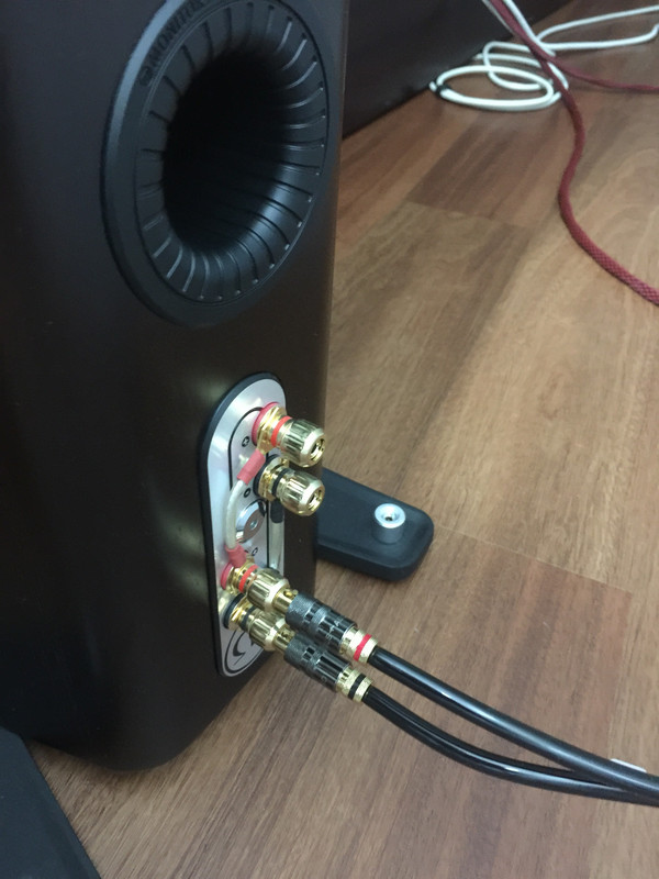

Hold on a second, I took a second look at your binding posts. What gauge is that jumper between the terminals? Or are you going to feed the highs and lows the tenner and remove the jumpers?
