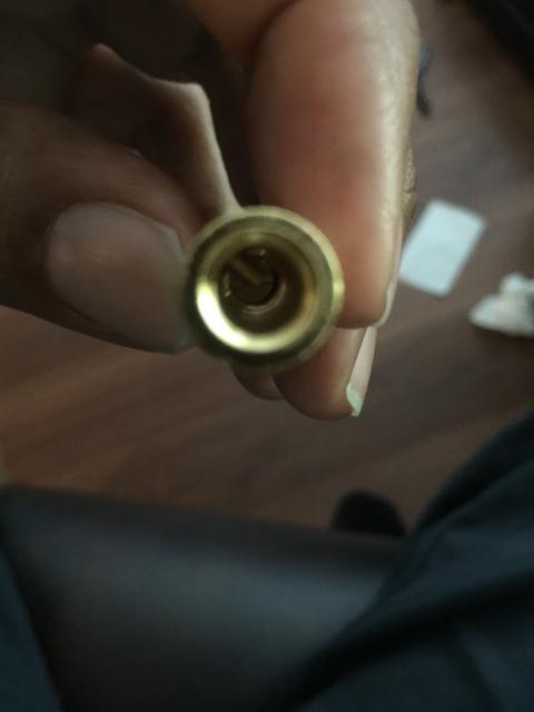

Lovinthehd I did indeed leave insulation for the lower down set screw. The opening is really that big that the short set screws go all the way into the channel with barely enough thread left to securely hold it tight on the 10 gauge insulation. It just screws right out into the channel on the exposed upper set screw part. Hence the doubling I did when I first put the cable together. Even that eventually settled and gave way.
EDIT: Just reread your post. Now I fully understand what you said. No I only did the insulation on the lower set screw. Will try this then. I guess just the 1/4" of the wier touching the upper portion is enough. I will still have to tape the wire insulation though as the lower set screw did not hold on the insulation. Thanks for that. I did not know there was a video on the plug. That would have saved me all this trouble.

Just watched it. Thx. Then I did exactly like he did. The top screw is on the bare wire. The bottom screw is on the insulation. The way I read your post it seemed that both set screws were to be on the insulation and the 1/4” exposed wire would just be touching the upper portion of the connector.
I have the same type screw driver. Interesting that it works on the video. But I can tell you first hand it’s not as secure on my 10 gauge as that. If you look up some of the comments on Amazon you will see some having to source longer set screws to make a tight connection. I’ll see if I can take some pics or a short vid when I get some time these next few days.

I just took a look at it again. With the tape I think I have solved the lower part issue with the insulation and the lower set screw. But the bare wire part the strands just widenout when the set screw is screwed down and the fall into the channel. Solid wire would be much better with this. So I may have to just solder the exposed tip so it’s just one mass so the screw can’t spread them so it stays fat enough to keep the set screw tight in its threaded chamber instead of coming out the bottom.
Anyway I’ll get at this later in the week. But at least I have some ideas that should workout.
Just to give an idea of the size of the ID of this connector vs Belden 10 gauge:
Set screw all the way through and barely hanging on by a literal thread. On more slight twist and it falls into channel. Look at the gaping space beneath that screw:
