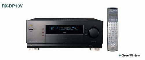

I have a pair of Bose 601's I got free from Bose when I sold home audio and video back when Sears was still around. Being I got free 601's I bought a pair of 301's and the Bose center channel. I know Bose is expensive for what you get and nothing like the stuff from the 60's and you have the whole Bose concept that audiophiles question. I also have a 12 in sub that was connected through a
THX Ultra 7.1 Home Theater Receiver JVC RXDP15B REF.
Its a monster of a receiver and weighs 49 lbs.
