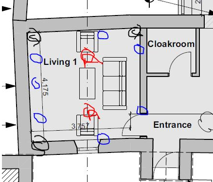

So I'm definitely over the idea that an overly large TV could dominate the room; that was just a weird hang-up I had, and now that I see the outline of an 85" TV on the actual wall, I don't think it would be problem. @afterlife2 Would love to setup an acoustically transparent screen, but unfortunately Mrs TheRealOC is set on the TV option :D I wouldn't be against moving the sofa closer to the TV either; the reason the sofa is right up against the wall is because this TV Size to Distance Calculator recommended sitting 9.1 feet (2.77 metres) away from a 65" TV, and in this room, that's almost as far away from the TV as it's possible to sit. :D
Interested in how far everyone thinks the sofa should be moved forward, and whether this would affect the decision on whether or not to have rear surrounds?
@j_garcia @AcuDefTechGuy Also interested in whether going with a 5.1.2 or a 5.1.4 is compatible with @-Jim- 's suggestion of five bed level speakers? Are Atmos speakers normally considered "bed level"? Currently, the two Atmos speakers are positioned halfway along the length of the room - If I added a second pair of Atmos speakers, would the front Atmos pair be positioned 1/4 way along the length, and the back pair 3/4 of the way along?
For a small room, I would just do 5.1.2 and put the 2 in-ceiling speakers directly above the couch.

No need to apologise; I have no problem with bluntness. I freely admit I have zero hands-on experience in this area, but I'm not just taking advice from one person (hence this post :D ) and it was actually @gene dellasalla who recommended the 7.2.4 setup in the first place - although that was a long time ago, and it was only on the basis of this architect's blueprint - if we had the conversation when I actually knew the final studded-out dimensions and shape of the room, it might have been a different story. But I'm definitely open to hearing different perspectives and trying to make an informed decision.
Regarding the in-wall speakers, I am aware that they require research and proper installation to achieve optimal sound quality. And I also understand that this room size/shape is not ideal for a home theatre setup, but I am just trying to make the best of what I have.
Also appreciate your concern for the cost and practicality of the setup, but I assure you that I am taking those factors into consideration as well. The AVR I own currently is an oldie - it's a first-generation Atmos receiver from Yamaha (RX-A2040), but I am researching different amplification and source options, and I am open to making adjustments.
Thank you for your input; hope to hear more feedback in the future :)

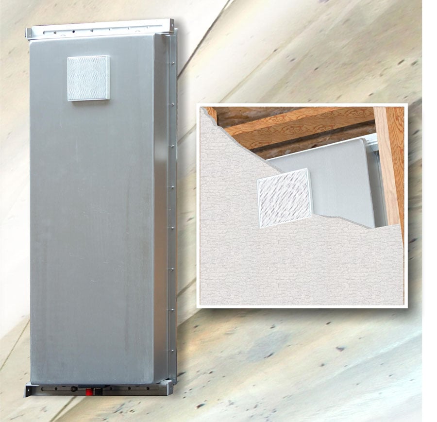

Quick update - all the pre-wiring is finished and just finished installing the subwoofer back boxes, which is pretty cool
Two at the front, two at the rear, both as low down on the wall as possible, back pair facing perpendicularly to the front pair
