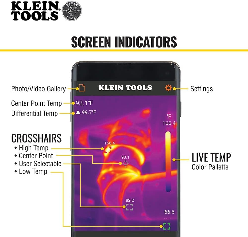

I don't know what makes imaging equipment qualify as "good", but for infrequent use, you can buy one of these from Amazon for $250. The price seems too cheap, but I don't know how much money is saved by using a phone (or, even better, an 8"-12" tablet) to provide the display and (I assume) conversion from camera output to image. Klein is a company I respect (though they may have been bought or otherwise changed their quality standards for all I know). Thoughts?
Klein Thermal Imaging Camera for Phone/Tablet
IMHO a "good" Thermal Imaging device is reasonably accurate, and can provide enough detail to pick out hot (or cold) spots easily. It also helps if it's simple to use. (The Pro stuff we used in my past life was not easy to use, but the results were certifiable to national standards at the time. Insurance Companies for the Industrial Clients wanted that traceability. ) The knocks I see on the Klein device is the resolution is a bit fuzzy (it'll look worse on a Tablet as the 100 x 100 resolution spreads out to fill the larger screen) and you may not like the Klein watermark that is on every photo. I certainly wouldn't buy one just to scan my Panel, and then get put away in a drawer.
Buying one of these cameras is sort of like Audio Equipment. You can pay a little to just get started, but cost wise it becomes logarithmic quite quickly as you move up the quality scale. So you need to find out what works for you. I'd just try your Infrared Thermometer / Digital Laser Gun and see how it goes if I wanted to do my Panel.
First I'd take a digital photo of the Panel with the cover removed so you could see the connections. (Shut off the main breaker) Then on a laptop, edit the photo using Snip or Snag-it (or something similar) to record the data as I shoot it on the photo in text boxes with the main breaker on for a while to allow any "bad" connections to heat up.
If you really want to try an imaging camera, you could rent one for a day locally.
I hope this is helpful.

I like cool gadgets and the infrared camera/software is cool stuff. If you told me that looked pretty nice, I might have justified it on the basis that $250 is cheap for a safety issue (but not as cheap as $0 for something I already have).
Interesting, where would you find such a rental? Home Depot or a more specialized business?
I know Home Depot rents some basic ones, but you may find some others at your local tool rental shop. Remember, this won't help you with your initial question about your lighting circuit.
And IMHO, you are unlikely to find a significant hotspot in your panel. But if you do it, you may find peace of mind.
