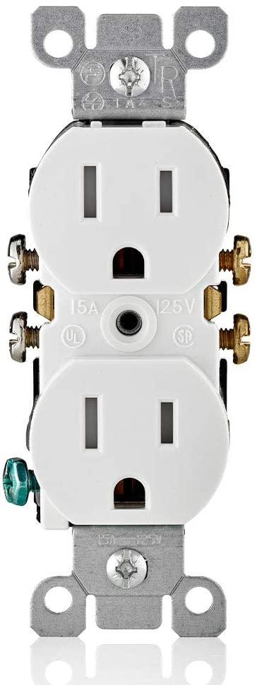

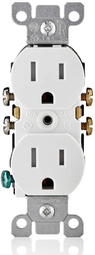

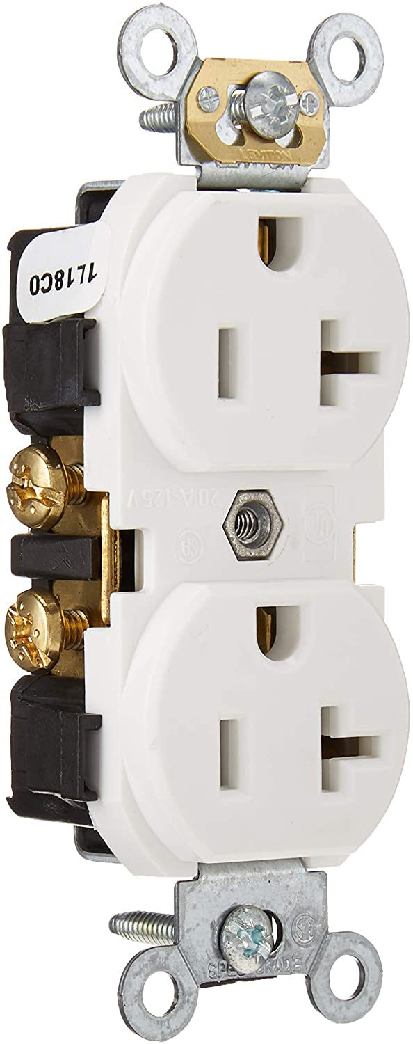

20A receptacles aren't supposed to be installed on 15A circuits. If something with a true 20A plug is connected, it could overload and overheat the circuit.
What's not clear?
15A outlet and 15A plug
20A outlet and 20A plug
20A plug doesn't work in a 15A circuit unless someone installs the second type of outlet (which isn't dedicated to 20A use)- it can't fit into a 15A outlet. The only reason the second outlet can accept a 15A plug is for convenience- code doesn't allow using a higher amperage device in a lower amperage outlet/circuit.
Points for using the inverted ?, though.
