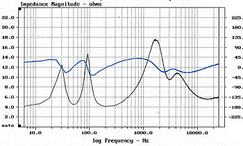

Thanks for the heads-up. I just looked that up, and Enjoy the Music looks like a lot more plausible impedance graph:
It looks like Stereo.de mistakenly shifted the curve down by 2 ohms, because I can't believe a major manufacturer would release a conventional bookshelf speaker with such an nasty impedance profile.
Right. It's virtually impossible to get that low an impedance on a 2-way even if the woofer starts out at 4 ohms, which is apparently the case for the Canton woof. You run into trouble in the 200 - 400 Hz range much more frequently on 3-ways, where you're crossing the woofer much lower.
