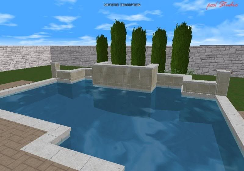

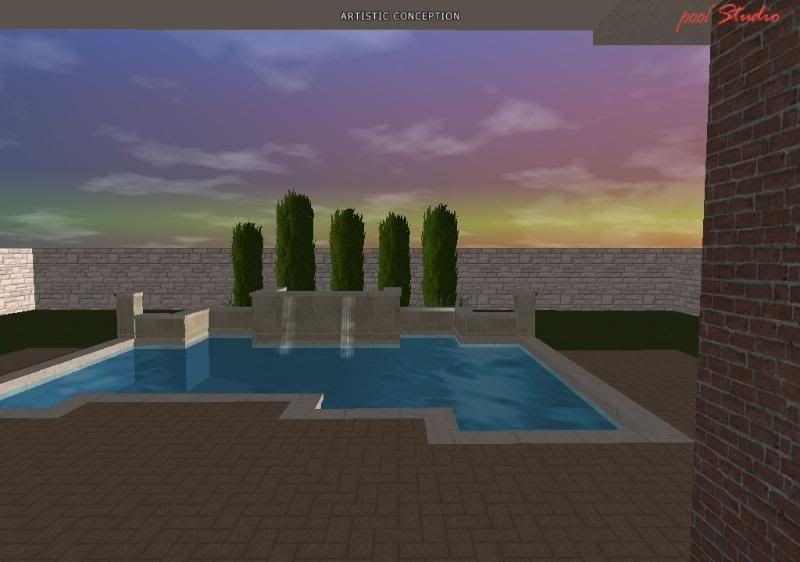

Well, I will sign a contract this week. I narrowed the 6 pool builders down to two and I am doing final negotiations with them today. It has been a lot more difficult then I predicted getting these guys down on price (I am usually good at getting a deal). I was thinking the economy would play in my favor but all the pool builders are doing great right now in this area. They are even being selective on who they will build for.
We decided not to go with the hot tub. Below is what I think is our final design.

Wow Greg that is going to be amazing. Guess I may have to visit Texas now.:D
Are you going to have the stone fence done as well? I have not seen full shots of your existing backyard but I didn't think you had that type of fence now.
What is the overall width of that just so I have some scale?

Very cool!
Make sure where the waterfalls are that they make a sharp lip. The waterfalls need a sharp lip (no leading edge) because otherwise the water tends to follow the stone and it makes the waterfall uneven. If the lip is sharp the water flows out smoothly and clean looking.
If you still want a hottub, I'd put a small one on that square area closest to me from the artists rendering... you could have it slightly raised and have the overflow flow into the pool. It creates a pretty cool effect.
Also, where are they putting the drains?
How are you going to light it (important!!!!)?
Also, bring the stone all the way around the pool. The grass will die in that area where the pool is next to the grass. Or do some pebbles/small stones with landscaping there, with some tough plants. Grass will die though.

Come on down.
I have that stone fence in the back, my side fences are wood and the HOA will not let me change them.
Not sure if you can see this attachment very well but it is roughly 32'x17'. Perimeter is ~110 ft and that and the materials is what has the cost up too high. We are using limestone coping, granite tile and stamped concrete decking.
