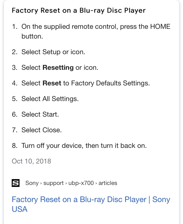

Pretty sure Fred is using the 4K disk, and I did ask if he selected the Atmos track. He said, yes he was able to do that. Even still, with a regular bd, it doesn’t show up as multichannel PCM. Waiting to see if a reset fixed it.
