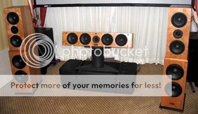

DM, do you know Paul Carmody?
Saw these DIY Tarkus speakers by Paul Carmody, and there is a little similarity, but a bunch of differences in comparing them to the PHIL 3's.
Dennis Murphy
There are probably several designs out there that look like the Phil's. There are only so many ways you can do a box on a box.
