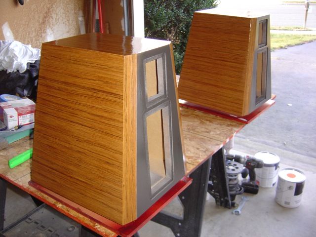

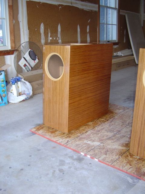

KEW
KEW

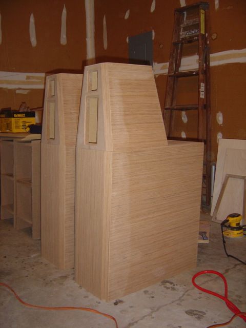

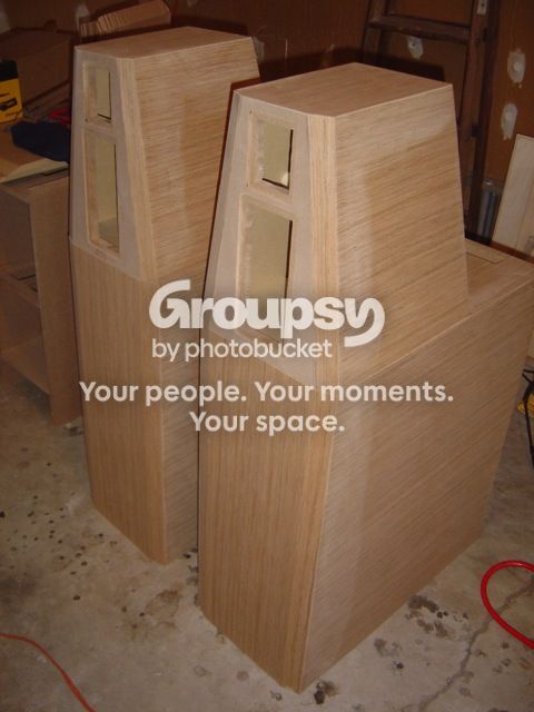

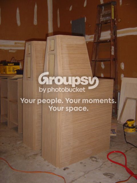

I'm starting to get excited!
Getting close!
The camouflage on the woofer worked out really well, can't wait to see the rest of the drivers installed!
I asked Del to orient the side grain horizontally!
Edit: Oh yeah, grain is reconstituted Teak.

KEW
KEW
Getting close!
Grain is reconstituted Teak.
Wow, these speakers are starting to look good now that they are all lacquered up... or maybe it's me being lacquered up... I lost track!
Del assured me the upper baffles are showing lighter than they actually are (they will be a charcoal brown) due to some trick of the camera and have yet to get another coat.
I decided against camouflage treatment over the woofers out of fear that I might accidentally stick a finger through it. I want it to be an act of deliberation if and when any digit penetrates these speakers.
