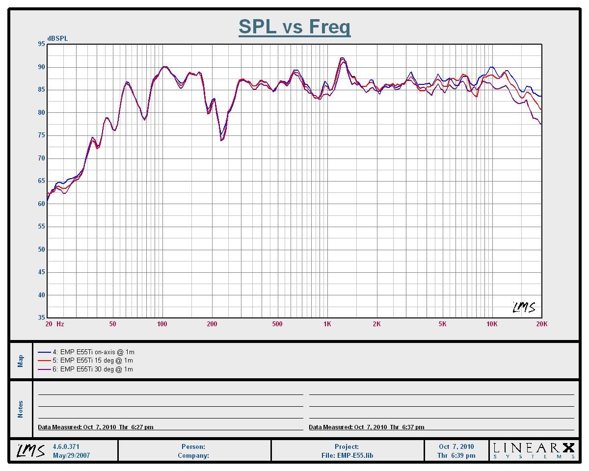

Dunno about anechoic chambers, but ignoring the floor bounce dip near 250hz, that speaker's response looks a little something like:
http://www.audioholics.com/reviews/speakers/floorstanding/emptek-e55ti/EMPFreq.JPG/image
when you take some measures to take the room out of the equation. The above is still an in room measurement though. :p
