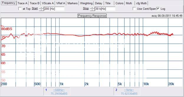

Philharmonic Audio Phil 3 - On Axis FR Plot
Like DM stated, major difference when you look at the Granualarity/Resolution on the Y-Axis for SPL, also a difference around 300-500 Hz. but very hard to determine with 10db Markers.
Also, the KEF's were measured it looks like with 85db as their Reference, and I do not know why, where the Philharmonic PH3 plot is right on at 75db Reference.
The Phil3's look flatter at around 800-1500 Hz. than the KEF's.
The KEF's go crazy at around 10kHz. up to 20kHz. -- a lot of movement up there, but can you hear it? I would think the PH3's being flatter up there is caused by the fine RAAL Ribbon Tweeter in the PH3's.
Actually, the KEFs just have an on axis null caused by the round coaxial waveguide. As soon as you shift off axis into a more typical listening window the dip flattens out for a smooth power response.

The KEF is referenced to a standard sensitivity input to show rated sensitivity at 1 meter. I didn't bother with that on mine--the dB absolute level really doesn't mean anything on my graph. The KEF's behavior above 10 kHz is probably due to the coaxial mounting of the tweeter--there are some reflections and cancellatioons within the midrange (woofer?) cone. It probably smooths out of axis. In any event, the KEF seems to measure very well, atlhough I don't really know the measurement conditions.

-- when you ran your FR plots, is the measurement mic also at 1 meter in distance away from the driver, and at what height, to align with the Planar mid-range driver, or the RAAL tweeter or ?
Also, isn't it true to state, that when the speaker is measured in the Anechoic chamber of which your plots are showing, and then one moves it to his room, things look totally different in FR plots with the room reflections, etc.?
In other words, isn't it true to state what looks nice and ruler-flat in the anechoic chamber is not what it looks like in ones room?
