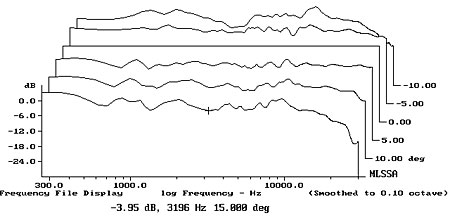

Well I'm sure the waveguide keeps the tweeter from ""flaring"" well-off-axis at the reflection points, but overall things like this are moreso a testament to the:
1) very high reflected to direct ratio of the salon 2. Because of this, regardless of whether you sit or stand, you tend to hear mostly the reflected sound power response, which is an average of all the reflected sound. In a super-audiophile padded-room, you may hear more direct sound and thus more change in sound when you stand up.
2) high order crossovers between acoustically small drivers with sufficiently tight driver spacing. Take a look at the vertical off axis of the salon 2:
Compare to a speaker that uses second order slopes, with a higher crossover point, the Genesis II.5 for example:
Finally, there's the simple fact that the tweeter on the salon 2 is really, really high up. So you're basically less off-axis when standing up :)

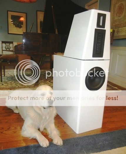

Until now my favorite was that white philharmonic on the website, (not including acudeftechguy's "cabinets cost me more than you paid alogether" candy apple reds.)
FWIW, I think the "white" speaker is Maple in an overexposed photo. My guess is the same speaker is in all three pics below (yeah, that is how obsessively I have been looking at these to pick out my color/finish!:D):
Not obsessively enough
White Phils
