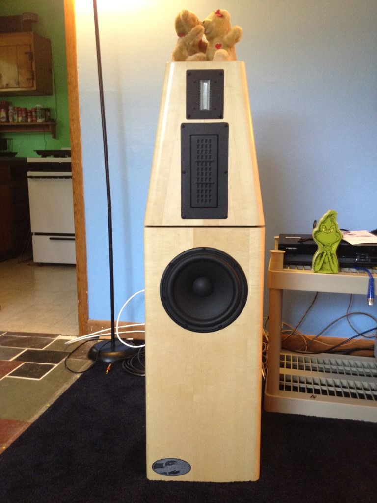

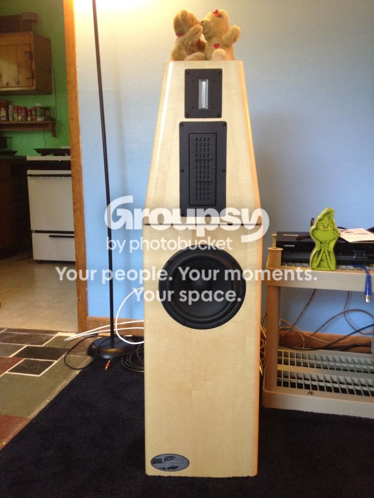

Nope, this pair is mine and yes those are little stuffed bears sitting on top. I use them as room treatment :p
Are those Maple with clear lacquer, or did you have him add stain?
I'm debating whether to stain mine slightly darker, but like the warmth of yours.
