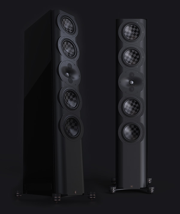

Darn it looks cool in black:

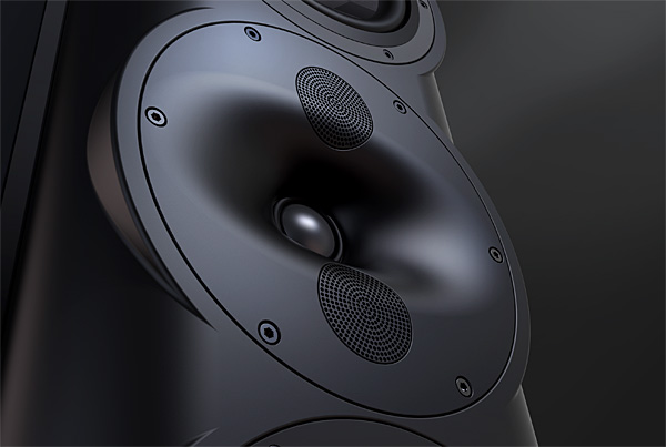

One thing that bugs me on these speakers is the relatively great horizontal distance between midranges and tweeter, I am surprised that this does not create audible issues :rolleyes:
Huh? The horizontal distance between midrange and tweeter? There is none.
Looks like midrange is flush with the front while tweeter obviously is in a waveguide, certainly looks like distance there
"Great horizontal difference" was your comment and it makes no sense. The midranges and tweeter are combined into the central driver. The only way to get them any closer would be to have a coaxial driver. There is no horizontal distance because the drivers are arranged vertically.
You say all these 3 drivers are in the same vertical plane
A quarter of a wavelength at 4.4KHz is 0.74 Inches if I am not incorrect, so I assume it´s more than a quarter of a wavelength offset....
If you are talking about the tweeter being recessed while the mid drivers are flush to the front surface, I see your point, but there was a lot of engineering that went into that design and it accounts for the extraordinary dispersion pattern that this speaker exhibits. Does this mean that you do not like any speaker that uses a wave guide for the tweeter because it will be recessed relative to the mid-range or mid-woofer? There are plenty of designs out there where the tweeter and mid-range are not in the exact same vertical plan but you need to examine the crossover design in combination with that.
The difference in depth is necessary for the beam-forming to occur. The midranges are set a bit behind those grille things anyway, so the depth that you think you see might be exaggerated. If there were phase issues caused by the distance difference, it would be manifest in the frequency response. You would see some significant comb-filtering in much of the shared bandwidth, but of course, we don't see any of that.
I suspect it time aligns very well, as high pass passive filters always advance phase, and therefore by extension time. The advance is a quarter cycle for every order of the crossover. Low pass filters do the opposite.
