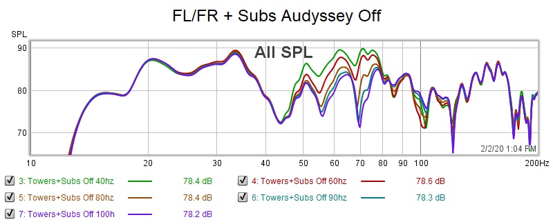

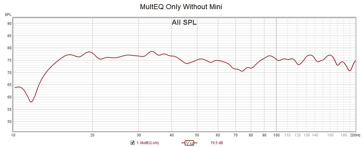

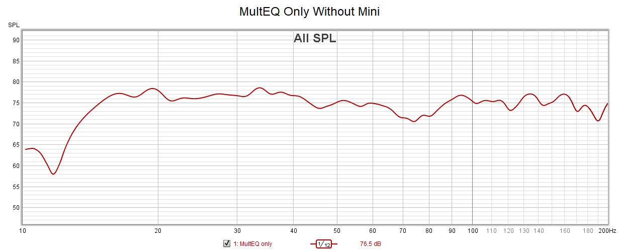

I just flat out disagree with you here doc. At least with bass frequencies. How can you say that room correction made things sound worse in my room?
Before:

After:
Tell me, which one of those would you prefer? How is that bogus? Can you show me where it made things worse? I don't see it, nor do I hear it. In fact I can tell you it sounds much better after rc. That is unquestionably a huge improvement.
And it's not because I have lousy speakers...

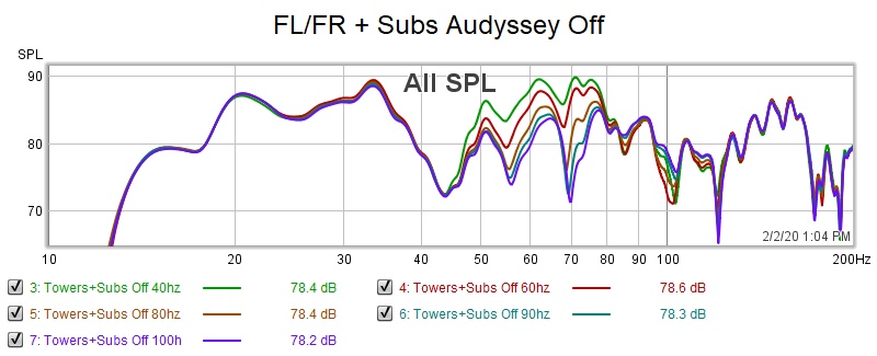

Before:
After:
