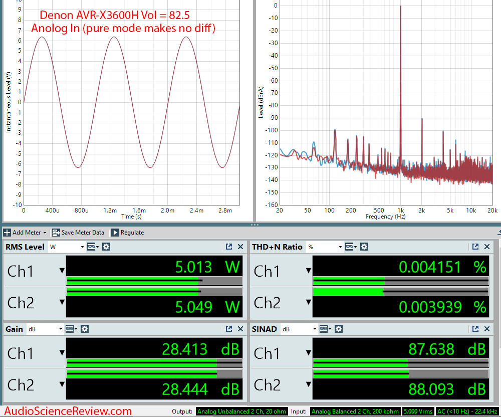

Now take a look of a lowly AVR measured by ASR:
It also has more 2nd harmonics, but a little lower than the JC-1, about -90 dB. Marantz's would have more 3rd harmonics than second, yet more people claimed they sounded "warm".
I hate to call it, but those are internet perpetuated myths, practically BS, not to be trusted as facts.
