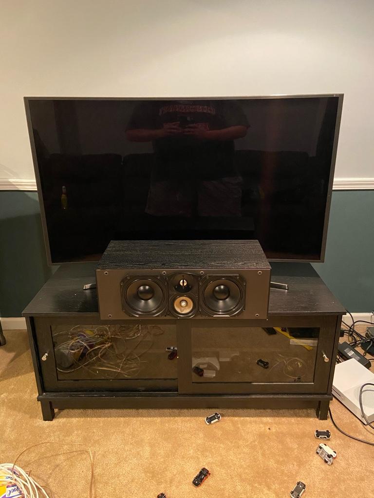

Picked up a Paradigm Studio Reference CC-570 v3
It’s huge! Now I need to mount my tv on the wall. Next up is the rear speakers, subs, receiver, and power amp.
