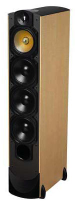

If you compare the impedance and phase angle graphs of the V2, and V3, and since the specs of the V4 look very similar to that of the V3, it would be reasonable to assume the V4 has similar impedance and phase angle measurements too.
Unfortunately that would mean the V4 is more like a 4 ohm speaker.
So it depends on your seating distance, spl you listen to, and how much headroom you wish to have on hand, you may or may not benefit from an external power amp assuming you are getting a new AVR that has multi-channel preamp outputs.
