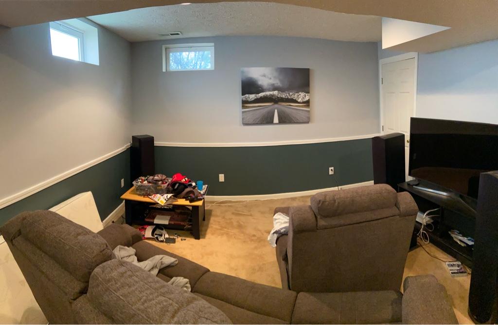

This is how it is right now. Previous owner of the house had their tv on this wall so I put mine there with zero thought on speakers as I had a soundbar.

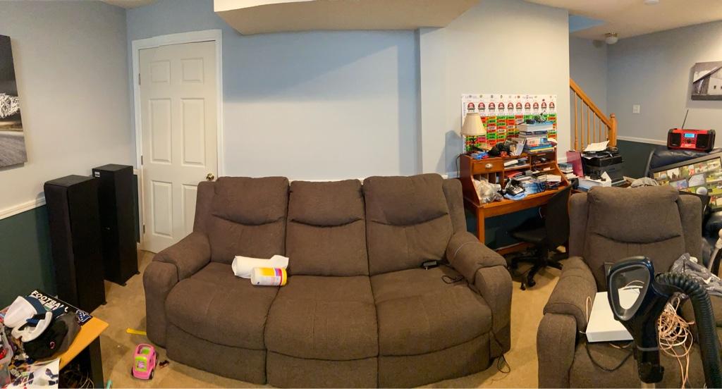

This is what I’m thinking now. Move everything so that the tv and speakers go on this wall which creates more space to spread the front left and right out. The finished part of my basement is pretty small so I don’t have much room to work with.

That door is still an issue it looks like.
How about the wall to the Left???

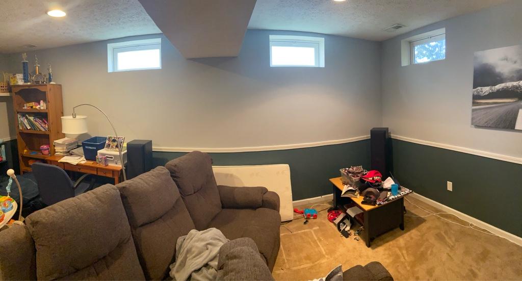

Here is the wall to the left. If I placed the TV there I would basically just be swapping the tv and couch. It would make the rear surround easier to place as well because there is a wall behind them. If I used the wall next to the door the rear surround would be sitting in the center of the room. And I’m sure my 1 and 7 year old would knock them over somehow.
Would the small windows have any effect on the sound? Or is the door a bigger deal than the windows.

The door In My Opinion is a bigger issue. The windows could always be covered with curtains as to not affect your TV viewing with glare

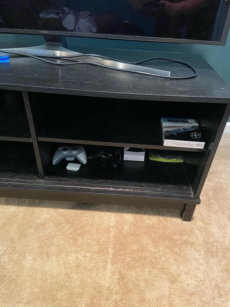

Can the center speaker go in one of these shelves? Or does it need to be on top to breath?

Center is Front Ported isn't it? If so it can go into one of the Shelfs (top shelf). Just pull the Face out past the Cabinet face.

I'd definitely go on the top of the cabinet at the front edge over sticking it in a cubby hole (not particularly about breathing, tho)....if large enough put the tv on top of it.

I would need to create a stand for the tv to sit up a little higher as the gap is only about 3 inches. I’m pretty sure the center is anywhere from 6-10 inches.

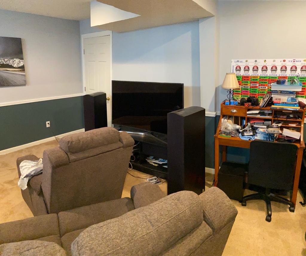

Disregard the mess, it’s a work in progress right now. So now the couch is on this wall. I don’t see enough space for rear surround towers? From the knowledge you guys have, what are my options for the rears? I would rather not move that desk that has all that crap on it but I’m going for best sound possible so anything can change.

What gap? The center is smaller than the splay of the tv's stand? A riser is easy enough to make or even buy....

A riser is what I meant. The center would be blocking the lower part of the tv.
