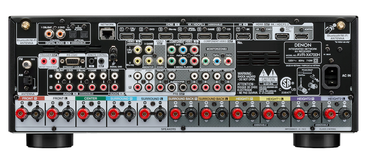

Another reason to have an external amp might be simply to reduce the heat of the Marantz 6013? I don't know if your unit runs warm, but moving my fronts, center and surrounds to an Adcom 5 channel ext. amp allowed me to use ECO mode on the Denon 4700 which drastically reduced heat.
I bought the Aircom T10. That was a bust. At every fan level I could hear it running. If I'm going to put a fan on the receiver it can't add noise to the room. Why pay thousands on audio gear only to add fan noise? Off loading speakers from the receiver and using ECO mode gives me much better cooling without fan noise.
Have you guys found any fans that are dead silent and do a good job?
Even an avr with pre-outs with external amps in use can still keep voltage running through the avr's amp section and create heat (and some extra noise/distortion in the measurements of the pre-outs at certain output voltages). Some of the latest avrs from Denon/Marantz have the ability to turn off the avrs amps when using external amps, at least in certain channels, and reduce noise accordingly; whether its an audible issue....not all that likely.
V
VMPS-TIII
If you leave the Denon in ECO ON mode, it reduces the watts available by 50% or more. In ECO mode the top chassis of the Denon 4700 is mildly warm to the touch. It's a huge difference from the very hot chassis when ECO AUTO or OFF modes are enabled.
By off loading the fronts, center and surrounds to external amp and simply leaving the highs on the receiver, I can keep the receiver much cooler and not be impacted by lower power. I would love for the Denon receiver to be built like a quality amp that can handle heat with advanced quiet cooling built in... but that's not the case.
You can use pre-out mode in amp assign on Denon 2020 recievers. When you do that ECO modes are turned off as well as all the internal amps. You lose control over Zone 2/3 and some other amp assign functions with this mode. But in theory distortion will be less as the amps are turned off and heat is obviously under control.
It's still a quality amp, just not one with the on board cooling you would like :) How do you lose control over zone 2/3 particularly when using external amps? BTW Audyssey and amp assign (from a different post you made earlier) are not particularly related, except as how Denon implemented Audyssey as to what amp channels are affected (main zone only afaik in existing units). Heat can be resolved through external cooling easily enough....for a reasonable cost....I agree with you it would make a some folk happier to just incorporate it on-board the avr via larger boxes/internal heat sink/cooling solutions....the extra cost that would come along with that for those that who don't particularly need it, tho, maybe not.
V
VMPS-TIII
Denon sent me an email that states when pre-outs are used, "amp assign" configurations are nonfunctional. What does that mean? It means if you use pre-outs with Height 2, the receiver will only configure the pre-outs as Height 2.
You might think that makes sense, if you don't understand that Height 2 terminals are also used for "Front B" and "Zone 2 or 3" configurations in amp assign.
While you can use pre-outs either by themselves or with the pre-out amp assign config., you will lose some of the special options in amp assign.
Gotcha. 'I'd taken a brief look at the rear panel for shared zone 2/3 preouts and didn't see that so I'd say amp assign configurations simply determine what your processing/output options are, not that the pre-outs particularly make amp assign configurations non functional, just limited. Then again you could hook up zone 2 and 3 with pre-outs and simply change amp assign if you want to use zone 2/3 and limit processing in main zone if using them simultaneously....
V
VMPS-TIII
Actually, this is incorrect. When using pre-outs NONE of the channels are assignable for Zone 2/3. The only full-band channels are fronts. The only way to get around this would be:
1. Use Multi-channel sound mode
or
2. Use RCA "Y" adapters off the front pre-outs to the Zones2 or 3 ext amp.
Amp assign only supports Zone 2/3 when speakers are connected directly to the appropriate Denon speaker terminal. If you look at the back of the 4700 you will see none of the speaker terminals are labeled for Zone 2/3. When you use pre-outs you only get the function labeled on the terminal. None of the channels are assignable with pre-out use.
This wasn't obvious to me when I read the manual. But when I tested it and reported the issue to Denon, their level II tech support response was:
"This is normal behavior. You cannot reassign preouts to serve a different purpose other than what they're labeled. Height 2 preout will always = Height 2, regardless of Amp Assign's settings."
or
This wasn't obvious to me when I read the manual. But when I tested it and reported the issue to Denon level II tech support their response was: "
That makes little sense, that if you change amp assign to one that enables zone 2 or 3 that you couldn't use those pre-outs. You have zone use going now? I see that they're not shared with speaker terminals, that' fairly common. On my 4520 I believe zone 4 takes up one of the surround pre-outs but never needed to go there as I don't use zones with that avr. You just would get 5.1 or 7.1 depending....
V
VMPS-TIII
I agree it's not logical. I thought it was a bug when I reported it. Apparently, the pre-outs are on a different circuit that excludes the ability to assign the Height channels to other functions.
The height channels wouldn't be available in the main zone so it wouldn't matter. Or is there a condition of use I'm missing about using internal amp for zone?
PS Okay now I think I'm up too late....I'm indeed missing something and will need a reread and research so g'nite folks...
