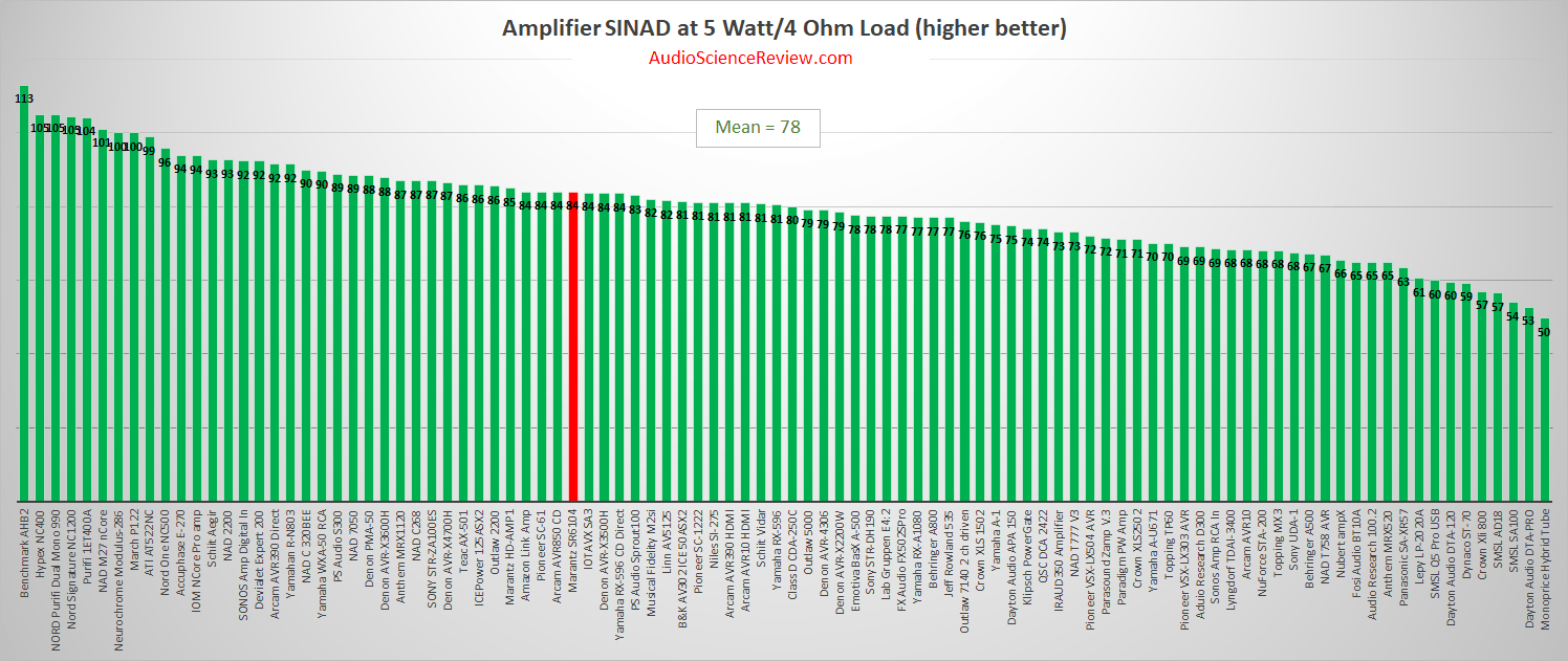

Here's ASR's THD+N ranking at 5 W output. In my 12X20' room my amp's average output is below 1 W with peaks to 20 to 30 W most of time when watching BR movies.
Note that the Marantz left two Outlaw amps, one Emo and several Crown Audio power amps in the dust, but slightly behind the monoblock M2200.
Also one other point that is interesting for me in this chart is that I have a Marantz 6013 which scores well and my main AVR is a Sony STRZA-3100ES and I note the version just below that, the 2100ES measures even ahead of the Marantz and ahead of many of the AMPs on the list.
@PENG - Have you found these SINAD testing results translate into audible sound differences? If you take the Benchmark AHB2 and compare it against the Outlaw 5000 will you be able to easily recognize the difference? That would be a 113 measurement against 79 or a 34 point difference.
