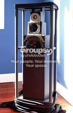

.....STRONGBADF, I just got my Daughter a used pair of Vandersteen 2CI'S, really good speakers, great low-end....the 8 inch woofer on the front, and the 10 inch "active" radiator on the back, share the same air-space, with the 10 inch element wired out-of-phase, would have to be....their claim is the 10 inch is "mechanically coupled" to the 8 inch woofer....whether the 10 inch woofer on the back is powered or not, I'm not sure....I would have to remove the all-encompassing grill cloth to check, so I won't....here's shot of what's inside the Vandersteen 2CI's.....
