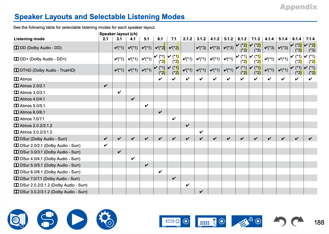

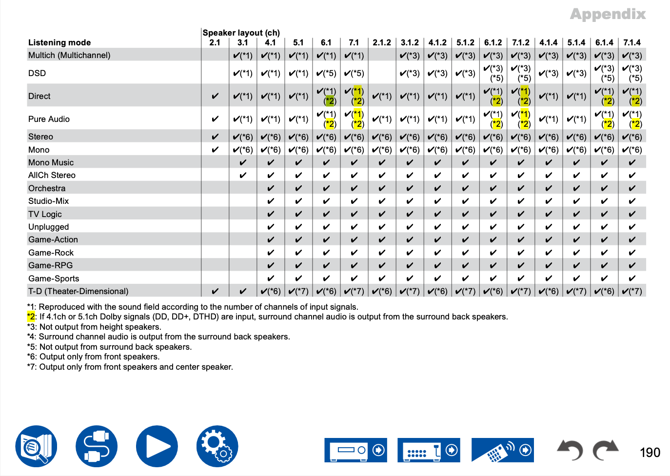

It is a characteristic of all current Onkyo models and my 6050 does it as well.
Onkyo TX-RZ70:
OK I see what you are saying, you can still run the Atmos / DSur modes and it will fill in the missing channels but when compared to the Denon the native 5 channel mixes would favor the surround channels whereas Onkyo favors the surround back's.
I always end up using the up mixed modes to make sure all channels are always used so that was my original concern.
I will be comparing the RZ-70 to my existing 3800h which I did purchase the full multiEQ add-on for.
Trebdp83
Some do not like up mixing DD 5.1 signals and want them played from the corresponding speakers. Onkyos here will reassign the surround channel info to the surround back speakers when playing DD 5.1 signals. A work around is to decode the DD 5.1 signal at the source, if possible, and send a multichannel PCM signal to the receiver. It will play the multichannel PCM signal accordingly in MULTI CH PCM mode.
This behavior also applies to IMAX DTS 5.1, though it will be a rare occurrence for sure.

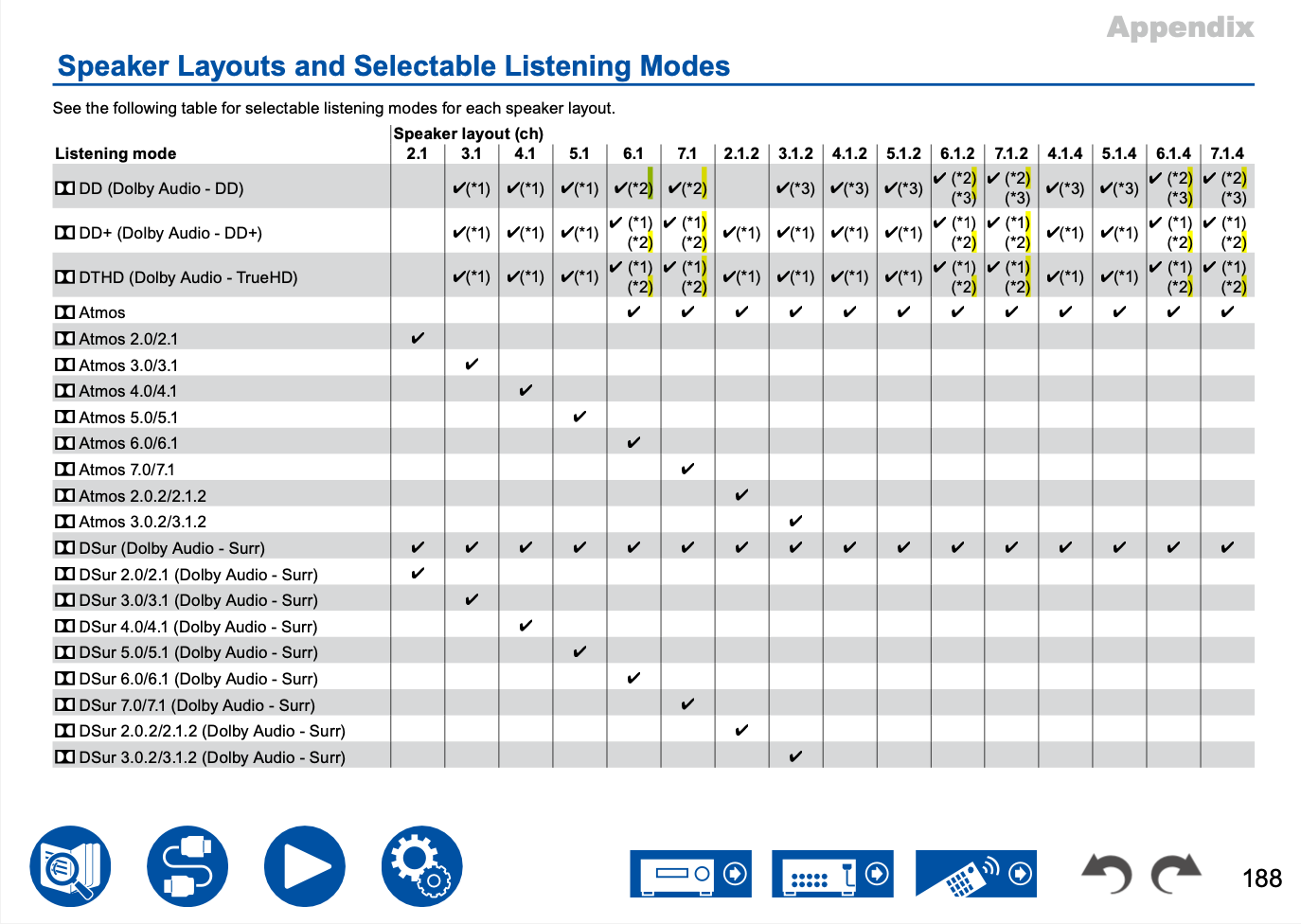

We’ll see if the surround channel info of DD 5.1 tracks is rerouted to the surround back channels in the RZ90 like it is in ALL of the other Integra, Onkyo and Pioneer 7.1 or more channel models using a straight decode.
It is silly that the flagships do not offer DTS Virtual:X when it is available even on the little five channel Onkyo TX-SR3100. The Denon/Marantz flagships have it all over other makes concerning features. But, they do come at considerable cost.

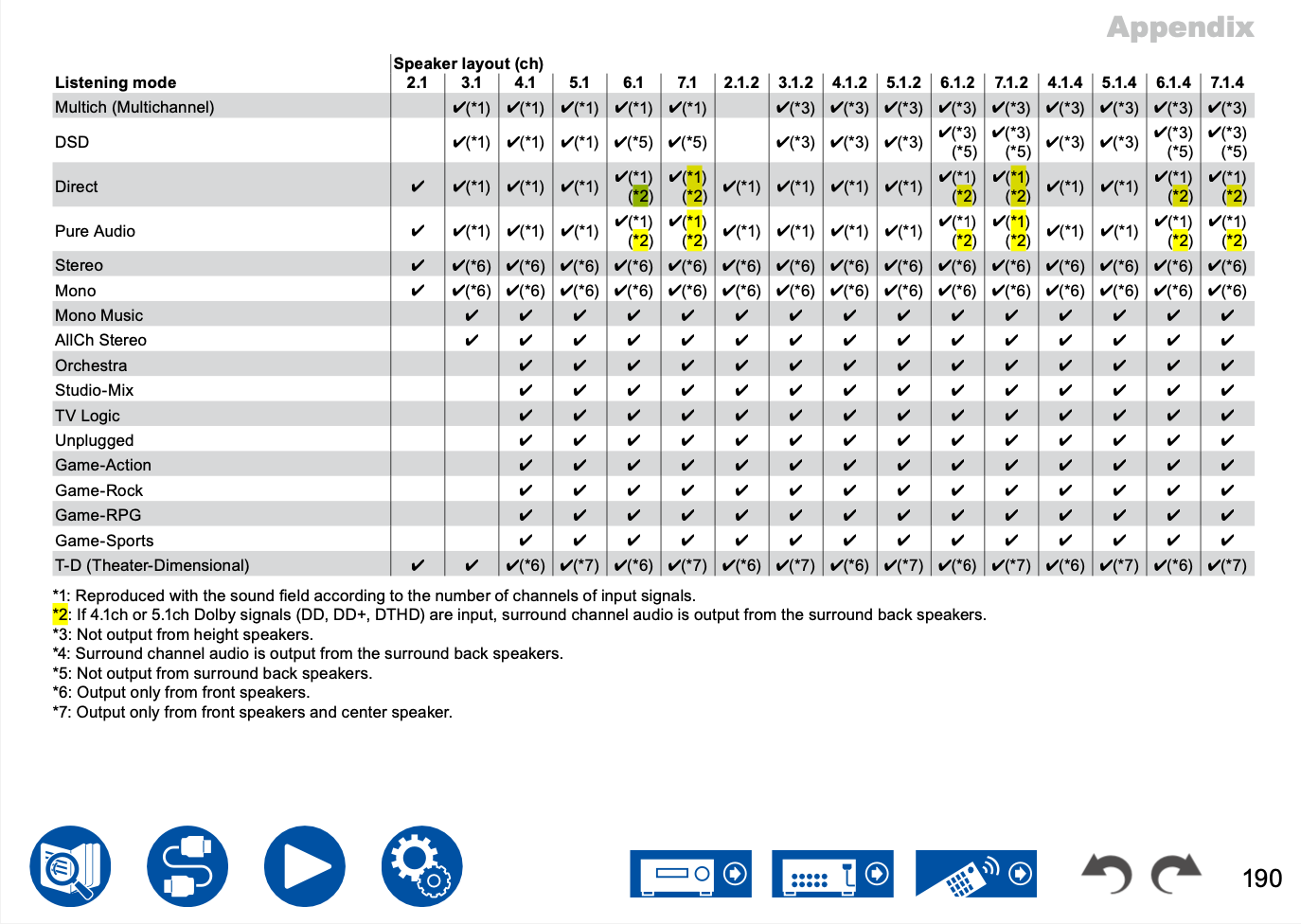

Oh, I have actually used AccuEQ in my Onkyos and YPAO in my Yamaha and that is why I currently do not use them.;)
@Trebdp83 what I find amusing is that the latest entry-level Pioneer & Onkyo AVRs that support DTS Virtual:X can be utilised with Dolby signals whilst D+M models still prohibit this behaviour, when they first implemented DTS Virtual:X back in 2017 along with being the first to do so, they made sure to be one step ahead & enforce the forthcoming Dolby upmixing codec restrictions with DTS signals & it has been like this ever since despite the Dolby restrictions being rescinded, it's pretty laughable that the Pioneer/Onkyo models allow this just fine but 7 years later D+M engineers refuse to remove this restriction :(
Trebdp83
The Denon/Marantz Dolby cross up mixing restriction is annoying for sure, but so is the Integra/Onkyo/Pioneer DD 5.1 surround channel info reroute to surround back speakers.
It is as though there are different Dolby license packages out there and each one of them comes with its own peculiar behavior.
Denon/Marantz at least include DTS Virtual:X all the way up the line but Dolby signals will need to be decoded and output as multichannel PCM at the source if at all possible to do so. Yet, it works with DSD signals.o_O
Yes you are correct, that DD 5.1 bug is absolutely egregious, the Pioneer/Onkyo/Integra AVRs shouldn't be exhibiting such behaviour, I wonder what their reasoning is for this, has it been a long standing issue with Pioneer/Onkyo/Integra AVRs?
In regards to D+M AVR's DTS Virtual:X implementation, yes they allow PCM signals too, so simply transcoding the Dolby signal to PCM will allow DTS Virtual:X to be engaged but the virtualizer restriction really ought to be removed by now, I brought it to D+M's attention a while back & they said it was simply too much effort for very little gain for the consumer :(
