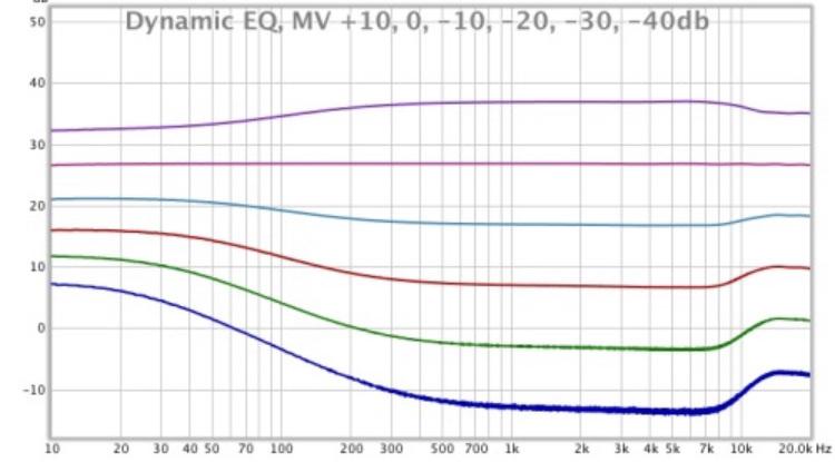

Here's the explanation for Dynamic EQ and Reference Level Offset and the settings https://audyssey.zendesk.com/hc/en-us/articles/212347383-Dynamic-EQ-and-Reference-Level
I'd leave it at -11.5....that's what I aim at for subs, too.

The RLO just changes the MV level at which deq kicks in, and you can see how raising the MV towards-0 lessens it’s effect.
As for sub trim at 11.5. I think that’s fine. That means you could raise it up to -7 or -8.(this would be common) The problem some subs have is when the trim is too low, the auto on function can be sketchy. Also, I’ve seen that being that low may not allow the subs amps to operate at full potential. It’s a gain structure thing, and I’ve never tested the theory. Only parroting what I’ve seen.
