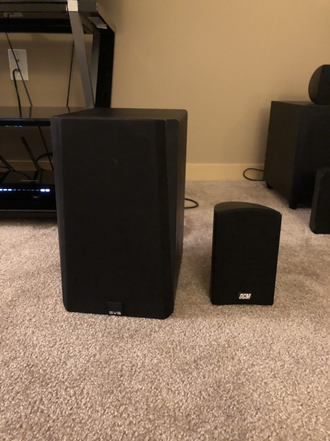

you got yourself a cure little pair of satellite speakers, there. ;)

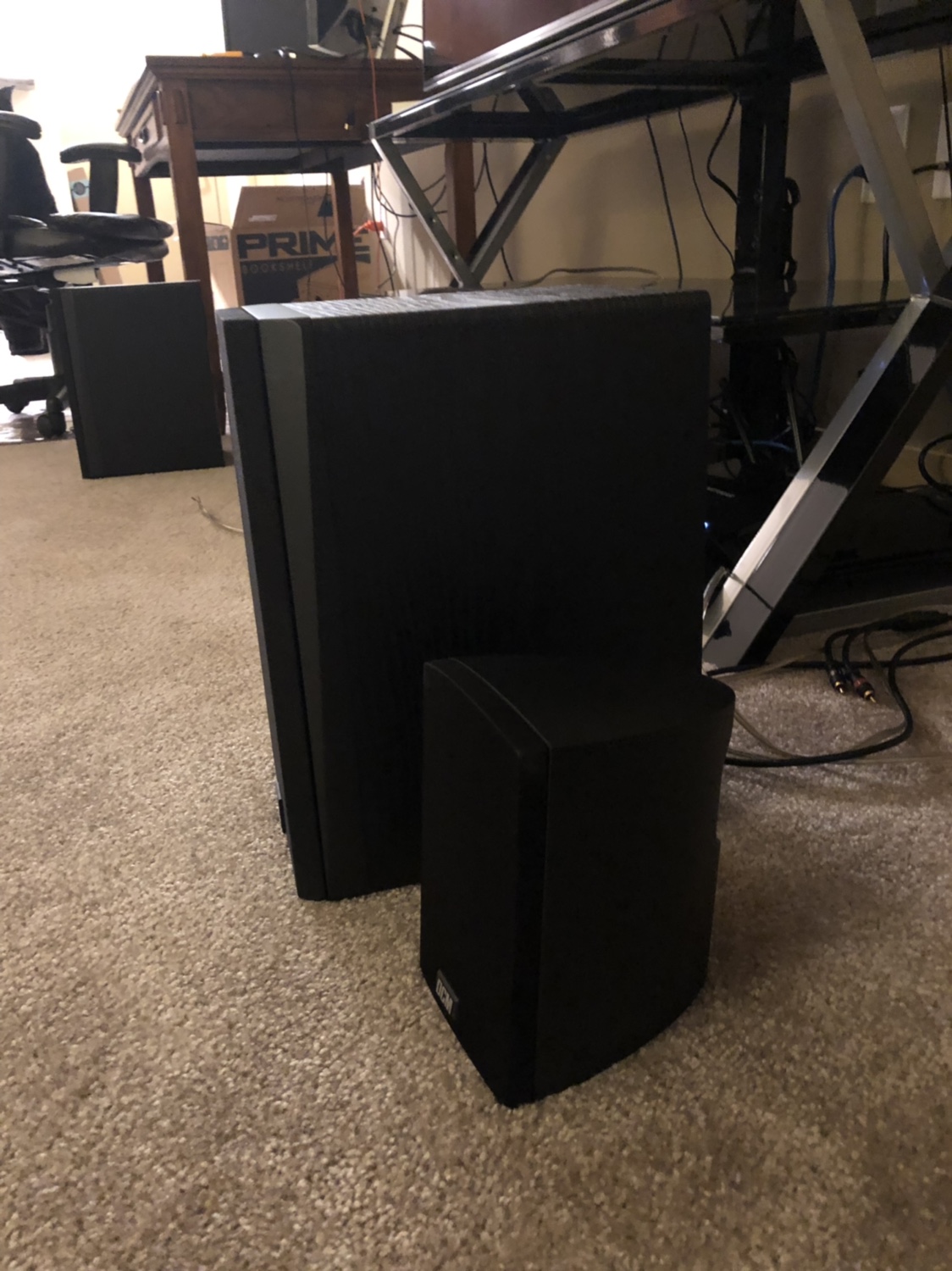

I see the prime box in the background, so thats the bookshelf? What about your sub? get that too?
U
UWbadger91

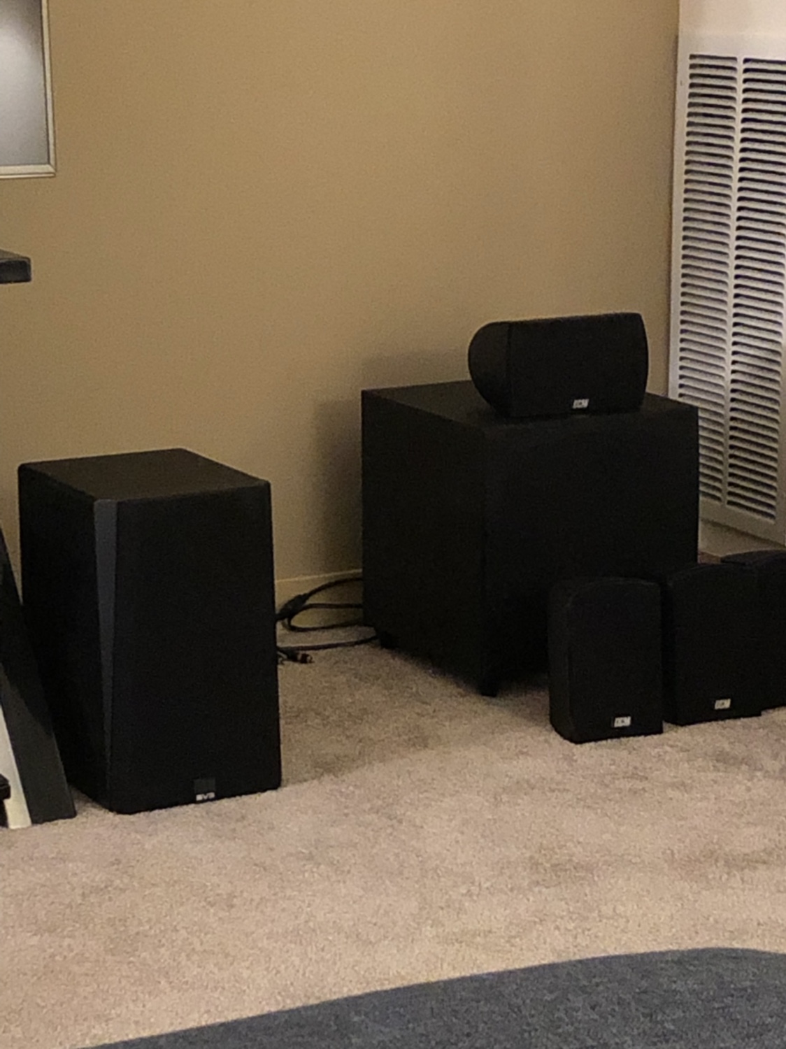

Prime speakers. That’s my old DCM sub. PB12 and center will be here tomorrow.
